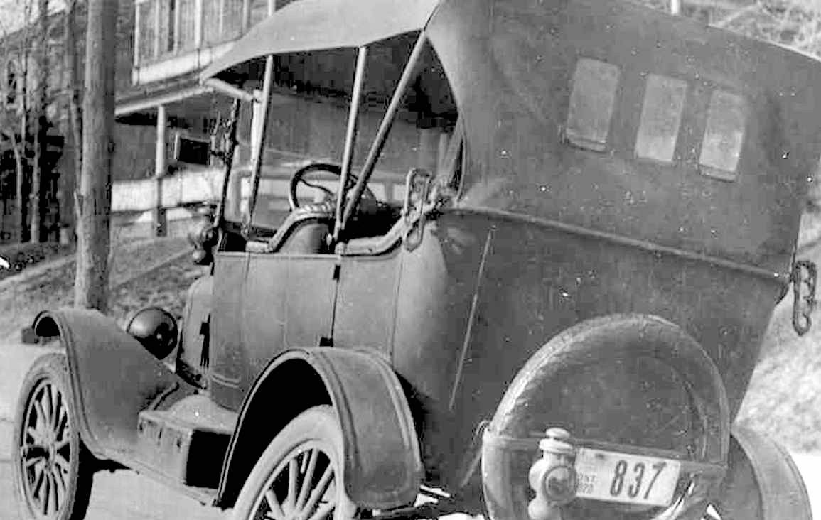

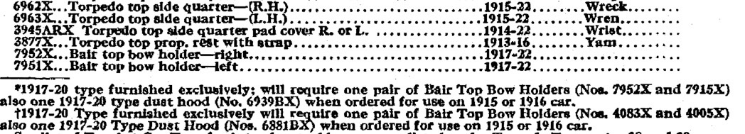

Canadian T's had the clamps as factory, but USA didn't.
The USA clamps are aftermarket, in fact, the Canadian is an aftermarket item, that the factory obtained and used as std. equipment.
Ontario plate, Canadian T with Bair brand clamp.
Canadian Price list showing the 'Bair' clamps.

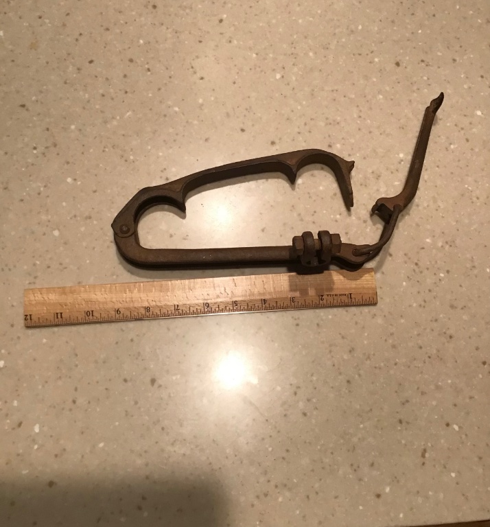

Thanks for the replies! Here is a pic of the one that I have in open position. Looking at T open cars in the old photos that get posted on the forum it seems about half had them and the rest didn’t. The restored T’s are about the same way. As stated the 21 Touring I restored had them on it.
I’m going to list the one I have in the classifieds and maybe someone has another one to make a set for their car.
