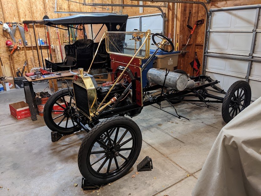

I have spent the past couple of weeks putting together the pieces of our restored 1911 T touring car. This is the second frame up restoration that I've done, and I have to admit it is a lot more fun putting together clean, painted parts than taking apart a grimy old parts!
Anyway, last week it was time to install the engine. Like the first project, I followed the black bible and got it on all four wheels before installing the engine. One of my sons who helped the last time came over to help me again. Even with two people, getting the U joint and engine in the right spot for it to go together can be a bit of a challenge. After that was done, I put gear oil in the rear axle and found that someone, who shall remain nameless, didn't seal up the two housing halves and consequently started getting drips from it.
The next day I pulled the rear axle to address the leak issue and once finished, it was time to put the rear axle back on. I did this by myself and could not believe how much easier it was to install the rear axle into the back end of the installed engine instead of installing the engine onto a rear axle already installed. I realize that it is often the case where only the engine needs to come out of the car, but if both the rear axle and engine are out of your T, save yourself some time and aggravation and install the engine first!

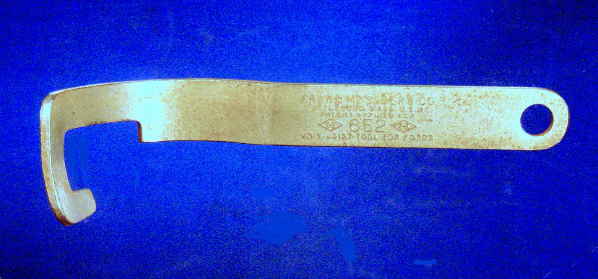

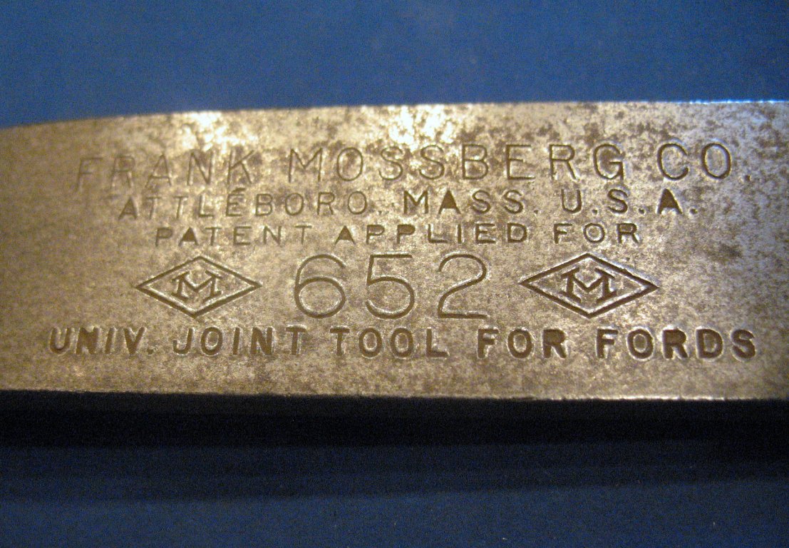

I've done it both ways, and both ways it's crap shoot. Sometimes it's an exasperating struggle, and sometimes the U-joint slides in slicker'n snot on the first try. There's a special tool that helps.
