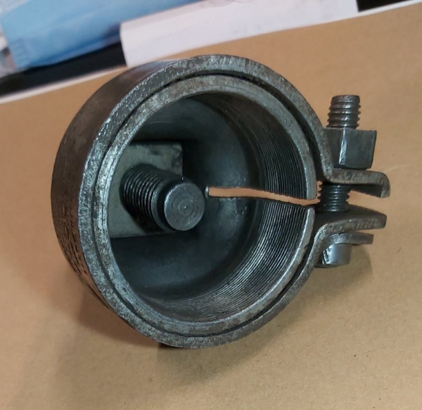

There are pullers and there at good pullers. A good puller has good threads and a pinch bolt to lock the puller on the thread. Those fine threads will not take much load if you rely on the thread only. It is easy to strip out the thread under heavy load.
Rich's puller relies on just the thread, but it is formed in steel. Most pullers are castings, and these do not perform as well. Perhaps the best one I have found is a Mosberg aftermarket item made of steel, and having a pinch bolt.

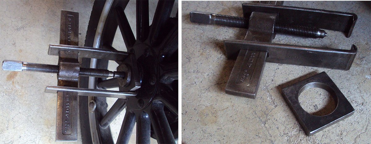

This is the type I use. Well worth the price. https://www.modeltford.com/item/2800WP.aspx
1926 Tudor
- Posts: 5592
Re: Rear Hub Puller for Roadster
That's a direct copy of the Ford puller - pretty tough to beat ! I have to agree with Allan regarding the pinch bolt - I've seen good pullers have their threads and/or the Ford hub threads ruined.

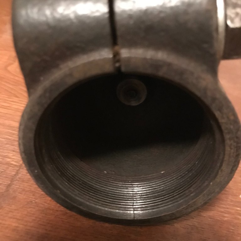

As pointed out, the Ford type pullers work well. Unfortunately, they can be cracked as shown in the picture if
the pinch bolt is overtightened. That's why I like Rich Eagle's use of a flat thick steel plate to make one.
And, with a slot and a pinch bolt added to it, that steel plate would pull even the toughest hub with no
damage. The ultimate wheel puller.

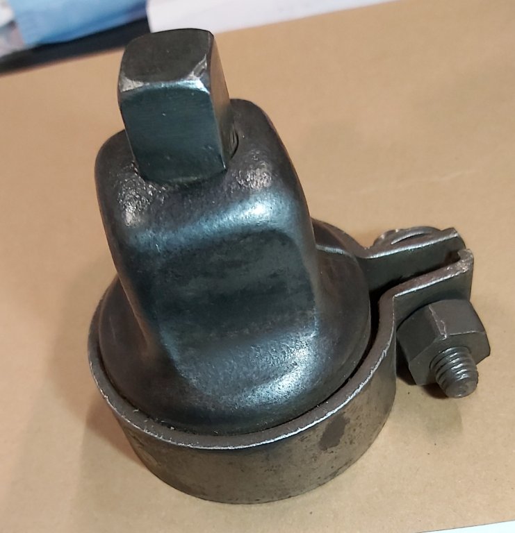

This is perhaps the best one I have had. It's a Mosberg tool no 660. It is all steel so the thread is robust. There is no chance of it cracking. The pinch bolt/ ring has built in measures against over tightening.
Best of all, the large square not captive in the housing, is actually free within, to move in and out with the driving bolt. This means that once the drive bolt is put under tension, a smart whack with a heavy hammer will allow it to shock the axle independently of the puller body. This is how the Ford pullers for wire wheel hubs workd.

Allan, that puller is one well designed tool!
Interesting to see it.
