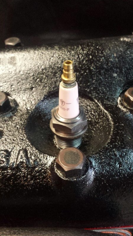

Has anyone ever figured out why HF would design his engine with a funnel so every time the sparkplug is removed dirt goes down into the cylinder. Now come on Farmers didn't have compressed air

The obvious answer is to get the plug closer to the combustion chamber. It collects water if the hood hinge has worn and lets the threads rust. I suppose you could leave the plugs a bit loose to blow it clean. It is aesthetically more pleasing than a flat surface to my eyes. FWIW

Yes it is to get the plug closer to the combustion chamber and also to allow a larger water jacket above the cylinder. Rags are easy to come by and almost everyone had a tire pump, so not so hard to clean up and anything small enough to miss a rag or tire pump air, would go right out the exhaust anyway.

FWIW, most "L" heads are like that. I've never noted a worrisome amount of "stuff" in plug wells. If they fill with water usually the plugs short out and you stall.

I wonder how the engineers got around this on the Model A head? No recess or well around the plugs there.
- Posts: 4412
Re: The dirt funnel
Also for what it is worth. The Metz which used a motor so similar in some details as to be able to use Ford T model parts for repairs, does not have that funnel top. The spark plugs for them are about an inch and a half longer on the bottom end. I wouldn't mind getting a few more of them if someone has some and been wondering "What the (??) are THESE for?" I do have a Metz project pile I may never get around to restoring, and am short good plugs for it.
The worst thing about that "funnel" on a T model's head is that if left sitting outside for a year or ten, water collects in those dips. If the threads are all very good, and the plugs tight, it may be okay. However, I have opened up a few engines that had sat for years, and found one of the cylinders didn't seal well enough around the threads of the plug, leaving three cylinders in good condition, with the other one nasty inside.

Temperature extremes will put water in the funnel too. Cold engine-warmer environment. Seen this many times here. Part of the reason I kicked 2 T's out of the cozy little shop. Darned ice in the funnels.
If the threads aren't perfect, the water runs down like the dirt.

When working around an engine with plug or plugs out I like to screw 1/2 inch pipe nipple(s) in the plug hole. Mine are 4 inches long. Otherwise anything you drop that will fit will find a way to go right down the funnel hole.
