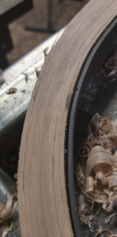

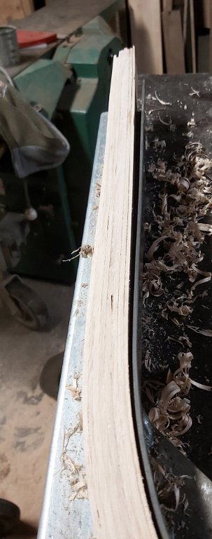

This is the first laminated bow off the new jig
There are 8 x 2.5mm laminated all up. These were added in two lots of three and a final pair.
The bends are tight. There is just 3/8" flex away from the form, on one side only. Curious!
Since these were taken, I have used a 3/8" rounding bit to rout the edges of the bow. This liberated a small breakout on one side of one corner. It is under glue and clamping instill O can finish it off.

I wouldn't think the slight distance the wood sprang away from the form would be a problem. It might be because of uneven glue curing or just natural tension in the wood. Clamping the bow back in the form and applying some heat would probably eliminate it, if necessary. I wonder if the original bows were formed to their exact final shape before installation, or if they had some slight "spring" in them prior to installation. A little tension within the bow and socket assembley once installed might help prevent any rattles at the pivot points.

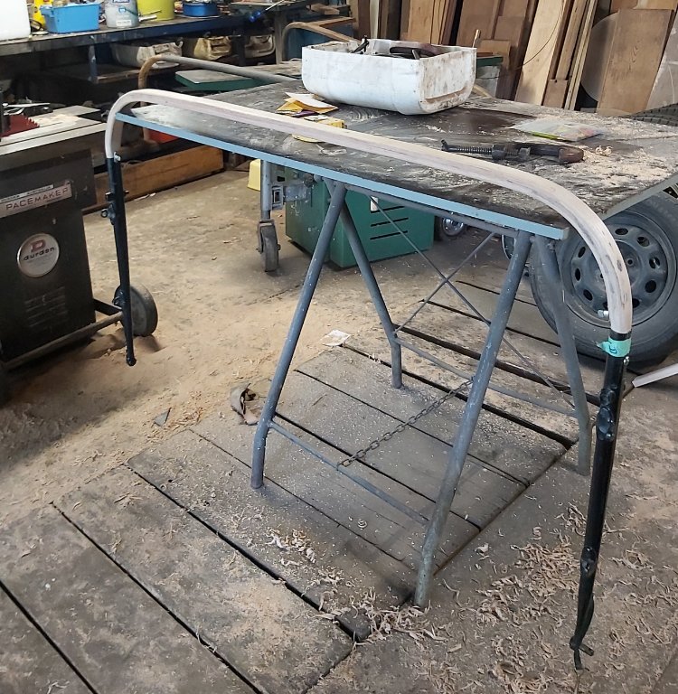

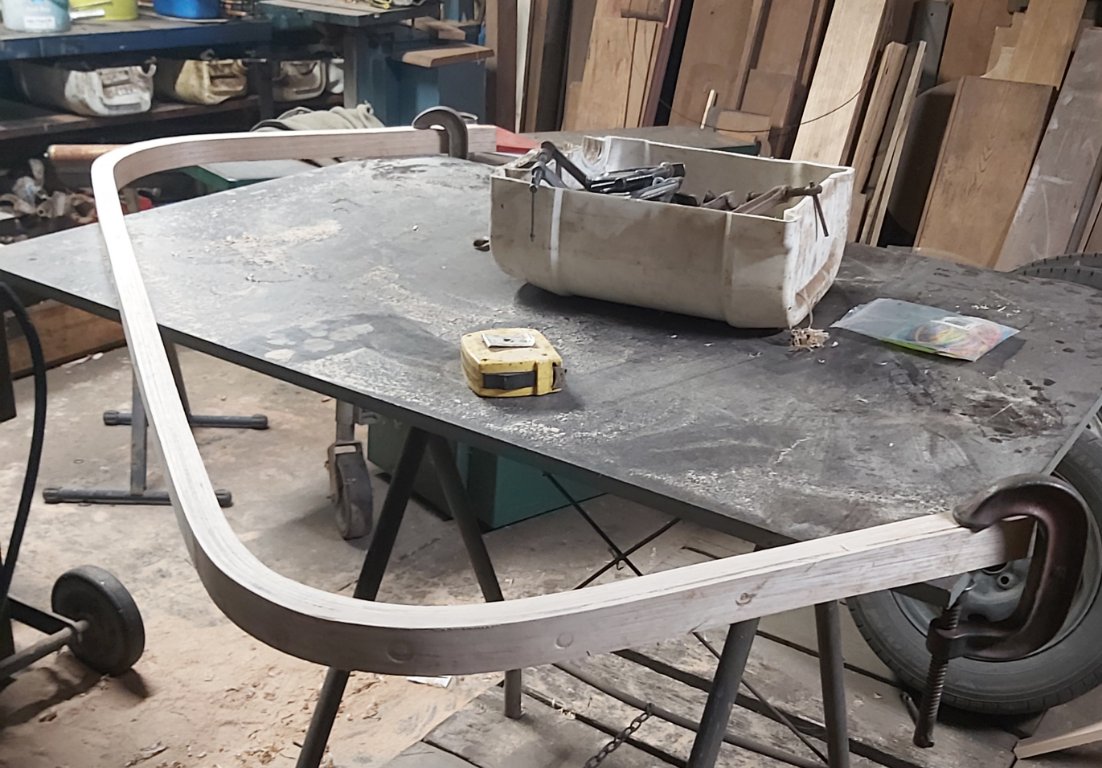

The finished product. The longest single operation was shaping the tapered ends to go into the sockets. Perhaps I was too fussy about the fit
- Posts: 8093
Re: New tool output.
A perfect fit would not cause problems,whereas a poor fit probably would. A slight crown across the middle section of the bows, once installed, might be a good thing. It would prevent any tendency of the bows to sag in the middle and prevent any puddling of rainwater. Some "spring" in the assembled bows would help keep everything tight and rattle free.
