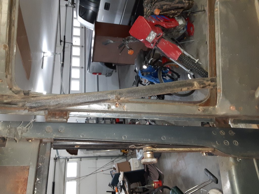

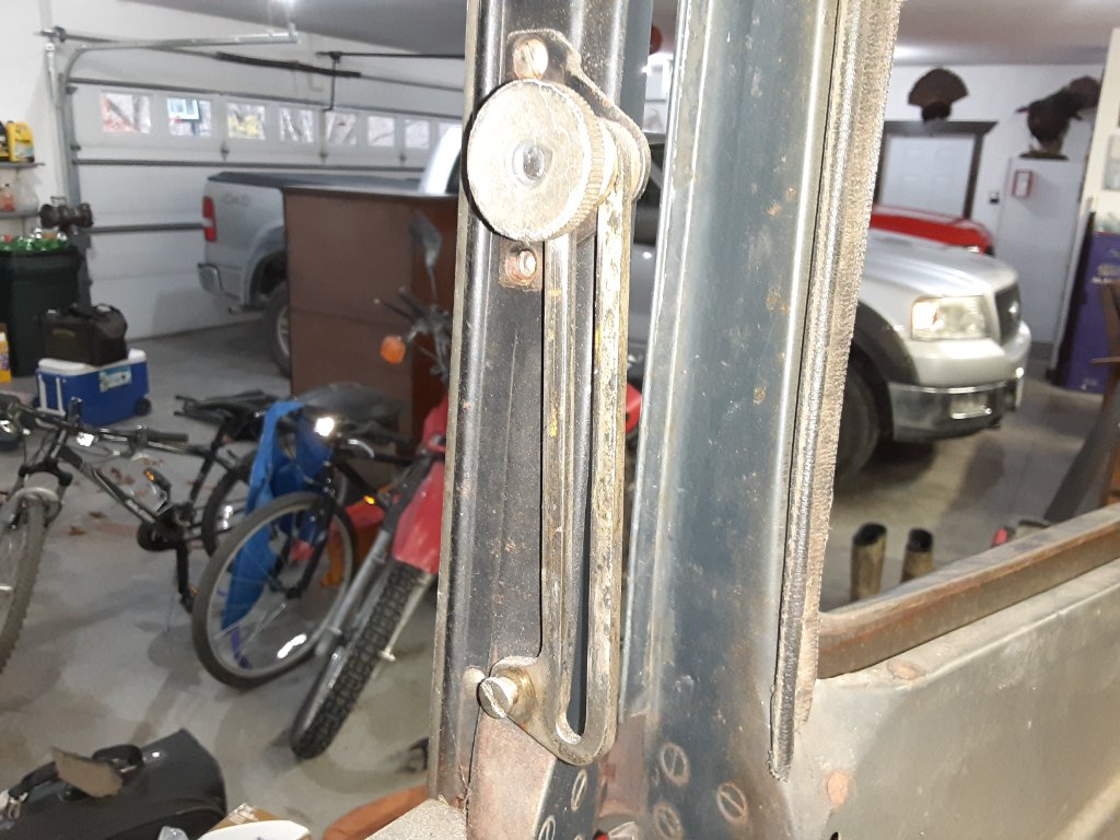

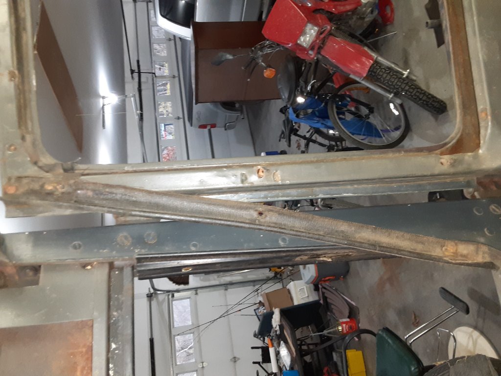

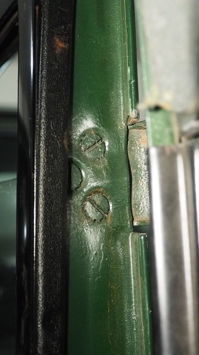

I am have installed the windlace on the" body frame" next to the rear of the door and now getting ready to install the front windlace. It is my understanding that the front windlace also is supposed to be attached to the "body frame" and not on the "door".
Here is my dilemma! It appears that the original front windlace was installed on the door on my coupe. I don't specifically remember it being there, but I have three pictures which sure seem to show it on the door.
I have looked carefully at the front door frame and do not see how it could have been attached there. There are no holes that would indicate it was installed there.
I sure would appreciate 1927 coupe owners sharing with me where it is installed on their cars. Photos would be helpful.
Sorry for the sideway photos. It would not allow me to have them in the correct position!
jiminbartow
- Posts: 2480
- Last Name: Patrick
- Location: Bartow, FL
Re: Windlace on !927 Coupe
Better? Jim Patrick
Jim, Thanks for repositioning the photo. Could you also do the other one? Where can I find out how to do that so I don't post any more that way?
jiminbartow
- Posts: 2480
I send the picture to my Apple IPad photos, edit it (that is, rotate it), then re-post it. Jim Patrick
pron022020
- Posts: 147
- Joined: Thu Dec 23, 2021 1:43 pm
- First Name: Tyler
- Last Name: Prondzinski
- Location: Spring Grove, Illinois
There are several spiral nails or tacks that push into the holes and then the molding slides over top.

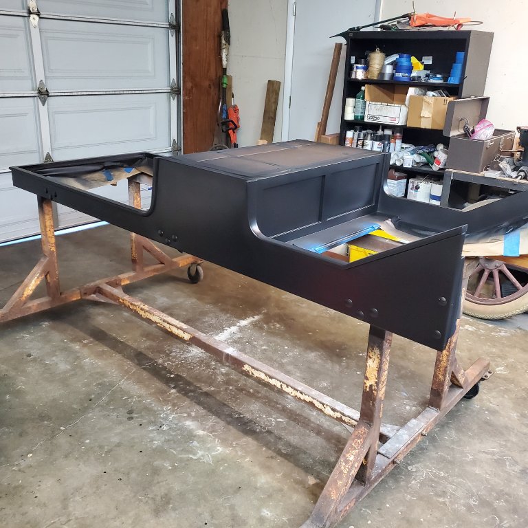

RGould1910
- Posts: 1235
- Last Name: Gould
- Location: Folsom, CA

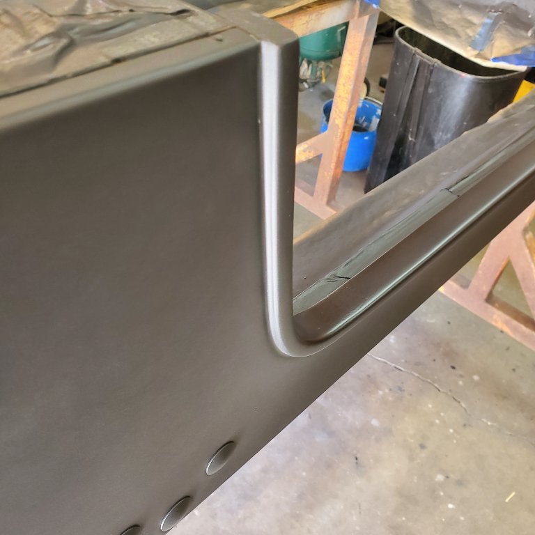

Got the body platform in epoxy primer ready for the painter. This body has wood panels on the seat risers and wood trim with an open grain. I filled the grain and primed rhe wood with Kilz wood primer and caulked the spaces between the sheet metal wood trim. Only after I was satisfied did I paint it with DP 90. It seems I tried every product on the market to fill the wood grain and the spaces between the rails and sheet metal, making every conceivable mistake. Thank goodness the end result turned out good. It's one of those jobs you look at when finished and wonder what took you so long.

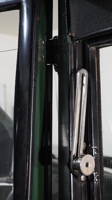

Ken Lefeber
- Posts: 70
- Joined: Mon Jan 07, 2019 10:40 am
- First Name: Ken
- Last Name: Lefeber
- Location: Plymouth, WI

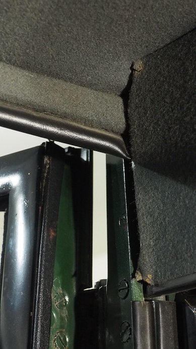

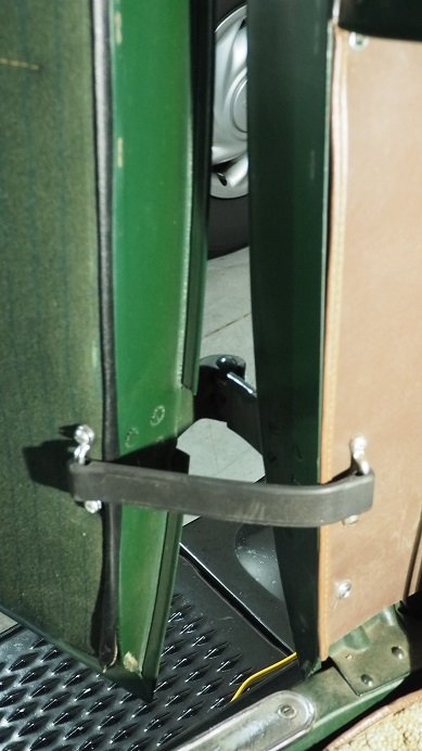

This is how it looks on my 1927 Coupe.
I hope this helps.
I hope this helps.
BLB27
Topic author - Posts: 892
- First Name: Bruce
- Last Name: Brakke
- Location: Ames, Iowa
Ken, Thank you! Here is what I conclude from you photos.
The front windlace is installed on the door from the top of the door to the bottom.
There is windlace on the frame above the door.
This is what I believe was the situation on my coupe.
I would like at least one more response with photos similar to yours.

jab35
- Posts: 1037
- Last Name: Bartsch
- Location: Dryden, NY 13053
"There is windlace on the frame above the door."
That was not the case on my '26 coupe, but I do see it on Ken's coupe. My '26 coupe had remains of windlace on front edge of door and top to floor on the body at the latch side of the door frame. The top of the door frame on the body is covered with a 'U' shaped strip of light gage sheet metal that clips to the body. That 'u' is covered with fabric and slipped over the metal, one of the final steps of the interior finish application, per Mike Francis when I talked to him @ Hershey last month. Those 'U' clips frequently are missing in barn/hedgrow finds. ymmv, jb
