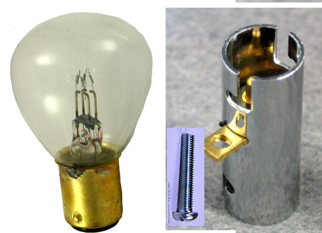

You do not need to use 1157 bulbs they use a different socket base BAY15D (offset pins) while the Model T double contact base is BA15D (aligned pins)
Noe the picture for the BA15D is showing optional wiring positions for ground. For our purposes the bottom two contacts for for the headlight filaments and the outer shell for ground. However the + - represents connecting bulbs in series like for for Magneto Bulbs --
The vendors sell a High low beam bulb basically is two circuits. When t he switch is on DIM it provides voltage to the 32cp filament, when switch to ON the connection to the Low filament is disconnected and the 50CP is used. An 1188 6v bulb will also work but the filaments aren't positioned perfectly The vendor bulbs appear to have their filaments in the proper focal point position for headlight reflection. If you look into the reflector you may see a shiny center

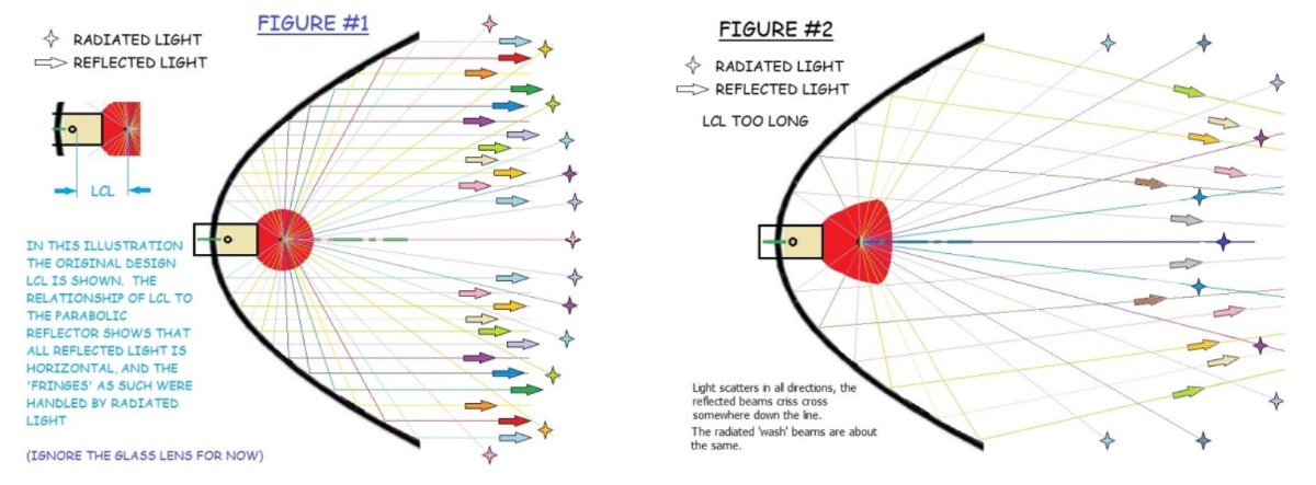

Headlight "Brightness" should be measured by what portions of the road are illuminated and not by the C.P. or Lumen specification of a bulb. The Model T reflector has a narrow focal point where the light source needs to be for it to be reflected properly. Looking at a bright headlight lens doesn't mean that the light is focused, just that its dispersed on the headlight lens. Most all LED and some Filament bulbs have most of their points of light outside of that focal point.
So here is a bulb and the screw is used to get the tips of the two filaments into the focal point location. Anything outside that will project unfocused light. --
The clear area at the base of the reflector is where the focal point is
Very Low Wattage - This absolutely true but is it necessary. I believe that that there is a lack of understanding on the Model T charging system.
For example:
The use of a Voltage regulator will not provide more voltage than a Cut-Out. The amount of current (amps) output from a generator is regulated by the 3rd brush, so neither the VR or cut-out manages it. The VR intended purpose is to limit the voltage from the generator to prevent the battery from being overcharged. It provides the same function of a cut-out by protecting the generator from running like a motor when the engine is shut off.
Ammeter readings - Fact a battery with just a cut-out can be damaged more by a constant positive ammeter reading than by a negative one. Overcharging a battery can cause more damage than draining it. This not to say that a constant negative ammeter reading is good either but it is less likely to cause damage. Manual regulating the ammeter reading by turning on the headlights during the day time for safety and to prevent overcharging is a good idea. Its best to visualize an electric golf cart - its batteries are not charged while driving, yet it gets you a round.
Lead-Acid Batteries - As a result of too high a charge voltage excessive current will flow into the battery, after the battery has reached full charge. This will cause decomposition of the water in the electrolyte and premature aging. At high rates of overcharge a battery will progressively heat up. As it gets hotter it will accept more current, heating up even further. This is called thermal runaway and it can destroy a battery in as little as a few hours
Optima Batteries - Overcharging can cause the safety valves to open and battery gasses to escape, resulting in premature failure. These gasses are flammable! You cannot replace water in sealed batteries that have been overcharged. Any battery that becomes very hot or makes a hissing sound while recharging should be disconnected immediately

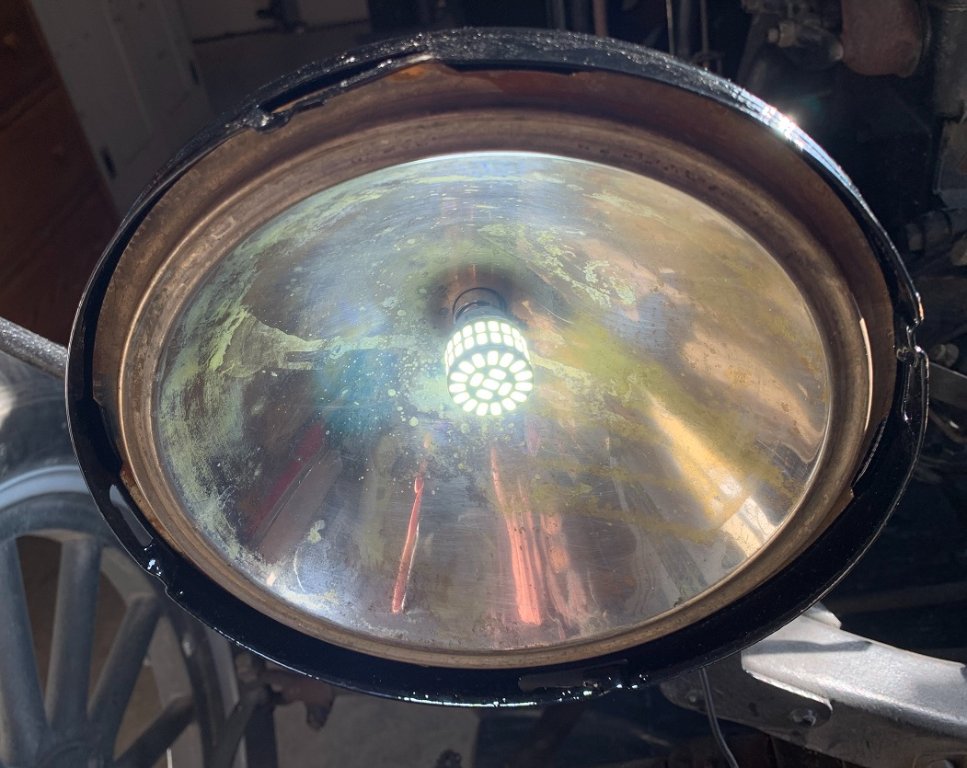

I replaced my 6 volt bulbs with LED's in my TT. They are a lot brighter. These have high and low beam, basically the bulb has an internal 50 ohm resistor on one pin to dim the LED's. Unfortunately the 6 Volt LED bulbs that I used don't have much difference between high and low. The resistor needs to be bigger, at the expense of a dimmer 'dim' setting.
I was able to focus them. Looking at the reflector without the glass lens, There's a position where most of the reflector is lit up. That turned out to be quite a bit forward (toward the front of vehicle) than the dual filament 6 Volt bulb.
The current went from 3 amps to 0.150 amps (150 mA) and they stay cool.
They run off the battery (not the mag) so the voltage is pretty well regulated.
I did have trouble with the bulb ground. The socket ground relies on a clean contact through the adjustment screw. Rusty sockets were intermittent. Not original, but I soldered a small flexible wire from the socket to ground. Solved my problem.
There are a lot of styles for 6 Volt LED bulbs. Wish I had the time and money to try them all.
Attached are the second pair I tried.

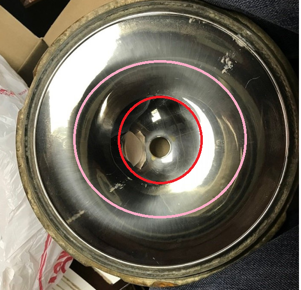

The amount of light output is measured in lumens, but that doesn't mean that one bulb will provide more down the road brightness. The issue with LED bulbs is that the orientation of the chips that emit light when they are scattered around the bulb. Forward facing chips are not reflected, but illuminate the lens making the headlight look brighter and are still aimed by the lens (good). The chips that are the most productive need to be near the reflectors focal point. It is the lens that distributes and projects the light down onto the road ahead. These assume properly reflected rays.
So with the lens off you would want to adjust the area inside and close to the red ring to be the brightest - anything outside the pink ring isn't going to do much other than to make the lens glass look brighter.

Tom, presumably your photos show bright and dim for your lights, and the dim is achieved by driving the leds at a lower power. There can be no high/low beam with such bulbs, as there is no change to the orientation of the light source in relation to the reflector.
- Posts: 6542
Re: High beam vs low beam headlights?
The pictures appear to show all LED chips lit on high beam being reflected but only the forward array lit for low beam. The reflector isn't capturing much of anything from the LED in low beam and the picture is just shows the forward LEDs in the fluted lens. As far as brightness goes - Standard Model T filament bulbs are rated 50/32 CP & that is mostly reflected light but lower Kelvin. The LEDs are likely closer to that than the rated spec since not all is being reflected. As I stated earlier the higher K value changes the color of objects making them appear brighter but not having more light shine on them. So if these are even in a brightness tie with standard filament bulbs its a 1/2 watt (.083amps) vs 21w/6w (3.5/1 amps). That's a plus if its needed!Allan wrote: ↑Thu Nov 03, 2022 10:56 pmTom, presumably your photos show bright and dim for your lights, and the dim is achieved by driving the leds at a lower power. There can be no high/low beam with such bulbs, as there is no change to the orientation of the light source in relation to the reflector.
I checked the spec for the bulb and it does have a the option ffor high & low beam
V LED Headlight. Works 6V AC or 6V DC. 60 quantity 5730 smd leds. Optically filament aligned so you get maximum light output through your headlight fixture and lens. The headlight is dimmable using a variable voltage supply. Being dimmable helps out with the older vintage and classic vehicles voltage system and wiring is not 100%. There is a total of 16 forward firing and 44 side firing leds. Each 5730 uses up to 1/2 Watt of power. This bulb up to 950 Lumen or 70 MSCP for high beam. Low beam up to 500 Lumens or 40 CP for low beam. Compatible with C-6 filament designed light bulbs. Comparable to a 30 Watt to 55-56W Watt incandescent light bulb. This bulb works in both 6 volt negative ground and 6 volt positive ground vehicles, tractors and motorcycles. This lamp can operate 6 Volts and has both a low beam and a high beam filament. Long life up to 30,000 hours. Long warranty please see warranty details below. This 6v bulb shape will fit your headlight without any issues with installation. The shape is this bulbs is smaller than a normal BA15D headlight bulb.

Frank, you and I are seeing different things. The forward array that is showing for low beam is not as right as it is in the other photo, indicating that this array is being driven a lower power. i agree the reflector isn't capturing much of the light. How can it when the leds are aimed to the front.
The specs state that the headlight is dimmable, using a variable voltage supply. They do not state that there is a high/low beam function.
High and low beam are not the same as bright and dim.
The Ford parabolic reflector design is simply not able to focus and direct light from multiple light sources like an array of 44 leds, so high and low beam are not achievable.

You are correct. I selected a different LED. The website has several LED bulbs configured the same way. I would not have selected the one referenced in the photos (Product Code 68523). LED 87455 would be a better choice of the two. I do agree that the arrangement of LEDs aren't reflected properlyAllan wrote: ↑Fri Nov 04, 2022 8:25 amFrank, you and I are seeing different things. The forward array that is showing for low beam is not as right as it is in the other photo, indicating that this array is being driven a lower power. i agree the reflector isn't capturing much of the light. How can it when the leds are aimed to the front.
The one in the photos is 68523 --
The one I referenced above https://www.ledlight.com/6v-led-headlight.aspx 6 LED Headlight. Works 6V AC or 6V DC. 60 quantity 5730 smd leds. Optically filament aligned so you get maximum light output through your headlight fixture and lens. The headlight is dimmable using a variable voltage supply. Being dimmable helps out with the older vintage and classic vehicles voltage system and wiring is not 100%. There is a total of 16 forward firing and 44 side firing leds. Each 5730 uses up to 1/2 Watt of power. This bulb up to 950 Lumen or 70 MSCP for high beam. Low beam up to 500 Lumens or 40 CP for low beam. Compatible with C-6 filament designed light bulbs. Comparable to a 30 Watt to 55-56W Watt incandescent light bulb. This bulb works in both 6 volt negative ground and 6 volt positive ground vehicles, tractors and motorcycles. This lamp can operate 6 Volts and has both a low beam and a high beam filament. Long life up to 30,000 hours. Long warranty please see warranty details below. This 6v bulb shape will fit your headlight without any issues with installation. The shape is this bulbs is smaller than a normal BA15D headlight bulb.

Sorry about the confusion on the two photos of the lights! There's only one power supply and one brightness level. Was trying to emphasize how much surface area of the reflectors are used with this style of LED bulb. I used a low aperture and high aperture shot. Despite a lot of plating loss, just amazed at how much light is projected!
