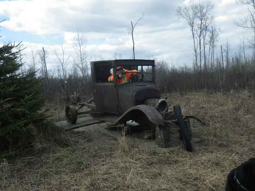

I have a yard art piece to identify. Should be some knowledge here . lol.
The body is a cutoff dodge bros, I see a dash gauge to id that.

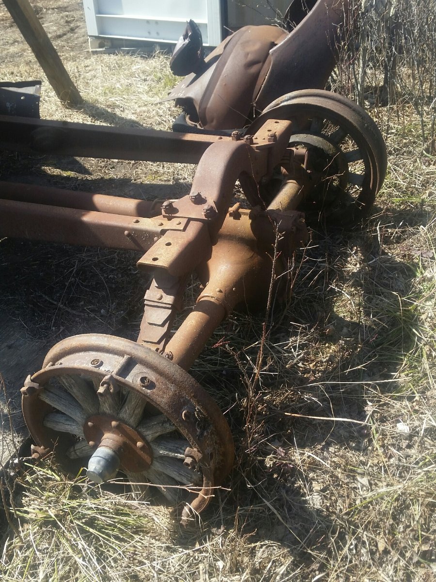

But the chassis I am unsure. Pics of engine and transmissions and diff.
The rear wheels have ford hubcaps. Are they TT? or AA?
Has dual tranys. Like a Ford, but the engine does not look like any T or A stuff I have...

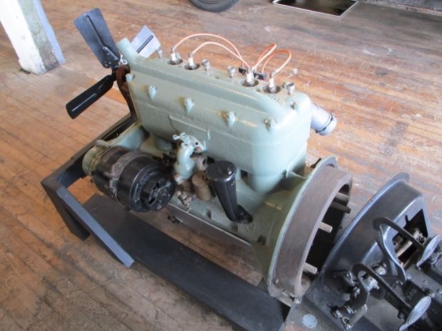

Engine is Dodge, not sure what year.

The rear end and rear portion of the frame is definitely Ford TT, but the front of the frame is not. Maybe they welded a Ford and Dodge frame together in the middle of the car. The body looks like a cut down 26-27 Ford car body, not a Dodge.

The rear portion of the chassis looks like a TT, as does the rear end. The long rear chassis cross member (2 holes on each side) indicates a later model. The front end of the chassis looks like it's something else. Of course the engine is not a T engine.

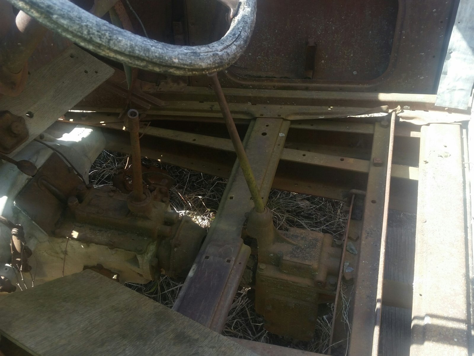

the aux transmission in there look TT??

I agree on TT rear but engine and front fender says DB to me. I dont think cowl is 26-27 ford. No hole on right side for fuel tank.

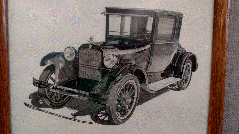

This is a ’24 Dodge Brothers Business Coupe. (This is actually one of my charcoal drawings but I have another photo somewhere if anyone wants to see it. This is a local car that I almost bought.) The body lines are very similar.

I'm not so sure I'd characterize either transmission as "auxiliary" in the sense of Model T vernacular since neither is tied to a T planetary. The forward one is probably what came with the engine, perhaps Dodge. The second one could be one designed for use in a TT, but it could also be something else. I'm far from enough of an expert to identify it. Maybe someone else can.

It reminds me of a delivery truck I saw almost fifty years ago. The silly thing kept showing up for sale, and getting a new owner who turned around and tried to sell it for more. Frankly, the price began too high (considering what you could buy for only a few dollars in those days!) at $150 if I recall correctly. The last time I ran into it, it had just sold for the fourth time I knew of for an absurd $600! Could have bought a running and marginally tourable model T for that then. It had a mid-teens Overland rear end with transaxle, had 21 inch model T wheels adapted. Model T frame and engine (complete T engines in those days could be had for $50). '20s Essex radiator, hood, and front half of a two-door sedan body. Behind the Essex body and seats was a home-made delivery sedan body, falling apart in poor condition and missing a lot.
Like others said, this appears to be part TT and part Dodge, with a few other bits thrown in. I know I have seen transmissions similar to that one, but don't recall for sure from what. It may be an early Chevy, but I sorta don't think so. The body is NOT Dodge, at least the cowl and firewall are not. Looks to me to be the front 2/3 of a '26/'27 coupe or two-door sedan, with the back from something else. The rear window is not T coupe, but whether a whole back or just the window panel I cannot tell from the picture.

I am tending to agree on a later T body shell, will have a closer look next time up at cabin.RalphS in NE Oregon wrote: ↑Tue Apr 23, 2019 3:11 pmThe rear end and rear portion of the frame is definitely Ford TT, but the front of the frame is not. Maybe they welded a Ford and Dodge frame together in the middle of the car. The body looks like a cut down 26-27 Ford car body, not a Dodge.
Ralph
The Dodge Bros gauge on dash must be a transplant, or they put in a dodge dash panel.

defiantly a Dodge Brothers engine and early aluminum transmission … is missing starter / generator unit , but most of the engine components are inplace … always an optimist ...Gene French

This is a 1926 Dodge Brothers sedan. The body is as close to the yard art as I could find.

The second transmission (auxiliary) sure looks like a cast iron Warford three speed from here. Note the six bolt PTO port on the left side and the Warford transmission mount at the rear. I'm guessing the front portion of a Dodge(?) frame and engine was grafted on to a TT rear section. Dave
