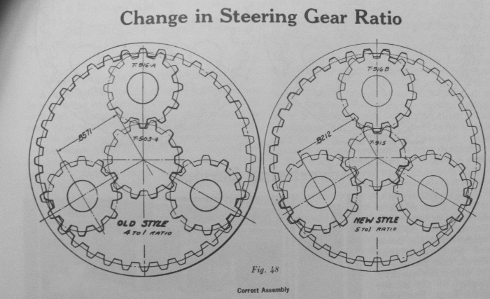

Can the 1926 Steering Post be used in the earlier year cars with a different set of Steering Gear Pinion Gears to change the steering ratio?
What else would have to be changed?

The steering case is different over the years.
For the later 5:1 you really want the case with the wider groove for the 'long' pinion post to ride in until the stops at each end.
The case with the groove and 4:1 has a more shorter groove.
The cases before '21 don't have the groove feature for a longer stop pinion post.
And that slot has to be at the top of the case on install of the case on the steering tube.
Use these measures to confirm the right parts, the center distances from the pinion posts on the steering post lets you know the difference of a 4:1 and 5:1 steering post.

Steering shaft, 3 gears & steering wheel stub shaft must all be 5:1.
The gear case differences arent critical. I did the conversion on a 14. No slot, no issues.

Seems to me that there is a Service Bulletin about this? Dan

Doesn’t it make a difference if the centerline on the 5 to 1 case is moved over half a tooth compared to the 4 to 1 case?

Thanks Dan! Your memory is better than mine! when I looked it up, I had bookmarked the page!
May 1925 Page 22 had all the answers.

Pat : I actually fabricated a mechanical stop for the pitman arm on my old '25 coupe. It would go over center on left turns with the 5:1 gearing. I later discovered that the drag link was too short so fixing that issue made the mechanical stop redundant. No matter what ratio, the pitman arm must extend perfectly straight down when the front wheels are in the straight ahead position, providing an equal arc of travel in both directions.

??? Your 25 should have had the steering gear body with a stop slot milled in. With the correct long pin in this slot, over steer is not possible?Bruce Compton wrote: ↑Wed Nov 09, 2022 12:51 pmPat : I actually fabricated a mechanical stop for the pitman arm on my old '25 coupe. It would go over center on left turns with the 5:1 gearing. I later discovered that the drag link was too short so fixing that issue made the mechanical stop redundant. No matter what ratio, the pitman arm must extend perfectly straight down when the front wheels are in the straight ahead position, providing an equal arc of travel in both directions.
This was the point of these improvements. What happened in your situation? Where was the fail?

The change from 4:1 to 5:1 required a change in the width of the stop slot from 13/32" to 15/32" to accommodate the different pin location in the 5:1 assembly. That change was noted on 9/27/24. A later change made the angles between the centerline and ends of the stop slot 62 degrees on the left and 67 on the right. When I replaced my gear case, I milled the slot to match the later specification.
