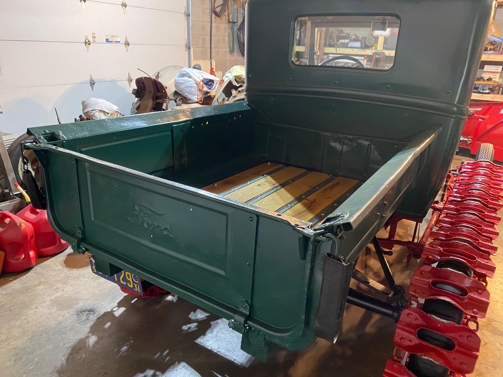

This is a 1931 Model A with a Supersnowbird kit made by ARPS. I chose to paint it red to highlight the parts of the kit. The pickup bed is 26/27 Model T.

I got new C-clips and spacers from Brian at NH-Snocar to build the tracks, links also to connect them. He makes quite a variety of parts. I sandblasted and made welding repairs to all the track pieces.

Joe - that appears to be a '25 box - '26-'27 had the fender outline similar to a Model A box.

It could be. It is not Model A. For some reason they bent the Model A frame straight also to accommodate the box. It does use the 26/31 tailgate.

Yes, same tailgate throughout. The stamping in the middle of the box (notice the 2 rivet holes) are for special, one year only rear fender brackets - that's a rare box as it is a one year only also ! Does the front panel have a "kick-out" for the battery access ?

What a great snow machine !
