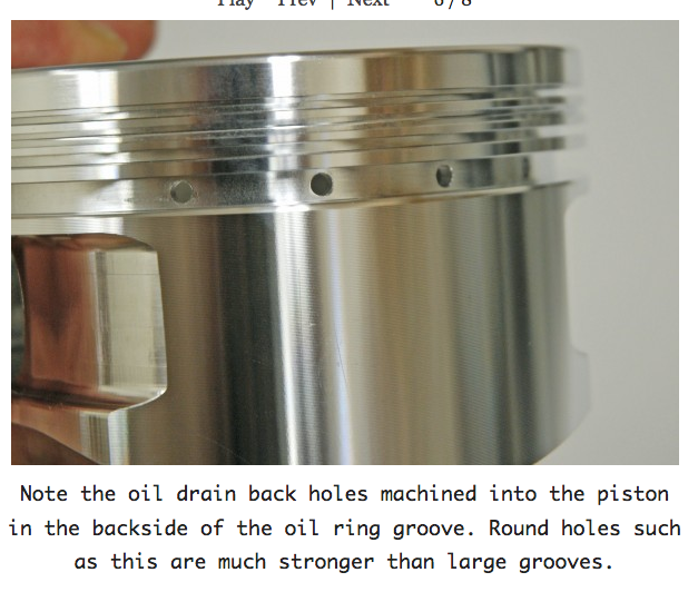

they do not have the oil drain holes that my other pistons have on the oil ring groove. i have received advice to drill these holes
and advice to not drill them so i dont really know what i am going to do. the issue to begin with is oil getting past the rings. philip

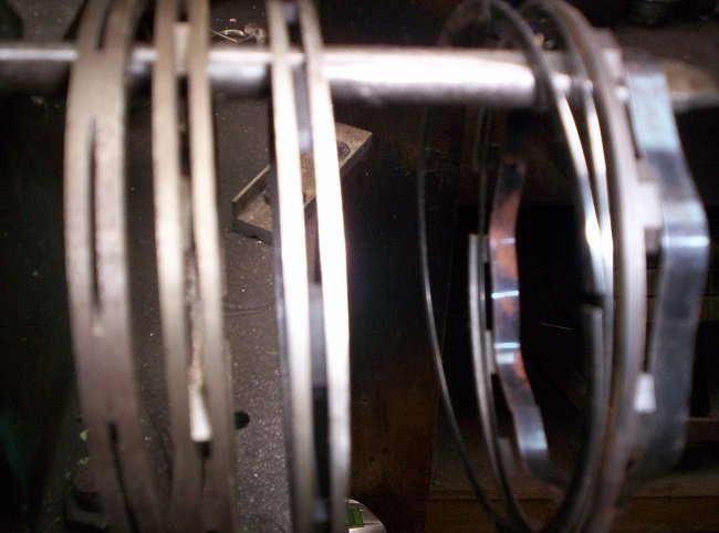

That being true, the original piston only had 3 compression rings but over the years many styles of replacements.
4 different oil ring styles, 3 different pistons with oil relief holes.

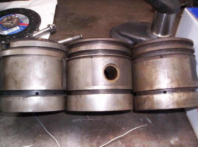

I rebuilt a motor last year with iron pistons that had been drilled with six holes around the lower ring groove. In asking about this I was told that period racers did this. These were old standard size pistons. I wouldn't do that on a road car. I also found a set of pistons with the second groove drilled, again racers. PK
Kerry
- Posts: 1464
- Last Name: van Ekeren
Re: new piston rings
The oil relief holes in the centre and right pistons in the photo are below the second ring, drilled in a shamfer that is machined just under.

If the 3rd, or 4th, ring does not have the slots, then there is no need to have the holes in the pistons. If it does have the slots, then the holes should be drilled. If you don't have the slots then you don't have an oil control ring and all the rings are compression rings. The rings should be close fitting in the grooves and the gaps should be correct. The huge gaps that Phil reported will allow lots of oil to be pumped above the pistons. If the rings do not fit tight in the grooves then they will pump oil into the combustion chamber.
For my money I would change out to modern aluminum pistons with an oil control ring, but it is Phil's car and he gets to do what he feels is best. Aluminum pistons also means more work and money.
