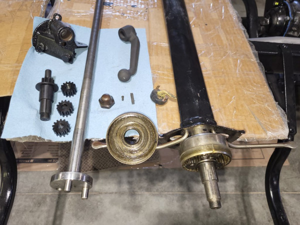

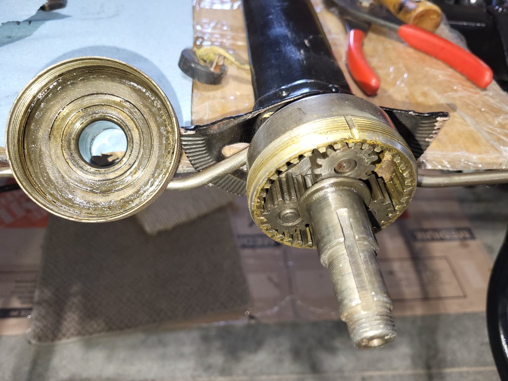

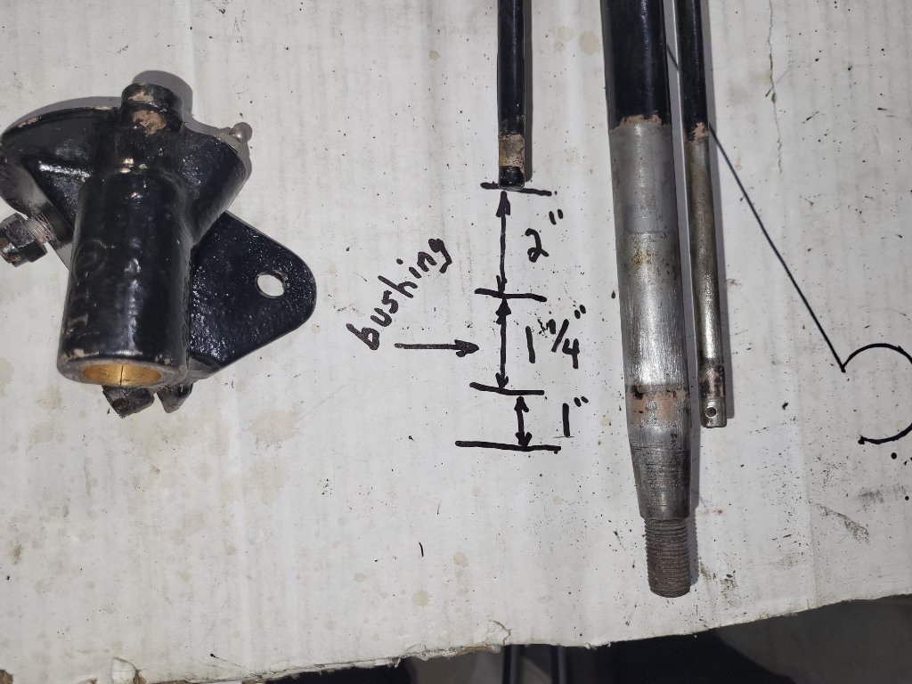

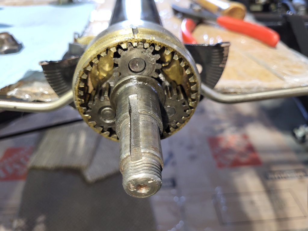

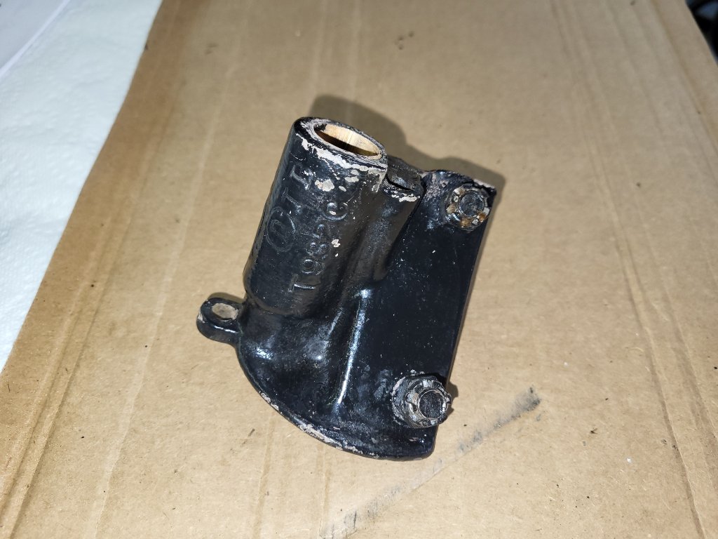

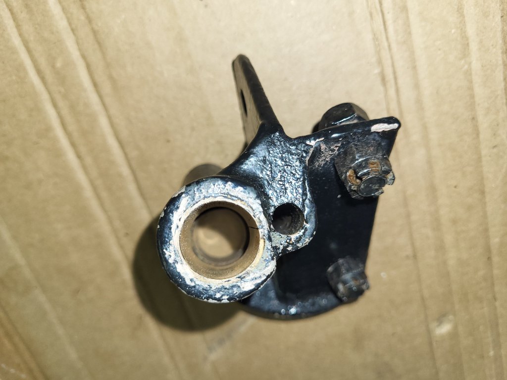

I am trying to determine if the bushing at the end of my steering shaft needs to be replaced. I made measurements of the inside of the bushing and on the shaft.
Bushing measurements: 0.757, 0.766, 0.754, 0,760 (ave. 0.759)
Shaft measurements: 0.750, 0.746, 0.745, 0.744, 0.745 (ave. 0.746)
0.013 difference.
Photos attached. Forgot to take one of the shaft.
Need opinions!
0.013 difference.
Need opinions!

I'd re-bush it while it's out. Shaft is probably OK.

I assume the shaft's original diameter was .750. If that's correct, the shaft wear is minimal. I'd install new bushings, and ream, if necessary, to the correct clearance. The shaft may not be evenly worn, so be sure the rebushed piece will slide over it before final assembly. Be sure any grease holes line up correctly. Be sure the shaft taper and keyway are in good condition and that the pitman is aslo in good condition to achieve a tight fit. Once you have driven the car a few dozen miles, all nuts & bolts will need to be checked for tightness. I'd want to go over the entire car after a few dozen running miles, checking everything for fit and tightness, just as Ford recommended doing on a new Ford car.
- Posts: 4451
Re: Bushing at End of the Steering Shaft
I assume the .750 shaft dimension that you recorded was taken from the unworn area between the pitman arm and the steering bracket. If you do nothing but replace the bushings, you'll end up reaming them to maybe .752 to allow them to pass over the .750 section of the shaft. Once past, your new bushings will be situated over the worn area measuring .744/.746. You'll then have .006/.008 clearance. Not a whole bunch better than what you began with.
I would machine the shaft down to a consistent .744 diameter, then size the new bushings to .745/.746.

In view of the comments, I measured the shaft in the 1" length between the pitman arm and the bushing area. I also measured the shaft in the 2" length above the bushing. I remeasured the bushing and the shaft under it. See the attached photo.
The six shaft measurements in the 1" length are 0.750-0.749-0.748-0.751-0.752-0.751 (ave. 0.750)
The six shaft measurements in the 1 1/4" bushing length are 0.744-0.742-0.743-0.748-0.746-0.746 (ave. 0.744)
I made measurements in the 2" length above the bushing but forgot to write them down. They were about 0.750.
The three ID measurements of the bushing are 0.758-0.756-0.758 (ave. 0.757)
(1) ). The existing clearance is 0.013 (0.757 minus 0.744).
(2) It appears the shaft has worn 0.006 (0.750 minus 0.744).
(3) Replacement bushings are 7/8 x 3/4 x 1 1/4. I assume the original bushing was that size and was reamed to an ID of
0.751/0.752 or more. Is that a reasonable assumption?
(4) It appears the bushing has worn .005/0.006 (assuming that the original ID was 0.751/0.752).
(5) The ID of a new bushing would need to be at least 0.752 to get bracket into position on the shaft as is. Therefore,
the resulting clearance would be 0.008 (0.752 minus 0.744), not much of an improvement. This the point Jerry
made!!!
In Summary: I am not capable of machining the shaft or removing and installing a new bushing. Obviously, I could take the items to a machine shop and have it done, and I will do that if it is really necessary.
If the shaft, in the 1'' length and bushing area, is machined to 0.742 is there a bushing available that can be reamed to accommodate the shaft?
The question I have is: If I live with the existing condition, how will it affect the steering?
I am replacing the pitman arm.
made!!!

- Posts: 8620
Many people may not realize how nicely a Model T with the chassis and tires in good condition and proper adjustment can ride and handle.

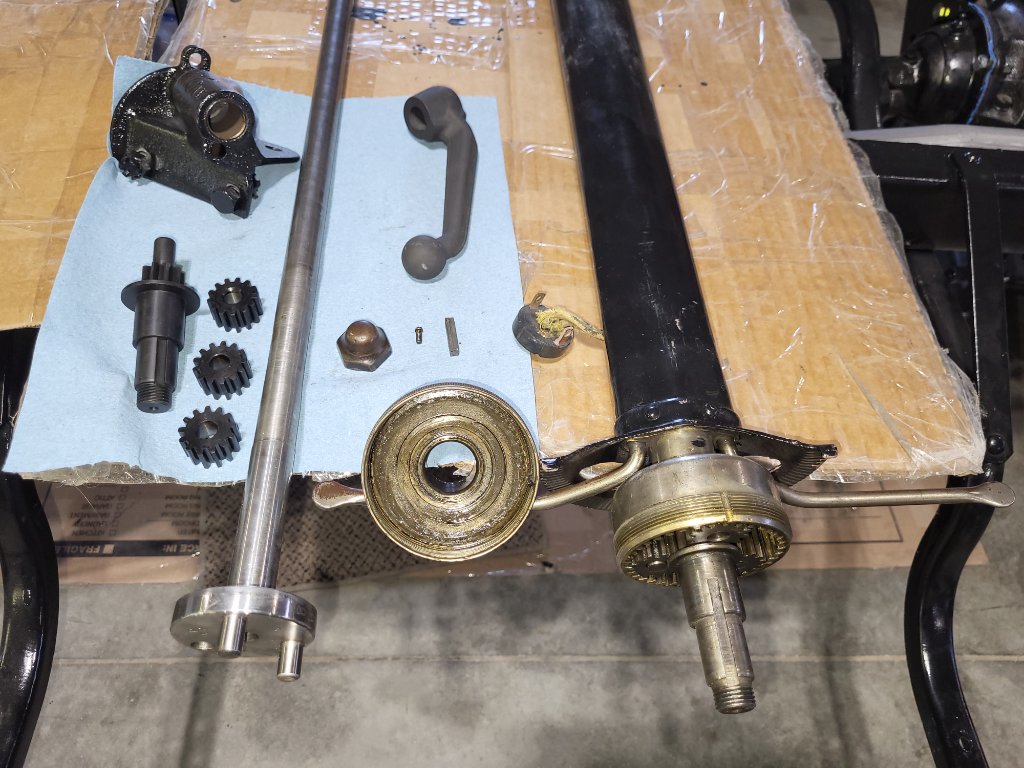

I decided to replace the steering shaft. The condition at the end of the shaft is more than I wanted to deal with. The items at the head of the shaft appear to be in good condition, as shown in the attached photos, and could have been reused.
The last photo shows the new shaft, gears, bottom bracket with new bushing, and new pitman arm.
