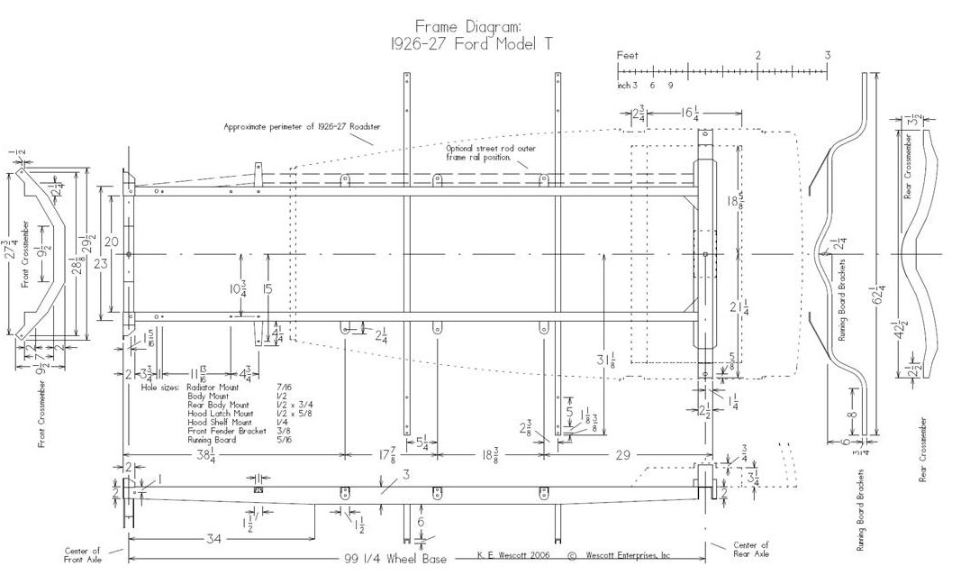

Can someone with a bare T frame measure the drop from the top of the frame rails to the center of the crossmember surface. Lay a straightedge across the rails and measure down. My TT is 5 1/4”. I’m trying to determine the difference between a TT and a std. T.

This diagram is for '26-'27

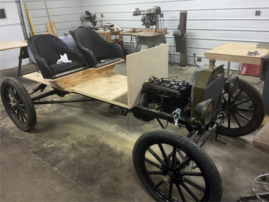

The reason I ask is I have an original '15 brass radiator (-off of my '15 Touring) that we installed onto a later steel-era chassis when we were building a quickie speedster for Blake. During mock-up assy., the lower tank reinforcing bracket hit the top of the crossmember without the mounts touching the frame. We re-fit it onto the original '15 frame and it had about ¼" of clearance under the lower tank strap. Because we were in a hurry, we just cut a couple pieces of wood and placed under the radiator mount for clearance and all was good. I/we just assumed it was because we were using a later frame. Unfortunately this car is no longer a car, but I have attached a few various pix of it where maybe you can see what we encountered. Also, here is a link to a video that you might be able to tell more about the frame and see the spacer. ( https://www.youtube.com/watch?v=7BeAHmCMztI ) Thanks!!
