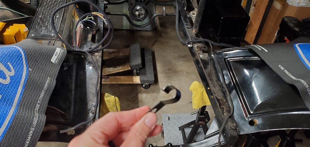

What secures the wiring loom to the car as it runs to the headlights on each side?
I bought 4 of these 5033HS clips that are called hood shelf mounted wire clips.
Do I use two on each side?

Our Canadian sourced cars use two part clips. The loom is held between two identical pieces which have curved reliefs in the end to accommodate the loom. These pieces are held in place by the hood shelf bolts. I cannot find them listed in any of the dealers' catalogs, so it looks like they are Canadian only.

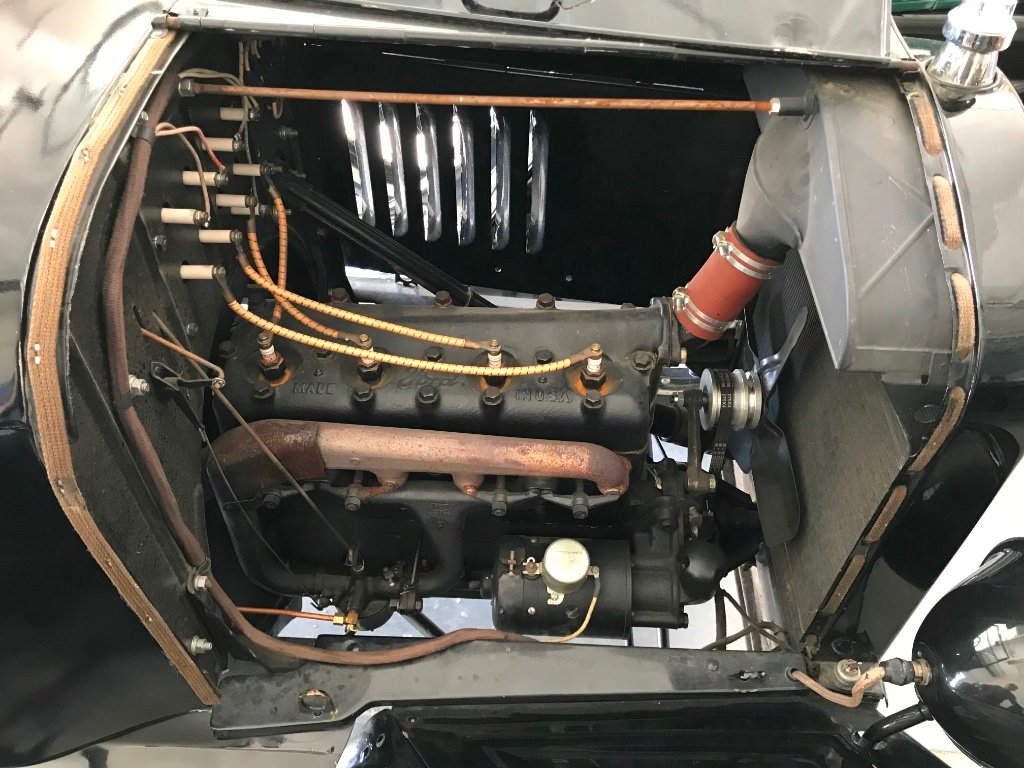

If you have a Model T service manual it has several views of a 24-25 T’s engine compartment. It might give you an idea of how it’s done if you check the pictures closely. Since your car may be a 23 low cowl it might be a bit different. Not sure about that. I have a 21 Low cowl touring and I put the loom wires under the hood shelves. Without looking at it the clips went under the shelves. The one on the carburetor side went under the shelf the best I could get it.
Maybe someone has a good picture of their car.
I can remember it was important that the wire loom has to be positioned correctly on the firewall in order for the loom to go under the hood shelves. If not they will seem to be a bit short to go under the shelves.

This should help

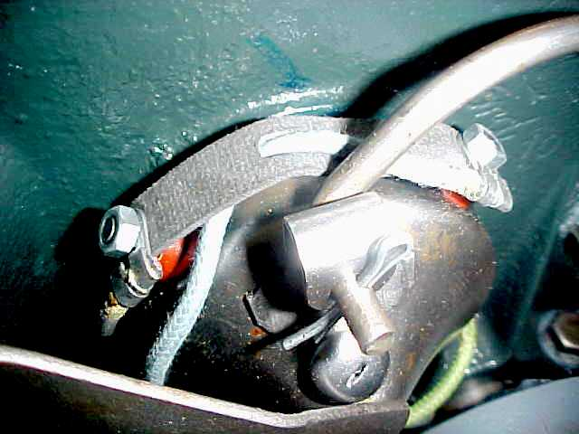

Lang's is pretty darn close if you're looking for hood shelf clips...http://www.mtfca.com/discus/messages/50 ... 1231999043
I do not possess the drawings, but Dan Treace is an extremely reliable source of information and as gleaned from his post(s) here is the following:
The wiring loom clips under the hood shelf were T-5033
The fuel line clip was T-2816
The fire wall look clip was T-2118 (snyders shows the correct clip for the P/N, while lang's shows the correct hood shelf clip but with the wrong P/N
see all of: http://www.mtfca.com/discus/messages/70 ... 1484924616
Posts: 7293
Re: Correct engine bay wiring loom location
Post by Allan » Wed Jun 22, 2022 7:54 pm
The second reference Scott just posted shows the kind of clips I am used to seeing on out Canadian cars. In that forum thread, Dan Treace shows those clips, and an earlier photo in the same thread shows how they are fitted.

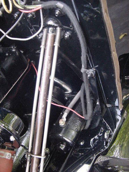

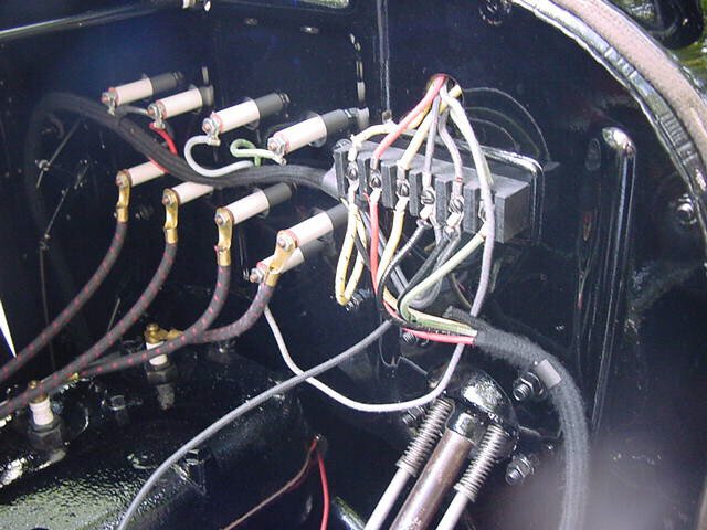

Pictures of a 24 and 25 engine compartment from my restoration files. Hope this helps.

Post by Original Smith » Thu Jun 23, 2022 10:29 am
The clip in the first photo is for an early car.

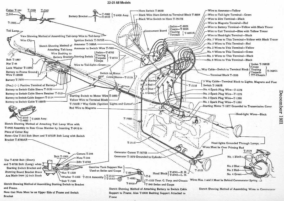

What year did Ford move the loom from over the top of the primaries to under them? My guess would be 1924?
Posts: 7411
Post by Steve Jelf » Tue Dec 13, 2022 1:42 pm
I'd like to know too, and the source of the information. The encyclopedia shows 1919-1925 wiring all the same. It even mislabels the 26-27 wiring as "pre-1915".
Posts: 3953
Location: Lomita, California
Post by Original Smith » Wed Dec 14, 2022 11:17 am
The 1925 Ford Service book clearly shows the location of the looms and clips on a 1924.
