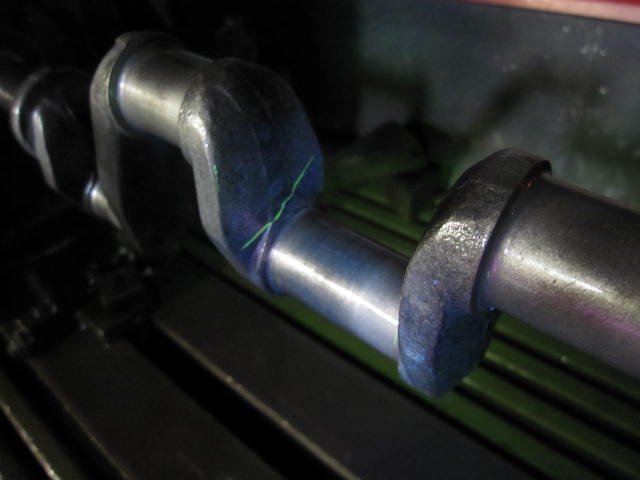

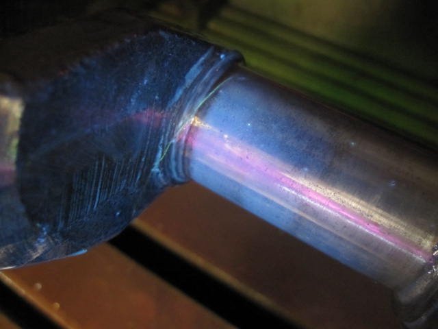

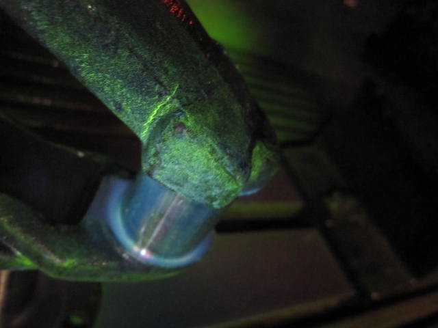

If a crank won’t ring, it is cracked. If it does, it might be cracked. I dry mag all batches of cranks I send to my grinder. He then does a more intense wet mag with a black light. Rarely he will find one will a flaw my dry mag missed. EE cranks are the same forging as all of the late cranks but a different formula steel. It is tougher and less prone to cracking but softer so more prone to wear. These I will let my grinder go to .030” undersize. All others .020” max. I do not send him anything but late cranks. The diamond web ones are scrap metal here.
