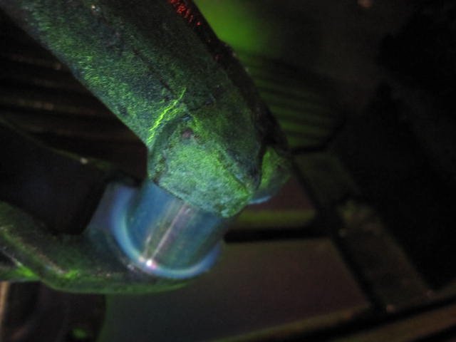

I have been going through some crankshafts that I have collected.
I have a couple EE's and some with diamond webs.
There are also three with the EE profile that are marked Made in Canada D.
Does anyone know what material they are made from? (AA or EE composition?)
I have my own dry particle Magnaflux so I did a check on a number of crankshafts.
Of the ones that checked positively I then did a "ring" test.
The EE's had a bright high pitch ring, others a lower pitch but a nice ring.
Two were really dull. Thoughts?
I have looked back at some of the old posts on this and there is no strong consensus
other than Magnaflux before using.
Any current thoughts?

The ring test is, for the most part, kinda worthless. Magnaflux is the real test. I've never heard of dry particle Magnflux. Gonna' have to look that up.

Dry magnaflux works fine, but if you’ve ever used a wet magnaflux you won’t want to go back. Especially on a crankshaft.

DRY MAGNAFLUX is useless on a 3 Dimensional part.
Ring test is also useless.
Only way to know for sure is to clean the crank that there is no dirt or rust on it and have it wet magnafluxed.
Doesn't matter if it's an ABCD EE crank they all will crack and there's only one way to find out.

Having been through at least a 100 non destructive aerial fire apparatus tests using Mag, ultrasonic & dye penetrant. I'm very
comfortable with dye penetrant I have seen it reveal cracks that other wise would not be found. Mag-na-flux is a real pain to
do some parts with. I have a Mag. setup but if I had to have someone test for me it would be Dye.

I think the advantage to mag particle is that it can detect discontinuities that are not necessarily open at the surface or are cracked but tightly shut such that liquid penetrant might not readily detect them. All of this is from my memory working as a testing technician back in the day.......hopefully I remember it correctly! But you cannot go wrong using wet magniflux on a crankshaft.

The ring test has always been a hocus-pocus of sorts...there was a valid reason for the old timers. They felt that a well forged crank without occlusions should ring like a bell...and the ones that went 'thud' had either micro cracks, or, lots of occlusions within and were not worth the time. Worked for them thru the years and prob a bunch of usable ones got trashed.
The modern day best method seems to be the fluorescent ultraviolet white spray that shows red or pink strings if there is a crack. There are certain factory's that require 100% spray check of all product output, and in at least one of these factory's they have even also developed an AI (Artificial Intelligence based) vision system to 'find' the cracks in the blacklight chamber and kick the faults off of the moving inspection line. These factory's do not even question a crack...once kicked, it's done-and sorted in bins for re-casting content on the open market.
These factories also do 100% x-ray inline also, to sort any possible occlusions. Again, no human factor, gets kicked, gets tossed.

If a crank won’t ring, it is cracked. If it does, it might be cracked. I dry mag all batches of cranks I send to my grinder. He then does a more intense wet mag with a black light. Rarely he will find one will a flaw my dry mag missed. EE cranks are the same forging as all of the late cranks but a different formula steel. It is tougher and less prone to cracking but softer so more prone to wear. These I will let my grinder go to .030” undersize. All others .020” max. I do not send him anything but late cranks. The diamond web ones are scrap metal here.
