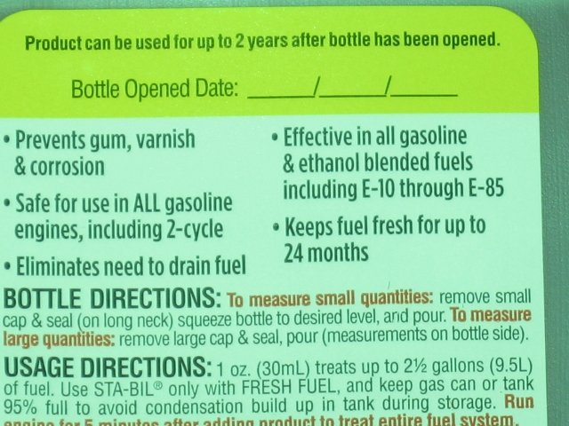

The label on the bottle says "UP TO 24 MONTHS". If I am going to store something for 2 years, I would definitely drain out the gas.Peter, Memphis TN wrote: ↑Mon Apr 29, 2019 9:24 amBoth claim to stabilize gasoline in the tank, although neither says how long.
Depending on how long something is going to sit and how much fuel is in it, those are the deciding factors for me if I am going to drain the gas or let it sit. If I drain the gas I still add the Sta-Bil when there is just a small bit left and then run the engine/carburetor dry. I do not use Sta-Bil on anything 2 cycle, the 2 cycle oil that I use (Stihl) has fuel stabilizer already in it.
