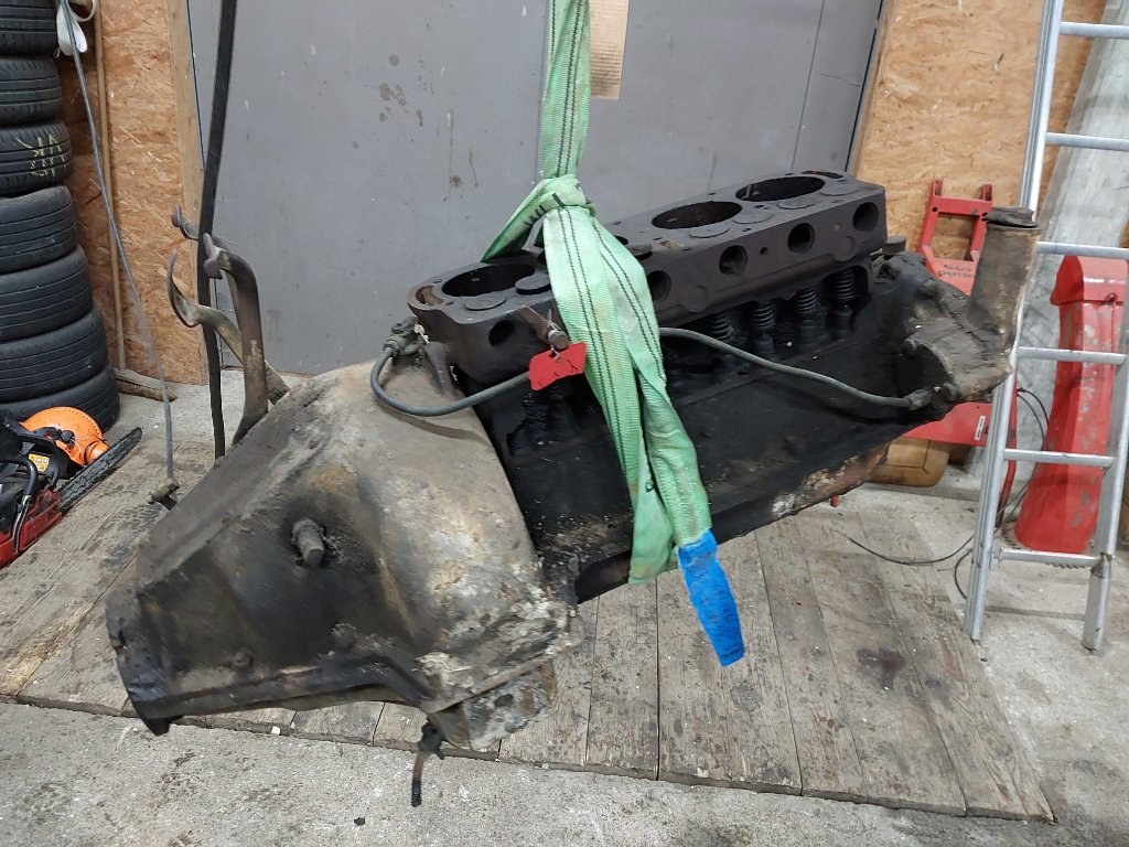

I found a T-Motor today, and that's not something we take for granted here in Switzerland.
It's sort of a surprise bag. The engine has been in dry storage during a car recycling for the last approx. 70 years.
Cylinder bore, valve stems and lifters appear to be original dimensions. Let's see what we can do with it as it looks pretty bad with my Touring 1926 block.
But this kind of timing cover is unknown to me.....
What was installed there?
Thanks for info

Thats a mag drive, looks like it was intended for a Fordson tractor. The alumn. hogshead is interesting on a motor with a one piece valve cover.

After market high tension Magneto mount.

Type of magneto drive front plate, missing the mag. The engine is a '26-'27, and the hogshead too, note the two bolts and bosses to back of engine block.

The H/H has a square block off plate.Jim Eubanks wrote: ↑Wed Dec 21, 2022 5:17 pmThats a mag drive, looks like it was intended for a Fordson tractor. The alumn. hogshead is interesting on a motor with a one piece valve cover.

Interesting way of routing outside oil line. Never seen that before. Also might need accy bolt on rear pan-to-frame brackets. Congrats on scoring that engine !

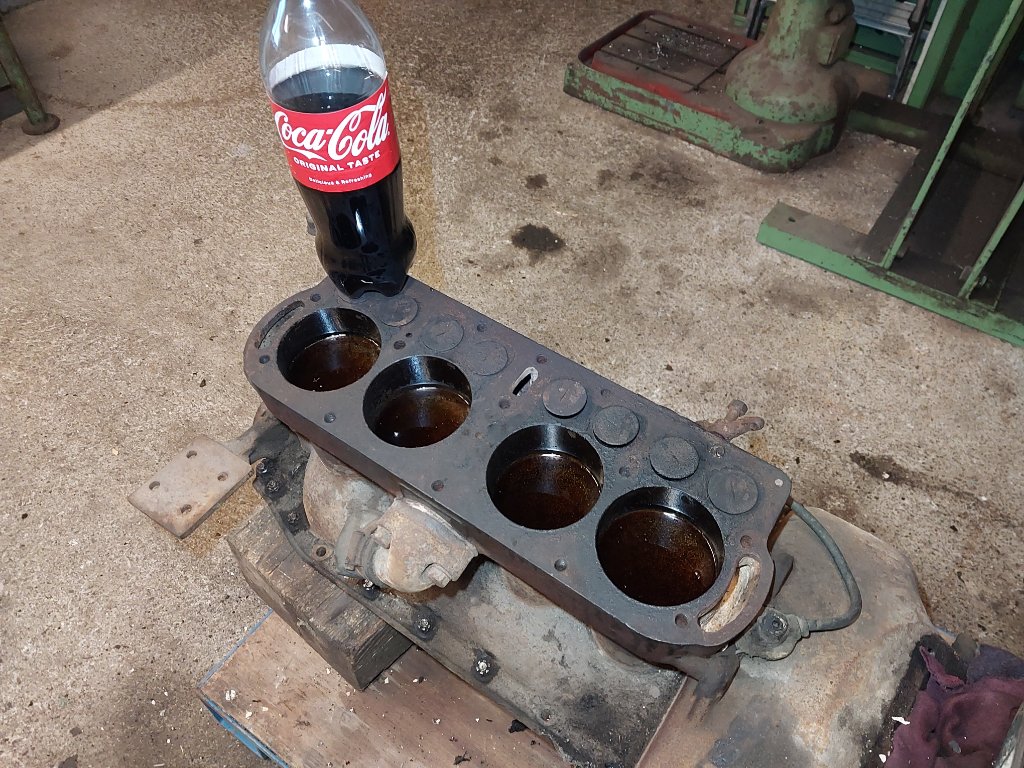

First of all, a Merry Christmas and Happy Holidays everyone. Many thanks for all the good tips and all the nice contacts around the world that I was able to get through this forum over the last few months.
I poured some Coca-Cola for my fresh motor for Christmas....
Cheers and let it take effect over the holidays....
I hope to find some time after the holidays to disassemble the engine. I am very curious about the condition inside.

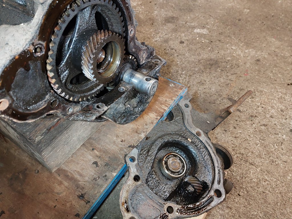

I had a little time today and dismantled the pulley and timing cover. Therefore, for all those interested, a picture of the inside.
To my astonishment, the crankshaft shows hardly any wear on the sealing. Can't wait to see the rest of the engine...

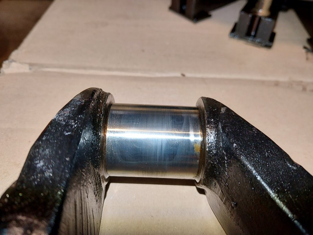

Yes, I planned to completely disassemble the engine and actually did it today. Unfortunately, luck wasn't entirely on my side.
The first main bearing is in many pieces and the connecting rods have a lot of lateral play.
The crankshaft was also ground and there are no more radii at the bearing points. This is probably useless....
Now I have to see what to do next.

I shouldn’t and sorry to type so much. I’ve never looked at a complete magneto drive setup in place and find it interesting.
The makers built it for precise gear clearance with the ball bearing that slides inside the drive gear and also used the ball bearing stud for an extra end thrust adjuster for the camshaft. I don’t recall the model A directions for adjusting end thrust but other engines say to turn the screw until all play is taken out, back it out about a half turn and lock the nut.
In pic 19240 we can just see the slot for adjusting the clearance. With an extra spiral gear trying to pull the cam forward, I can see where that was a good addition. The makers were looking ahead or someone had cam thrust issues.
I also wonder if the makers gave extra gaskets as shims for the pan surface to get the mag drive centered to the cam vertically?
What’s left of the mag drive is almost like an early IC100 from American Bosch but it isn’t either.
Here’s what perplexes me: I looked and looked at that pan... Bingo, it’s missing the “snout” for the front pivot!
Wait a second: Where are the rear mounts?
