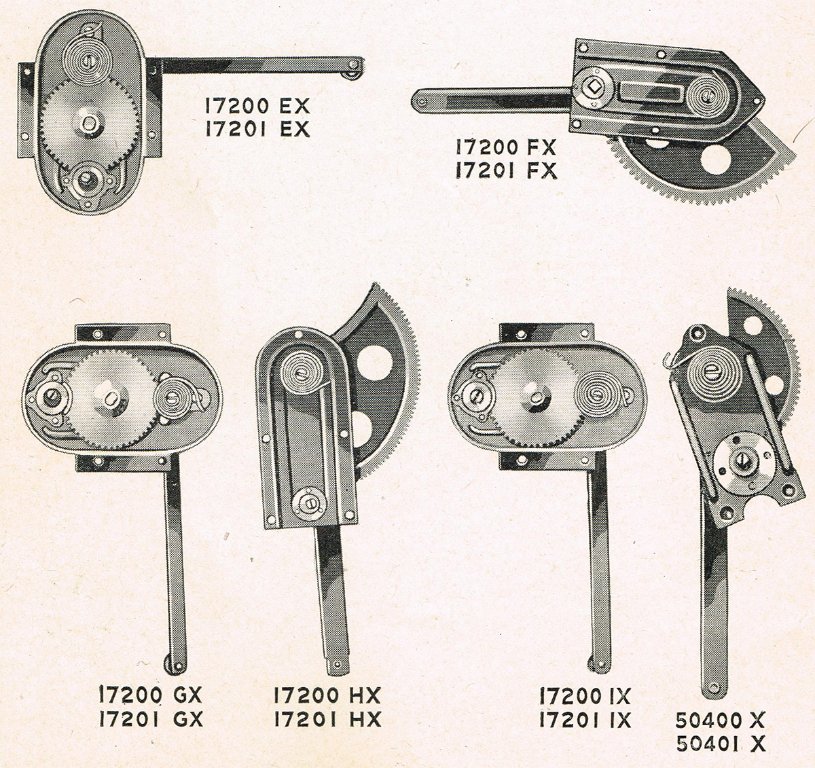

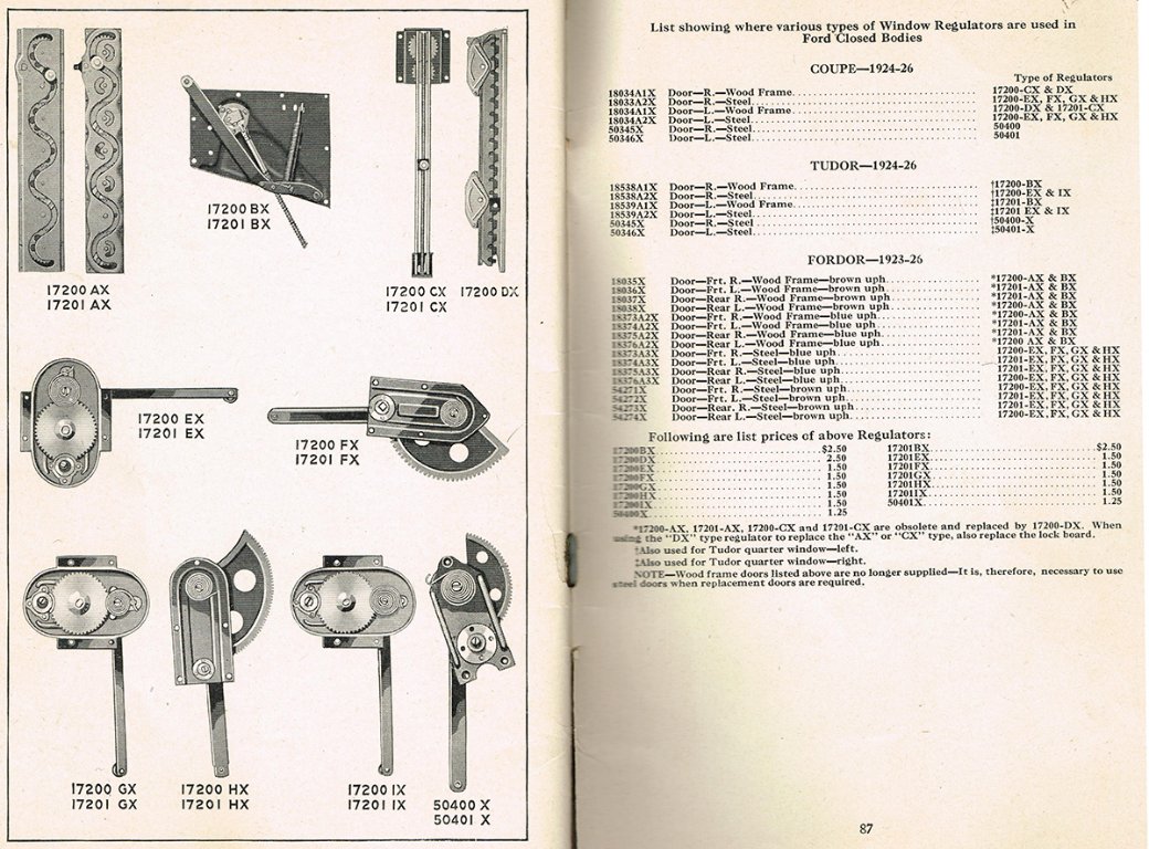

Re: 1924 model t ford coupe door window openers
You may have found this information already. These are the regulators listed for steel doors.
This is the complete info from the body book. Note upper right lists the ones used in steel door Coupes. The holes in your doors should narrow down which ones you need.
All have been difficult to find but the forum may be a good place to start.
