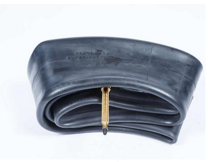

Has anyone fitted these two there Blockley's inner tubes? are they suitable with the 30 by 3 and half inner tubes? https://www.modeltford.com/item/DC1.aspx

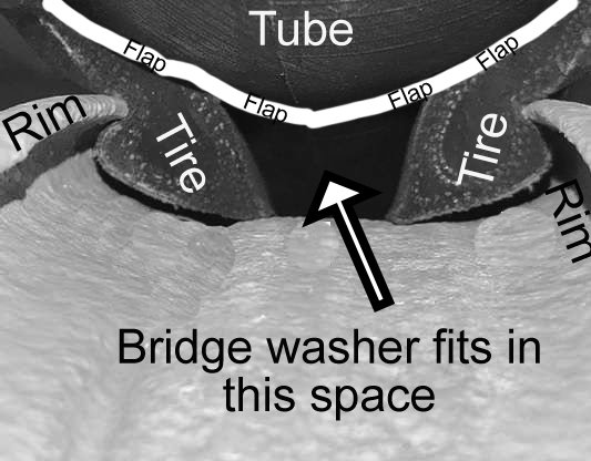

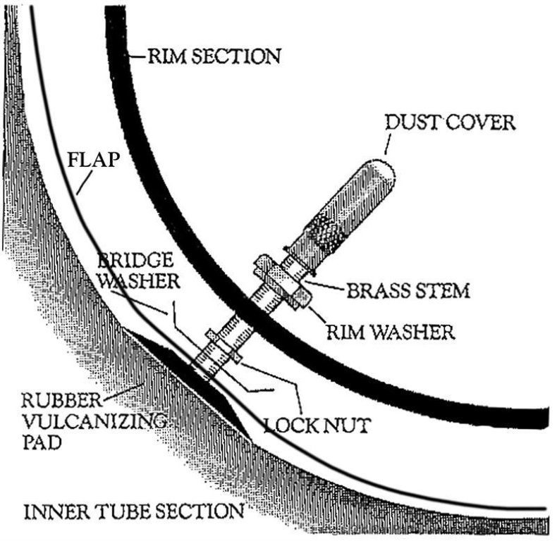

- Posts: 6575
Re: Blockley's inner tubes
picture from Lang's link
picture from Blockley

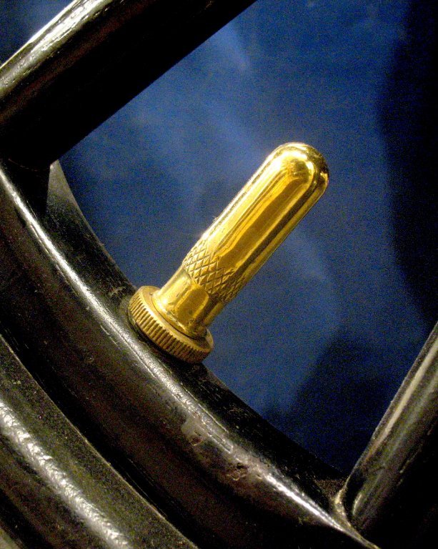

- Posts: 7410
Some dust covers screw onto the rim washer and some screw directly onto the stem. All of today's metal stem tubes use the larger sized stem not used by Ford. I believe all the reproduction dust covers are made to fit that larger sized stem.
This reproduction cover is an excellent copy of originals I've found at Hershey.
Franks Photo is what I have less the bridge washer. The Nut and Cover Screw onto the Blockley Tube.
Alan In Western Australia
The reproduction dust cap posted by Steve Jelf is an original.

Flaps protect the tube from contact with the rim. Flaps will not form a bridge above the beads creating or maintaining a void. Air pressure from the tube forces the flap into the space. Yes the bridge washer keeps the valve stem base from sitting in this area shown as a "void"Oldav8tor wrote: ↑Thu Dec 29, 2022 6:58 pmNorrie,
I've used the stem covers on my Blockley tires. The covers screw to the stem, not the nut.
It is my choice to use flaps and bridge washers. The flaps prevent the tube from being pushed down into the gap between the "clincher" portion of the tire and the bridge prevents you from pulling the stem down into the space between the "clinchers". My fear was that at 60-65 psi the tube would bulge into the gap and risk unwanted wear or damage. I've driven 4000 miles on these tubes without any problems.
I question the langs depiction of the bridge washer UNDER the flap.(between the flap & tube) I have never seen a tube/flap installed this way. Normally the flap goes over the bridge washer/tube. The flap gets stuffed into position after the tube is in place.
Am I wrong about this??
- Posts: 6781
John
look again
I think you may be misinterpreting Lang's picture
look again
- Posts: 5245
Langs picture shows the flap against the tube & the bridge washer on top all held together with the lock nut.Scott_Conger wrote: ↑Fri Dec 30, 2022 3:07 pmJohn
look again
Is that right?
I also question Jerry's portrayal of the flap not conforming in the gap between the beads, but creating a bridge & empty gap between the beads.
- Posts: 7248
The flap does indeed get pushed down between the beads, hard against the rim. That is what 60 lbs of pressure will do. I believe the correct installation of the flap does not have it fixed to the tube by the bridge and nut. The tube goes in the tyre and the flap folows, if you have the money to waste on flaps. A rim liner will suffice.
