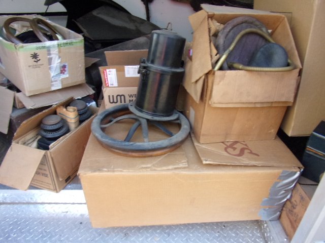

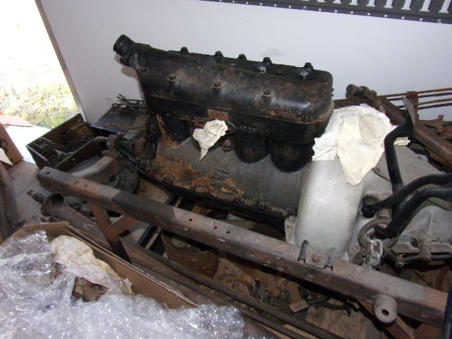

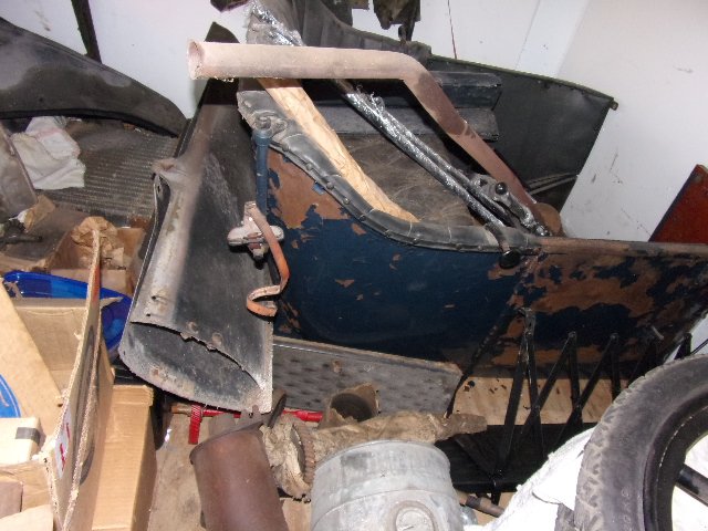

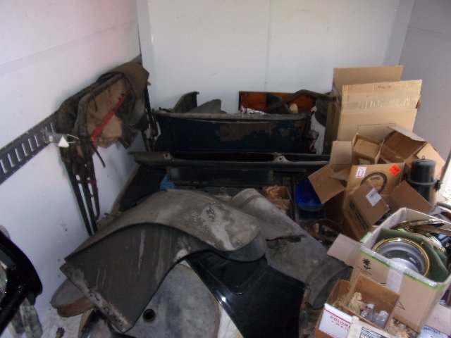

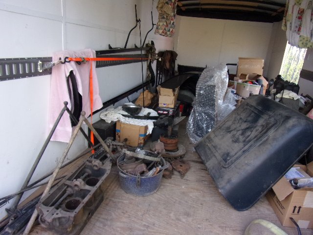

Decided to revive this thread since I finally got the car home. I don't have room for it inside so it'll have to live in my trailer for a while. Had a model T friend over yesterday and we found 99% of the correct 1914 parts for the car among the plunder. I need to decide if I'm going to keep it or not as i need another project like I need a hole in the head! I am growing quite fond of model T's however and am excited about the prospect of finishing it. I also have a '31 Model A DeLuxe Roadster. One of them will need to go, I just need to decide which.
Also a correction I need to make from an earlier post. The car has a late October casting date on the engine, not November.
