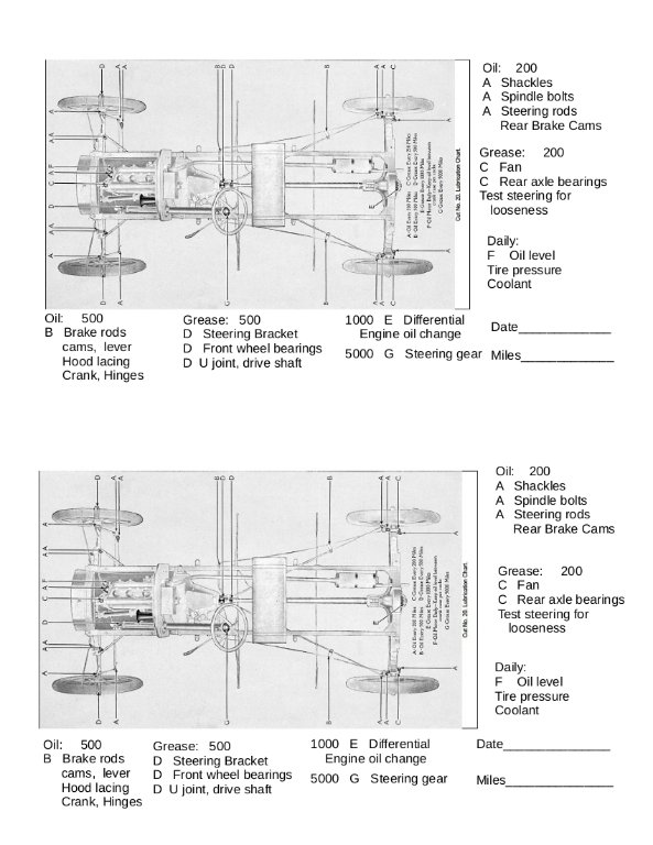

Post by Steve Jelf » Mon Jan 02, 2023 1:04 pm
I keep it as a PDF and print it on 8½ x 11 card stock to be cut in two 5½ x 8½ cards.
