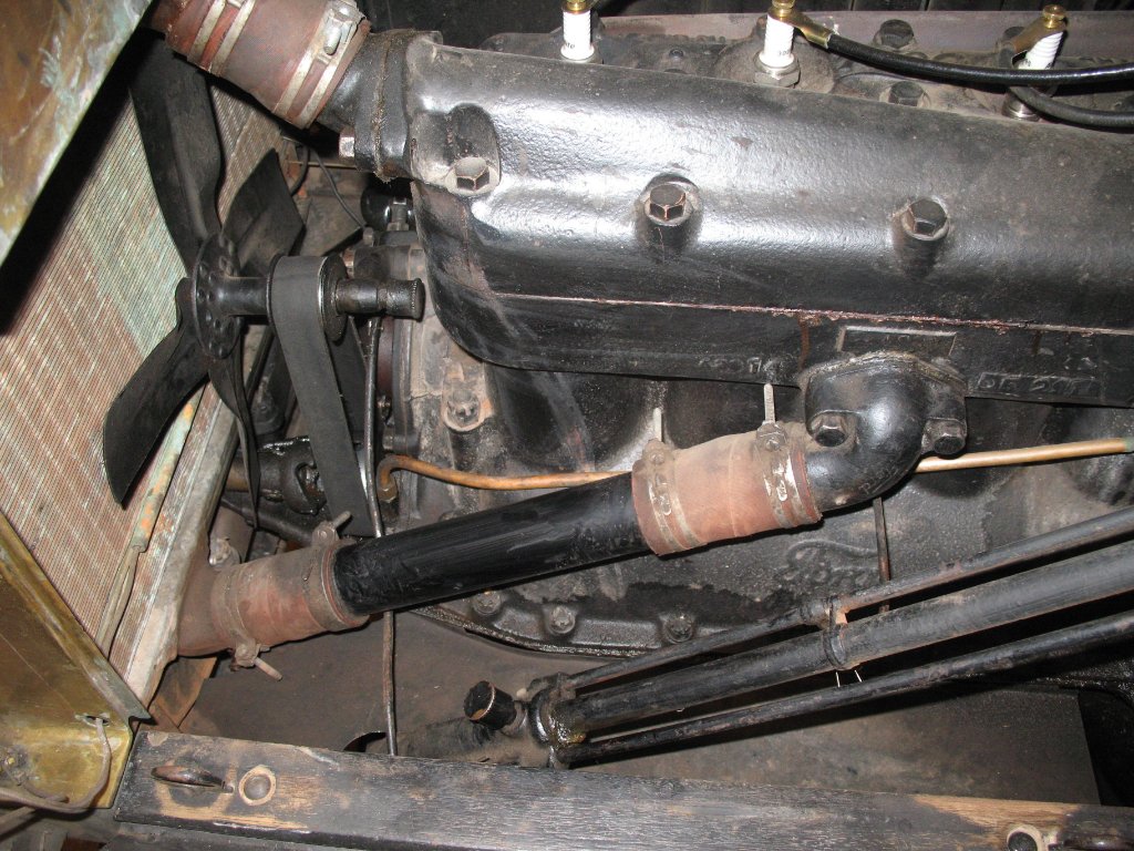

- Posts: 6701
Re: Timer rod adjustment question
Post a picture or two and you'll get constructive advice as to what to change to get a generally conforming setup which will allow proper timing range.
- Posts: 7392
A lot of external oil lines are like this. It's up to the installer to bend the copper tubing to fit. It connects to a hollow bolt used in place of one of the pan bolts. As Scott described, the rod goes under the water pipe and curves up and over the oil line. Lever up (fully retarded) the rod is at its closest to the copper line. It looks to me like about ⅝". As the lever goes down, that space widens, but not very much.

- Posts: 6701
this is what it looked like originally:
