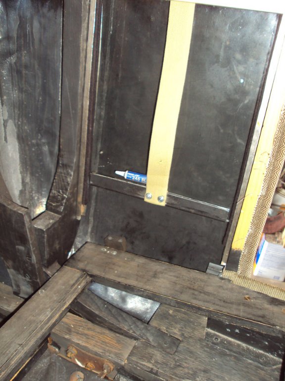

I don't know if these help or not.
http://www.mtfca.com/discus/messages/25 ... 1331667734
this is the rear window on my '22?
My best guess.
As I say, I don't know if these help or not.
Someone should have better help.

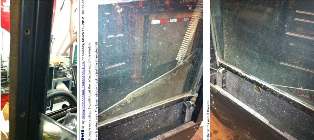

This is the picture I have of my '22 Coupe and one from Ken E. that he sent me years ago. Most were lost when my computer crashed.

Thanks for the pictures. Its hard to see, but is the window glass wider than the lift bracket?
