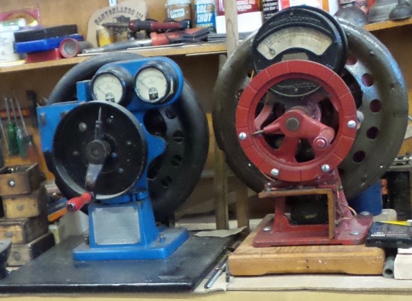

Post by HalSched » Thu May 02, 2019 12:23 am
This one was taken in 2014 where it's been ever since.
I found this picture, taken in 2014:

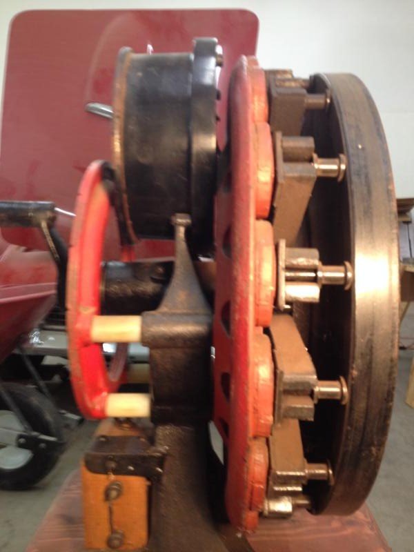

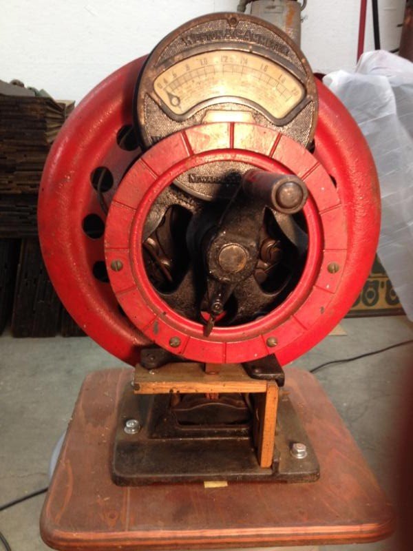

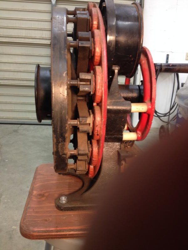

There should be a cradle that the meter mounts on.
