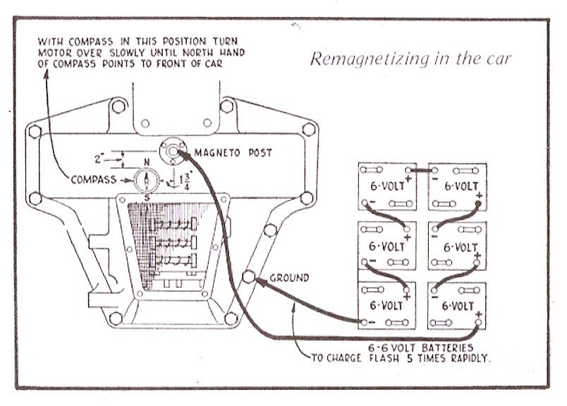

Simple set-up to
recharge magneto with none of the afore mentioned damage.

Distagon2
Re: Recharging magneto, current draw
The magnet charging process shown in the diagram looks quite simple, except for the question of who the heck has six 6-volt batteries handy to do this procedure. I guess you could ask to borrow some of your buddies batteries and hook them up as shown.
- Posts: 5253
AS shown, this method charges thru the mag post. Might be ok with this low voltage, but I wouldnt even risk it here. To get magnet saturation, a higher amp shock is needed. Either a high amp dc arc welder or I use 4 car batteries. (48V)
Also a compass is wonderful, but un necessary. The best alignment comes from a visual sighting of the magnet positions va the brass hold down screws.
See Tom Carnagee's (spelling?)post on in car recharging.
Distagon2 & Bruce.... Picture was saved from an old manual. Today we can use three 12 volt batteries, and still do the recharge. Just remember to flash your contact meeting very brief contacts and you will get sparks. Not to worry just stay away from natural gas or liquid gasoline fumes so there's no accident. There will be no destruction of the magneto post internals. Let us know how you make out with the three 12 volt batteries magneto charge.

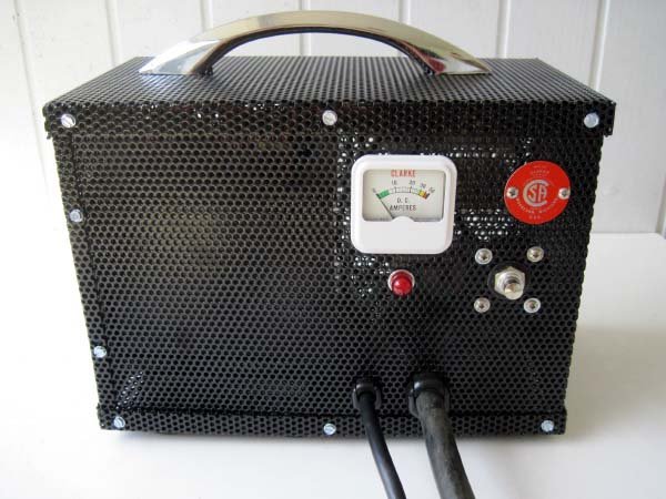

Last month, I had a 1918 engine that the compass needle pointed right to the case or pedal any place where it was moved.
I removed the spark plugs, jacked up a rear wheel to reduce any drag and set the transmission in neutral.
Three quick zaps with my 40 Volt 40 Amp golf cart battery charger coupled only to that post made the Mag work like new.
- Attachments
- Charger Front.JPG (72.65 KiB) Viewed 2259 times
- Posts: 5253
Like new? Did you check the output with an analog ac meter?J1MGOLDEN wrote: ↑Sun Jan 15, 2023 7:35 pmLast month, I had a 1918 engine that the compass needle pointed right to the case or pedal any place where it was moved.
Would like to know the actual output to know if it did the recharge well or just adequate.
You may have found a cheap unit/way to do the job.
J1MGOLDEN
- Posts: 1323
- Last Name: Golden
- Location: Bowie, MD
That unit cost me $40, but they are not used anymore.
A friend got one for free.
If you measure the resistance and get 1 ohm, then you measure the current and get 40 amps, a little math will tell you there is 40 Volts there.

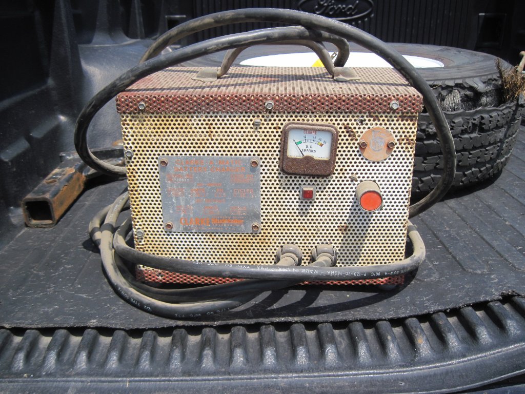

This is what an original one will look like.
