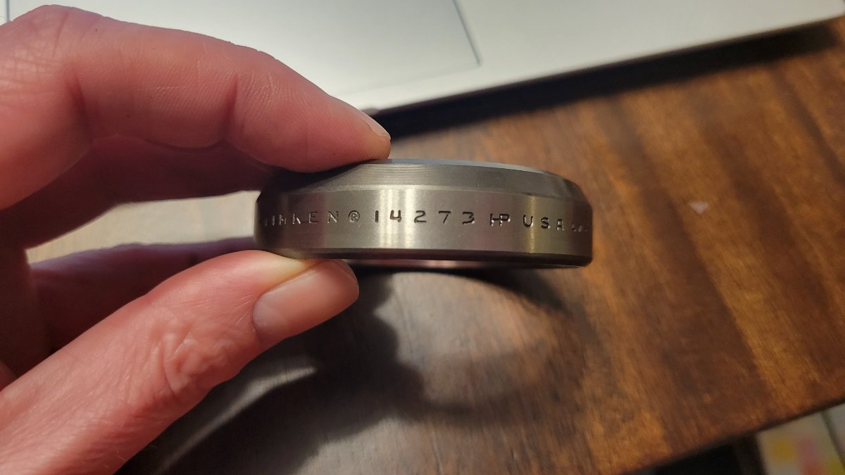

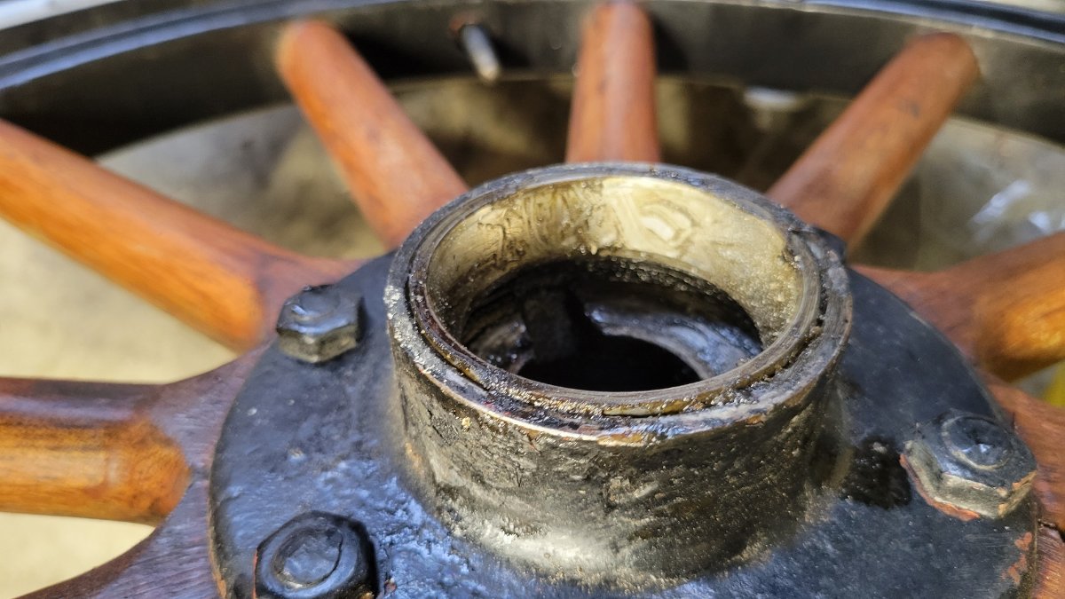

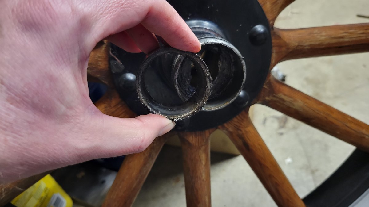

While I had the wheels off to replace my spindle bushings, I figured I would install my front bearing set.
The old bearings came out easy and the races needed some persuasion. It wasn't a brutal fight as some describe, but definitely required a creative tool and some hammering. It took about 10 minutes for the driver's side.
With that behind me, I got my new races out of the box and I was surprised that the inner race slipped right in and was loose. I tried the outer and had the same result. Here is a video: https://photos.app.goo.gl/C1FAykr3P5vMSTYZ6
I tested the gap with a feeler gauge. I was able to force a .010 into the gap but not a .015. Given the curve of the hub and the width of the gauge, I'm not sure I can get a better measurement.
Well, that's not supposed to happen. Do I need new hubs (yikes!)? I searched the forum and saw some people used a Loctite product but I wanted to put it out there to you all. Have you used Loctite or some other solution? Thoughts?

Thanks for the reply 2nighthawks... The inner race is loose too and it has the part number stamped on it. Looking at Langs kit, this is the correct race.

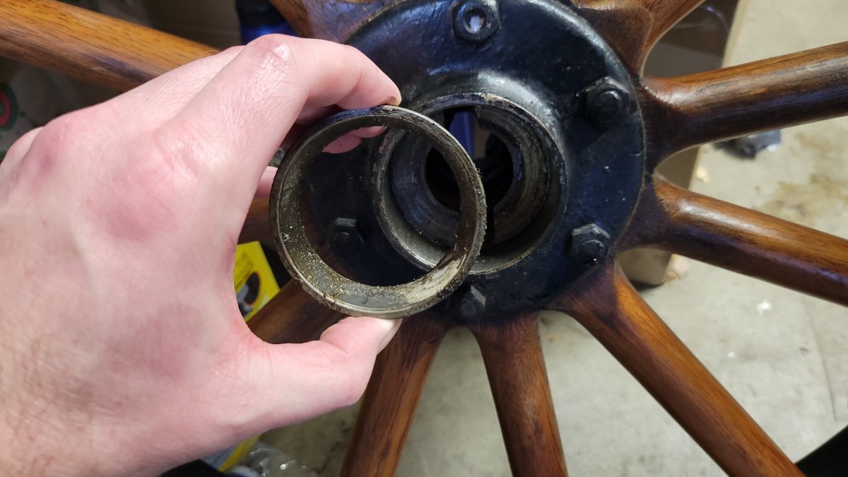

I just tested the hub and it ran down with the hub tool...
Here you can see an example of the minimal hammering needed to loosen the old races... https://photos.app.goo.gl/FFwwXHkmLP9dmBR17 <- fixed the link from my original reply

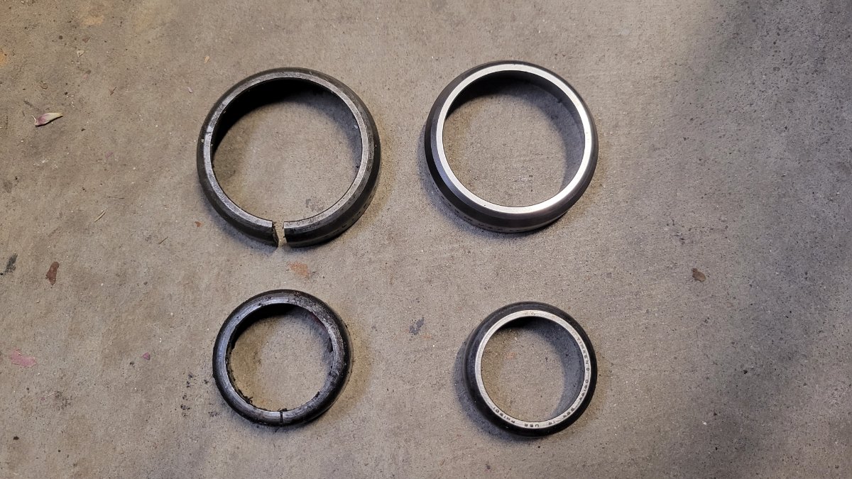

The inner races can be a loose fit and still need to be driven out. The hub bore only wears where the race sits, and not where the hub seal goes. So, you'll need to tap out the race to get it past the seal area. It makes you think the hub isn't worn...
Old races may seem to be tight in old hubs that haven't been used in decades. Sometimes, it's only the dried-up grease and oil that has them "glued" in place.
Outer races may also seem to be snug when you remove them due to small burrs and other abuse that rolls over metal at the nose of the hub. Pushing out the old race, forces it over these spots, making things seem snug/tight. Once the old race pushes these high spots back, and without those same interferences in play, the new race simply drops in.
The old races can also be split, or maybe even swollen, by overly tightened bearings or previous accidents.
Driving out old races unevenly by allowing them to get cocked in the hubs, can swell the hub and ruin it.

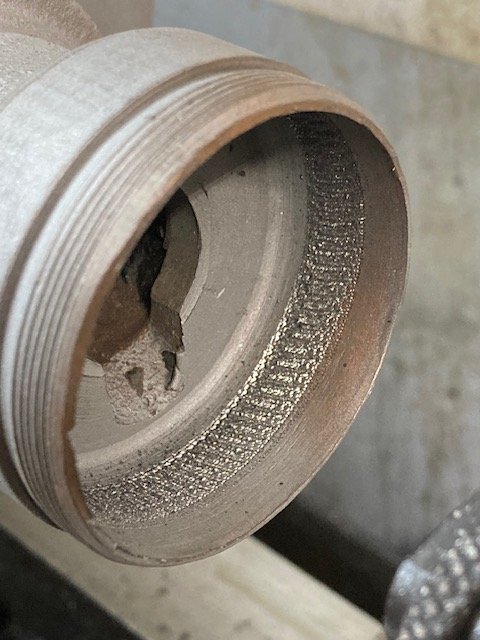

For loose inner races, I have carefully closed up the hub bores by repeatedly hammering the outside of the hub with a ball pein hammer. With the hub firmly supported by an anvil, or other significant hunk of metal, I beat on the hub repeatedly while slowly rotating it. Don't hit it too hard or you'll get the hole out-of-round! Many small hits and lots of patience does the trick.
Jerry,
I noticed the "split" in the old races and incorrectly assumed they were meant to be that way. Well, after a more careful look and clean up, I'm realizing they are the same type of timkin races that I bought from langs but broken.
I haven't done the passenger side yet but I quickly looked at the old races installed on the hub and they appear fine.
A replacement hub is looking more and more in order, but maybe I only need the one.

A split bearing ring normally is caused by an excessively loose mounting fit. The outer ring in this application must have an interference fit.
If the new bearing is installed with an adhesive, care must be given to maintain acceptable wheel runout, mostly wobble. As Scott commented, this would require a lot of skill.
I cannot comment about the durability of any adhesive in this case.

I suspect the split race, or a previous split race, allowed your hub to be expanded. It's also possible the hub is cracked. A better hub would be the best choice, epecially if the car is expected to be driven much.

Arbs, The link you posted above is an old post of mine. The "strawberry fit" I described will work very well when used with a locktite press fit type of product. The "strawberry seeds" act as a centering device. The large number of "seeds" very accurately will hold the race centered. Make sure to inspect the hub for cracks. A cracked hub should not be used. Like I mentioned in the link. Make your own decisions as to the use of this technique.
Posts: 4391
Re: Spinning Races - help
Post by Jerry VanOoteghem » Thu Jan 19, 2023 10:25 am
dobro1956 wrote:
Thu Jan 19, 2023 9:40 am
Without the use of loctite, the dimples you create will soon wear down and leave things just as loose as when you began. Even with the loctite, as Donnie says, "use your own judgement."
Posts: 4391
Post by Jerry VanOoteghem » Thu Jan 19, 2023 10:32 am
If you truly want to rebuild this hub, the "right way", you could take it to a machine shop, have the bores ground slightly oversize, or at least trued up. Then, have the bores hard chromed, then ground back to the proper size. It would be expensive. There may be some spray weld techniques that might also work.
Just how much size difference are you seeing? Can you accurately measure the hub bores and bearing OD's?
The caliper I have won't get deep enough into the hub to measure the seats of the races, and I can see the race seat is worn more than the rest of the hub bores.

Post by Arbs » Fri Jan 20, 2023 3:50 pm
I'm happy to say that the passenger side is behaving more normal. So far I got the inner race out and it was a bear. The races aren't cracked either. I'll pull the outer this evening.
I checked the new inner race and it doesn't slip into the hub.
Hopefully this hub is in good shape.
Mid extraction:
Time to let my arms rest:

Arbs
Posts: 216
Last Name: A
Location: Pennsylvania
Board Member Since: 2022
Post by Arbs » Sat Jan 21, 2023 3:36 pm

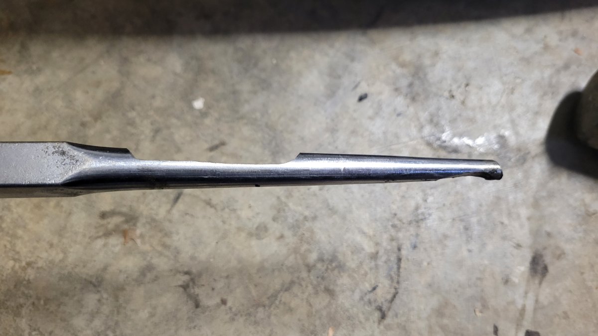

The outer passenger side race was harder to get out than the inner race and only because I couldn't get on it with any tools I had. Inspired by Dan Treace's post from 2015, I went to a local swap meet and bought some inexpensive tools. Then I hit the grinder. The end result was this:
Which led to this:
The next step will be to clean up the hub and insert the new races.
I'm still in the market for a replacement hub for the driver's side. If you have one you are willing to part with, please let me know.

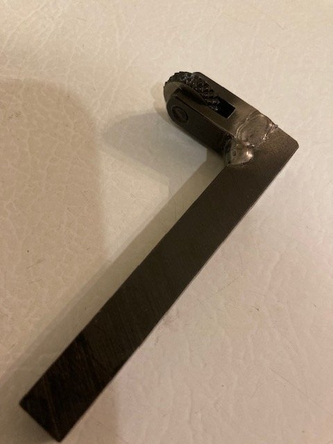

Post by Craig Leach » Thu Dec 14, 2023 1:10 am

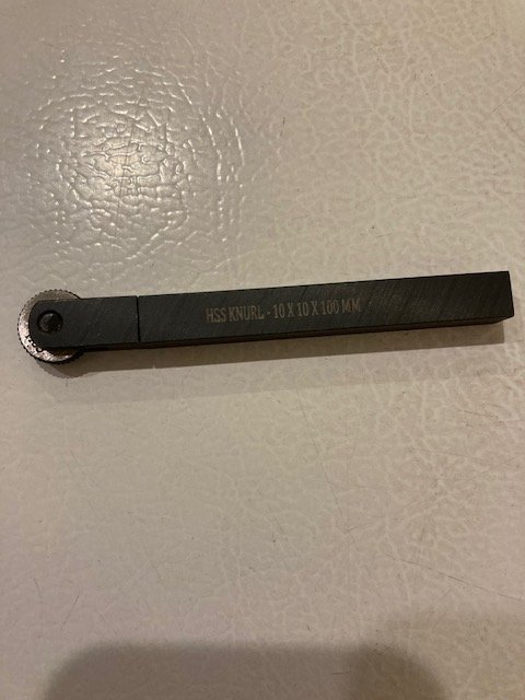

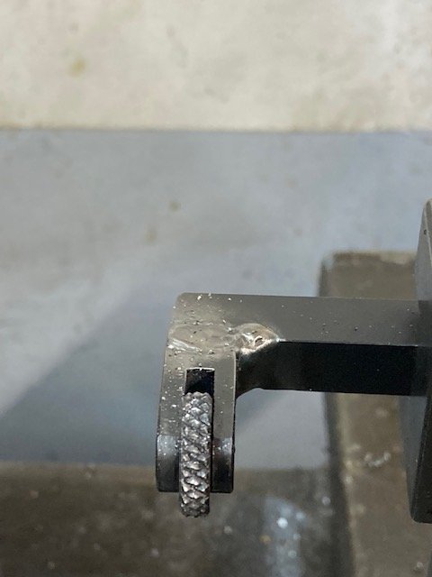

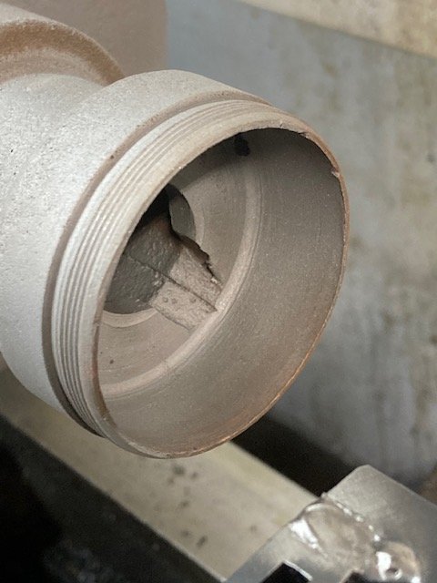

I had a similar situation pop up a little while back when installing bearings in a pare of hubs (not as bad as Dan did ) I found the hubs I was
working on that the outer bearings did not offer the resistance I expected when driving them in. They did not fall in or spin I just thought they
needed to be a firmer fit. I figured I would use Loctite 660 because I have had good success with it on shaft to bearing issues, but thought the
fit was close enough that it would likely displace most of it when installing the bearing. Mack mentioned steaking & Loctite& that got me to
thinking about knurling the hub to get a better fit. I looked up I.D. knurling tools & almost had a heart attach. $200-$300+ so I came up with
something that works for a lot less by modifying a inexpensive straight knurling tool ( (under $25 )it had to be cut & welded to make it a right
angle I.D. knurling tool.(This will only work if you have a lathe or a friend that has one) It's a little tricky to get square but takes little pressure
to make a rough knurl that will reduce the I.D. by .006 most of which will be displaced by the bearing but will give a place to retain the Loctite.
This should be used at your own discretion but if your hub only needs a little help? I would not think this would be a repair for a hub that the
bearing was loose in.
Craig.

Post by Craig Leach » Thu Dec 14, 2023 1:12 am
More pics

I used 609 on my outer races, and they are fine. However, mine had some resistance to spinning, and I'm sure my smallest feeler gauge (.002" or maybe .0015") would not have fit in the gap. The fact was that they were not tight.
.010" sounds awfully big for even a good product like 609. Knurling might be a good suggestion.
