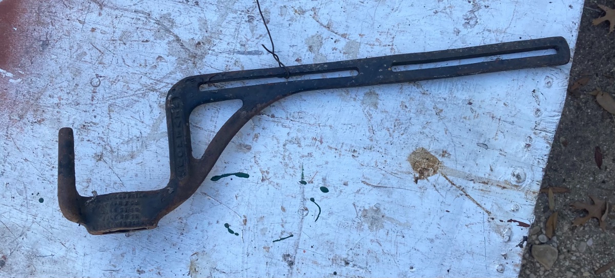

Wayne, All Ford body styles of 1912 were furnished with a rear taillamp bracket bolted to the body (with 2 square nuts). I understand lamps might’ve been optional equipment. At this time Ford made no allowance for a license plate bracket. A few accessory manufacturers found a niche market here. One of which was the Neverout Company like the one in the picture. The vendors sell brass repops like this original forged piece. To mount it, your brass kerosene taillamp must be tooken off so the Neverout accy can slip over the vertical Ford bracket. This new bracket is held fast by a set screw. Now your Ford taillamp can be attached to the Neverout bracket similarly held with a set screw.

Ford did have a taillamp bracket in 1912. Regarding the Neverout bracket pictured above, I like the blade version, which is like what Ford furnished from the factory. The rest of the license plate part is the same as pictured above. Originals show up occasionally, and are usually $75-$100.
