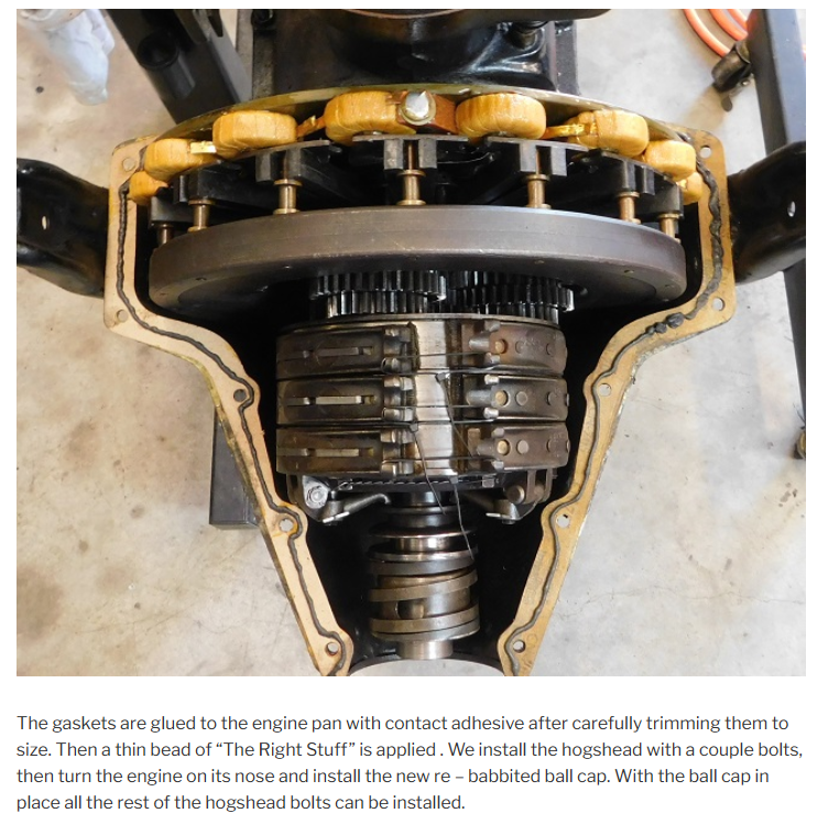

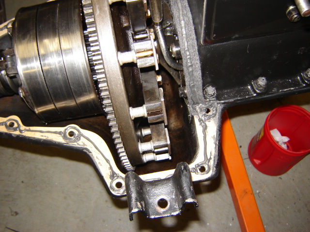

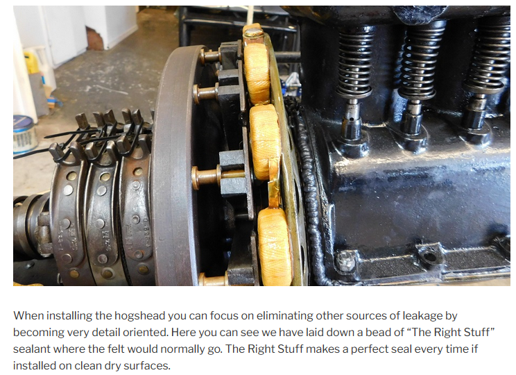

You didn't indicate how you sealed the hogshead to begin with. Globing sealant on the front corners is a must. The rim of the hogs head and pan around the bolt holes may get deformed from over-tightening. It doesn't hurt to put sealant 360 around the bolt hole too
From Ford Fix https://modeltfordfix.com/how-to-keep-y ... territory/ - --
with felt
with felt

Here’s a question.
When you had the engine torn down and cleaning everything up did you carefully check the engine pan (complete crankcase) bolt holes to see if they were dimpled out? This commonly happens with T oil pans, and the oil pan cover.
If the holes get dimpled out they won’t have a good flat seal between the pan and transmission cover and engine block.
Over the years the bolts have gotten tightened and retightened because of failing gaskets and etc. T’s get to be leakers after a while and this happens over time!
When I build an engine I use a good silicone sealant first on the pan and lay in the gaskets and let it set and partially dry to keep in in place. Then coat the corners and the rest with another coat and then install everything else. And a good glob on the trans cover corners!

I "massage" black RTV into the cover felt & let it get tacky prior to installing it. I RTV the crankcase surface as it's not a machined surface like the cover is. I also apply a "blob" of sealant in the corners.

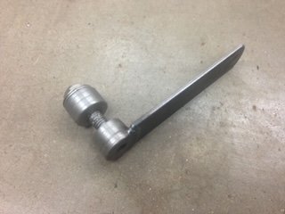

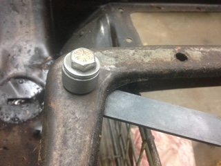

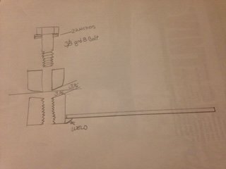

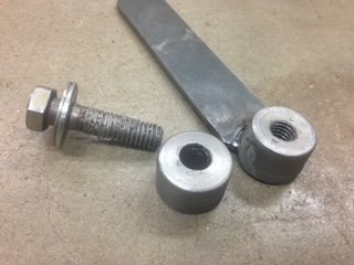

John has a good point also about the dimples. If you hammer & dolly the dimples flat you will need a pan anvil to make sure it is flat after.
I made a simple device to straiten the dimples that can even be used in the car for the pan if the hogs head is remove in the car. Use lots of never-seize no the threads. Takes time but I have never smashed a finger with it.
