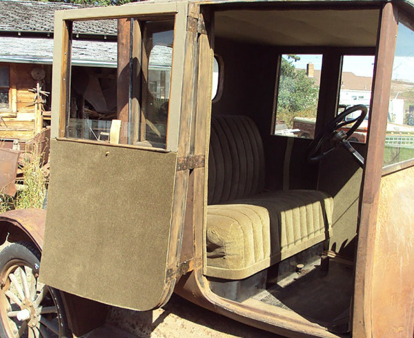

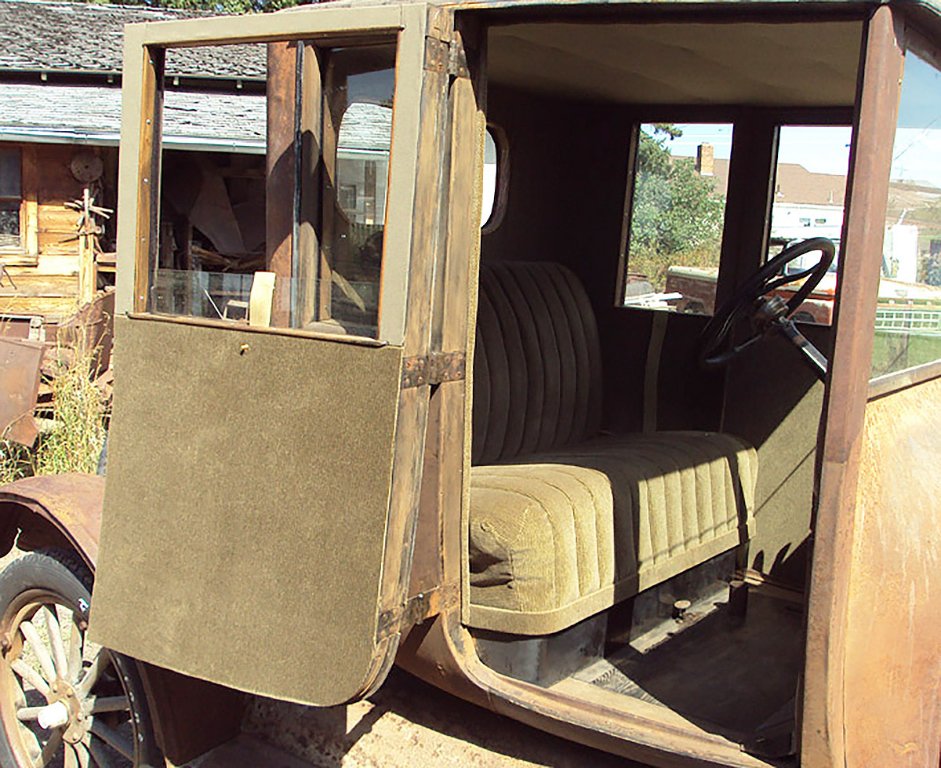

Forgive me people im just recently bitten by the bug and know very little about my new old car.
Newly acquired 1924 Model T Coupe with original interior? maybe.. but showing its age. the doors / walls fabric have water stains. i like the fabric but would love to get rid of the stains. I saw a commercial where pet pee was removed by some product.has anyone had success or even tried anything like this?

In my shop I have had great results on original wool fabric that was stained by using my upholstery steamer on the fabric to loosen the dirt and then blot with a fine towel. You do not rub or agitate the dirt into the fabric, but the steam causes the dirt (which is what you are calling water stains) to loosen from the fiber strands and the towel helps blot it away. It is a very slow and tedious process, and maybe if you use a good quality drapery steamer. If you do not have access to one, maybe find a high-end automotive detail shop that has a steamer and maybe an extractor. Just do proper diligence to make sure they understand the delicacy of your fabric.Barteldes wrote: ↑Thu Jan 19, 2023 5:48 pmForgive me people im just recently bitten by the bug and know very little about my new old car.
