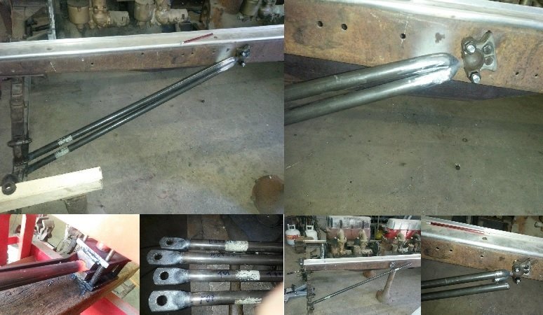

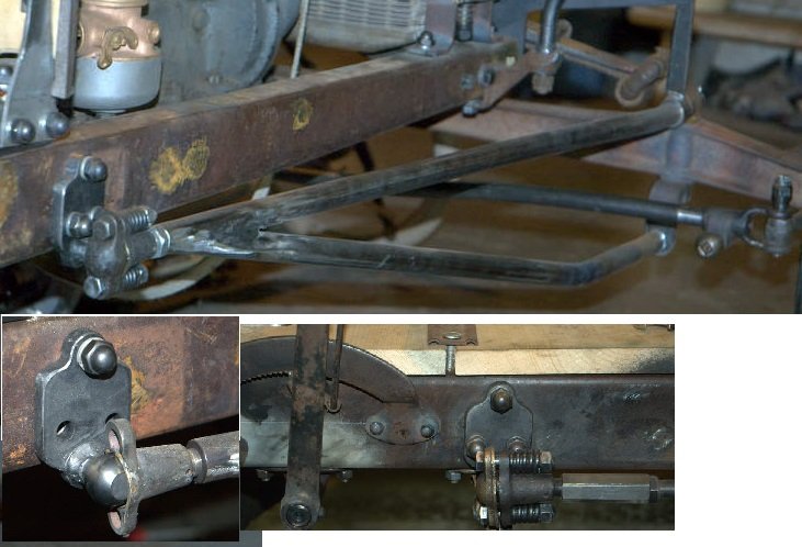

Split wishbones- I had collected ideas for several methods
I plan on using this set. But the interesting part are the brackets that clamp to the frame. Think its possible to make these. The rods can be fabricated a number of ways as well one of the many methods I included for the brackets that attach to the frame. --
This is a set that Hank Lee made that I may need if the one above don't work out. The require the earlier 2 hole perch. --

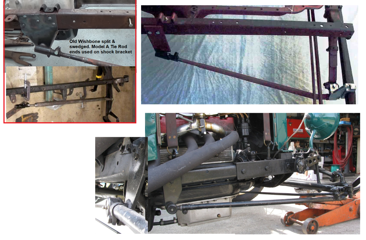

-This is an interesting design where the bracket on the frame is the wishbone cap from the pan and the rods fabricated and swedged into the ball end of a wishbone. -- --
Other options , one using Model A parts
