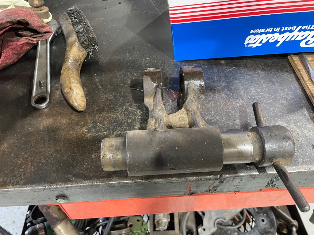

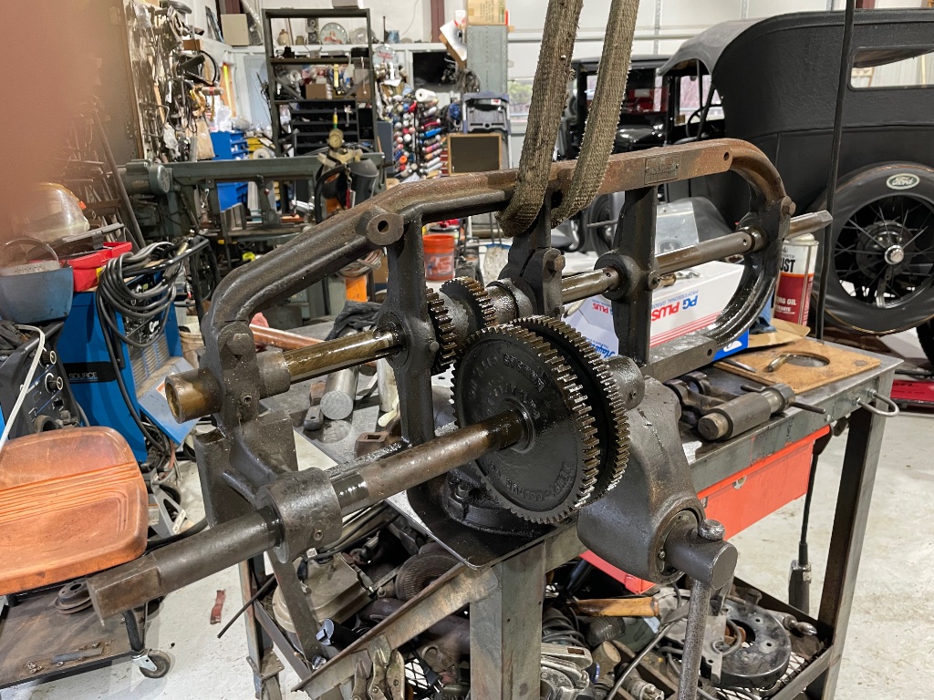

Got it apart
thanks
thanks

Dan I will take some photos and post when I get a little time
