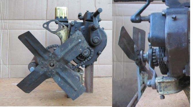

Looking for picture-instructions for Gray Davis Starter have one that was on a 1914 T the Chain that goes from starter to Crank is missing looking for chain or something to see what it looked like Thanks Matt Madison 503-824-2681

The type of chain you want for the starter is called "silent chain". Available from power transmission companies. It will work on gears of different thread pitches and different power loads. More power to be transferred just add more chain width. It has been used in automobiles to earth moving machinery. I have it on my Hienze accessory starter on my 1914 T.
- Posts: 6534
Re: Gray/Davis starter
Good info on "silent chain" on this site and perhaps a major supplier. pricey stuff
This link is a guide to selecting the proper chain
https://ramseychain.com/the-chain-docto ... ification/
