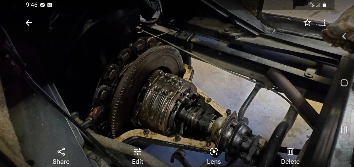

Bought this 25 Coupe today. Going to need some engine work. Engine was good running good for last owner but broke a couple magnets. I'm assuming the field coil is going to be a mess. Previous owner removed the rest of the magnets. He bought a set of splash angles but decided not to finish the project. Debating whether I should try putting the splash bars on and add a distributor or pull the engine and fix the flywheel and mag? Also thoughts about a Texas T outside oil line kit that would line up with the ring gear? Still scratching my head how he managed to get the magnets off with engine in the car?

With the HH off, as shown & the magnets already removed, It would be possible to add slingers as she sits.
If you were going to run with a dizzy, fine.
If you want to run coils, the motor will run much better on mag over a 6V battery.
