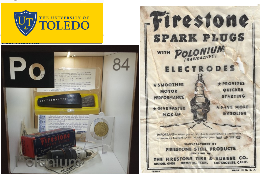

Some info on the danger of Polonium and that the old spark plugs are no longer a danger
https://www.utoledo.edu/nsm/ic/elements/polonium.html
Contributor: Cassandra Pittman
About the Display: The Po display features:
A Firestone spark plug containing Polonium. Polonium was used, specifically polonium-210, to improve electrical conductivity and allow a larger spark gap. In theory, this meant that there would be a more complete combustion of fuel. The original patent for radioactive spark plugs was approved in 1929 and was actually written for radium. The patent for the Firestone spark plugs was approved in 1941. Polonium ended up being the radioactive element of choice since it was safer than radium and more effective than uranium or thorium. The spark plugs were only manufactured for about 3-4 years in the 1940's, though, since the benefits were minimal and short-lived. Polonium-210's short half-life of 138 days and the inevitable build-up of deposits on the electrodes, which prevented the polonium from interacting with the gas, are what lead to the demise of these radioactive spark plugs. The polonium in the spark plugs is no longer dangerous, due to the short half life. For more information, visit https://www.orau.org/ptp/collection/con ... kplugs.htm

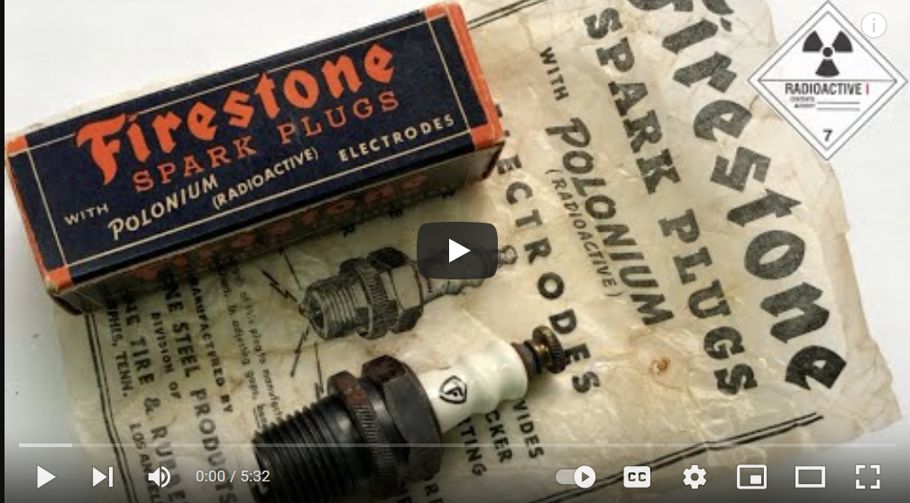

Neat Youtube about them https://www.youtube.com/watch?app=desktop&v=pBHmScF7-ww

They came in Pink and White and are marked Polonium
firestone supreme.png (595.72 KiB) Viewed 2624 times
