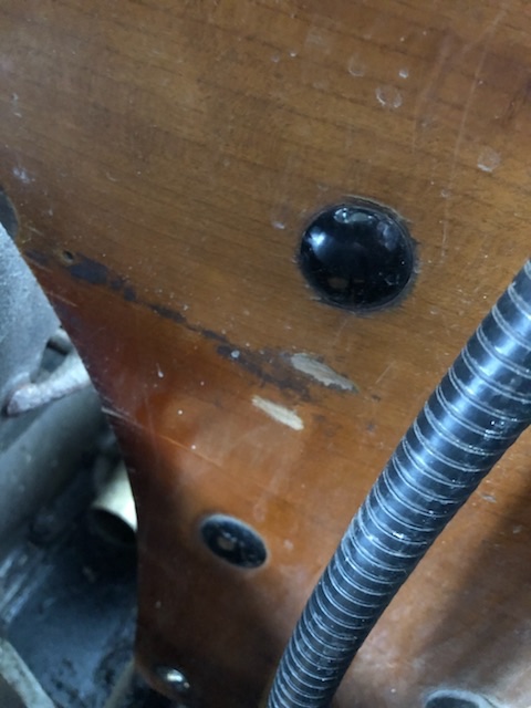

Post by Rich P. Bingham » Fri Jan 27, 2023 12:34 pm
Perhaps I shouldn't reply, since I bought my Lizzie as an older restoration. I can't vouch for the originality or authenticity, but what she's carrying to bolt dash to frame supports are the same 5/16" step bolts used to bolt the dash to the body brackets. Perhaps my running board bolts are wrong ? They appear to be a common 5/16" carriage bolt.
Of course period bolts are different from modern hardware - generally more robust. Also note the hex nuts are 9/16" OD and "thick".
Hope this is helpful.

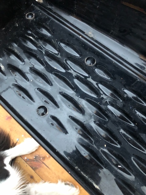

Post by Rich P. Bingham » Fri Jan 27, 2023 12:35 pm
My running board bolts.

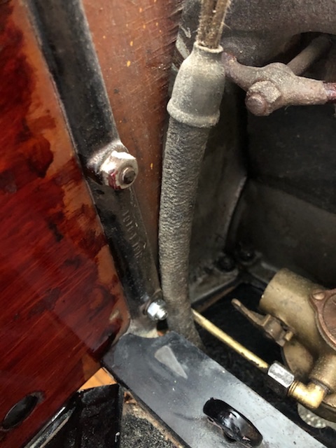

Post by Rich P. Bingham » Fri Jan 27, 2023 12:40 pm
Going over Lizzie for winter R&R I was annoyed to find the dash-to-frame bracket bolts were 'way loose on the passenger side, and I'd lost the bottom one. Photo shows the difference between period nut and the chintzy modern replacement (1/2" OD).
These nuts are pretty well hidden by the hood former, my excuse for not noticing they'd loosened up. :o

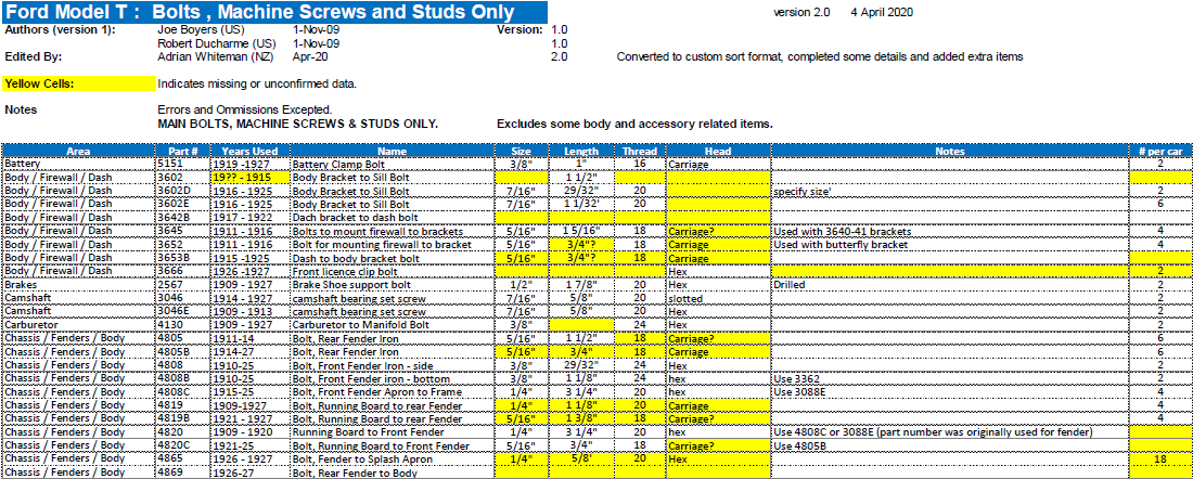

Post by TRDxB2 » Fri Jan 27, 2023 1:10 pm
Hope this helps CLICK on the Image to zoom in
