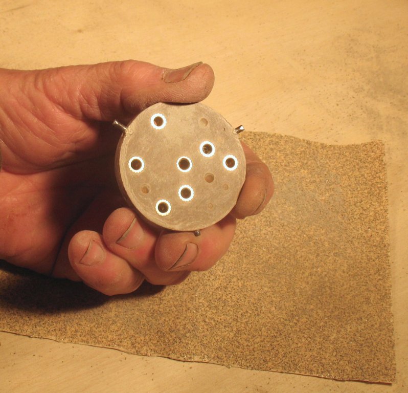

Yes, turn those tabs red and let them cool so they will bend back without breaking. Sometimes the problem in the switch is a warped backing plate. Often that's an easy fix that doesn't require replacing anything. You just flatten the plate on coarse sandpaper. If that makes any of the dimples too shallow you can deepen them with a drill bit.
Some switch back plates are held by tabs and others have pins, because they were made by different suppliers. If you do end up having to buy a new backing plate you may need to file a slot or two to make the tabs fit. Again, different suppliers.
