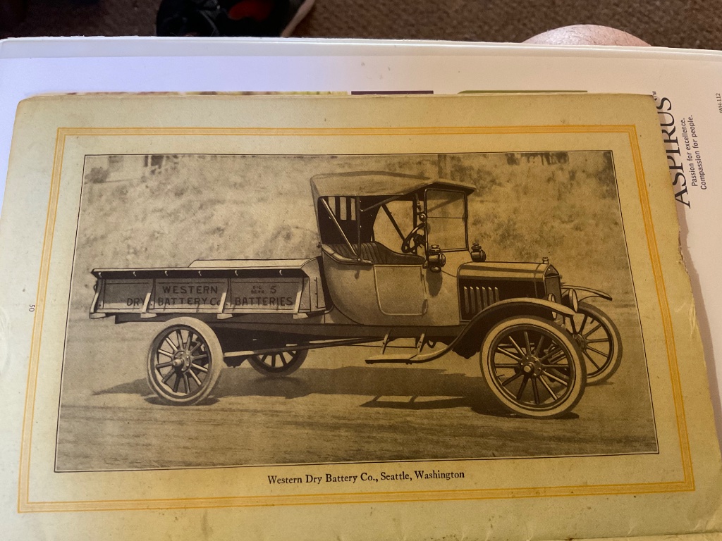

What body?

Roadster set on TT chassis

I agree with Matt on that, but I don't believe I've seen that done before. Interesting indeed.

Early production TT's were sold only as a chassis and the buyer or dealer could put on their own cab and bed ranging from home made to commercially available after market bodies. Ford wised up and by 1924 the TT could be bought as a chassis, or with an open C cab, or closed cab, with or without a stake bed or express box. Of course, someone could repurpose a car body and put it on a TT chassis. All the body brackets except for the firewall, I believe, are different for the Truck cabs and car bodies, so the TT frame body mounting brackets will not line up with car body mounts. I agree the roadster body makes a nice looking TT, and would be a lot more comfortable for the driver and passenger too.

I'd like to have one just like it.

We had a local fellow install a steel C-Cab & '25 p/u box on a car chassis - quite unique.

Steve, a lot of guys are making Frankenmodel Ts like that. Too bad. I’ve had 3 Ford steel cab TTs -2 enclosed and 1 C Cab - and, although those body styles are hard to find, TT rear ends and frames are plentiful and almost give-away items.

When I bought my 1921 coupe, it was a toss-up between it and the TT with a roadster body sitting next to it. Coupe won. The finish on the above setup is nicer than most TT's that got a roadster body. The frame that would have been under the T deck is extended back under the bed and looks finished.
