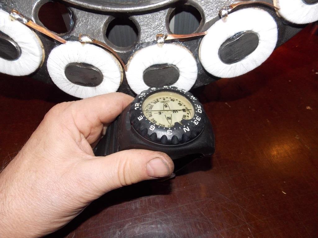

Magneto coil wrap?
Topic author - Posts: 5504
Magneto coil wrap?
Was the magneto coil wrap cotton or linen? Has anyone tried wrapping their windings with 100% lite weight cotton twill?
Comes in 1/2" too.
https://www.twilltape.com/lightweight-1 ... yard-roll/
Comes in 1/2" too.

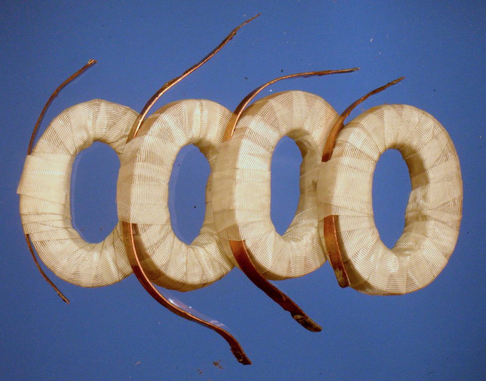

I've never wrapped mag coils but have done a bunch of starter coils and my go-to was cotton twill and then impregnated in polyurethane. They come out beautifully. The way the tape is woven you can get a really nice "lay" with no wrinkles and tight wraps if you are careful.
I switched to black tape as soon as I proofed my process:

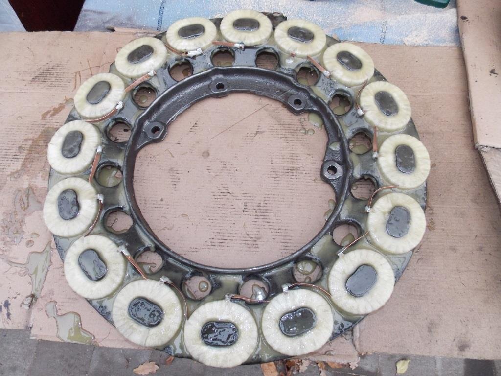

I used fiberglass tape from an electronics store and after assembling everything, I coated everything with boat resin from a local marina. I have two of the ones I rewound in two of my Model T's for about 20 years so far no problems.
I followed the instructions in the booklet "Electrical System" published by the club.

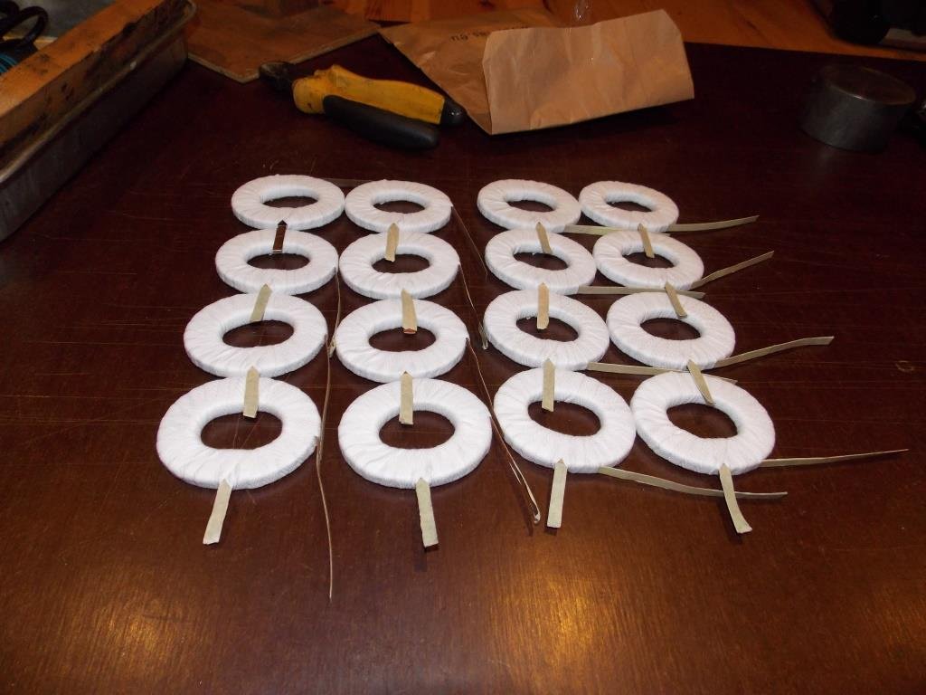

Re: Magneto coil wrap?
Ordered the white and plan on sealing with the Glyptal varnish. Darn, Snyders is out of stock on the insulators, so guess I will have to make my own!
