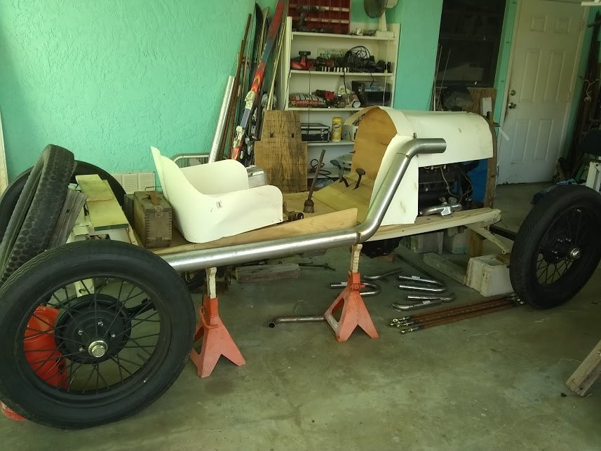

I would recommend changing out to a different steering box and not retaining the stock T steering. Dropping the rear can be done a few different ways and some can work with certain body styles and not with others. Having said this here's what I did. The front can be much easier to dial in than the rear as you can play with it up and down depending on those little bits (later spring, later spindles, chevy spindles, inverted eye etc) where you can gain or lose a half inch-inch. I opted for a rear Z but not massive making up the rest of the drop with a "bent" spring. On the front I used similar to a laurel bracket but allowing for a 4 link setup. The drop in the rear is "set" so as its assembled and weighted down I will be able to play with the front to bring it up or down so it all lays right without looking like a massive drop.
