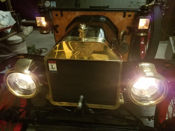

LED Light lamp to replace carbide headlight? I would like to install LED lamp in a carbide headlight. Where can I find bright ones?
Here is a picture from Lang to show what I want. These sold by Lang are too dim according to their description. Looking for something brighter.
[EDITED]
I did not mean that I was impugning Lang's product here is their copy with these lights
"The LED bulbs are not as bright as the original carbide bulbs or some of the halogen bulbs that has been offered over the years. They will be able to be used to get some light out of the car but if you are planning to drive at night a brighter bulb is suggested."
[EDITED]

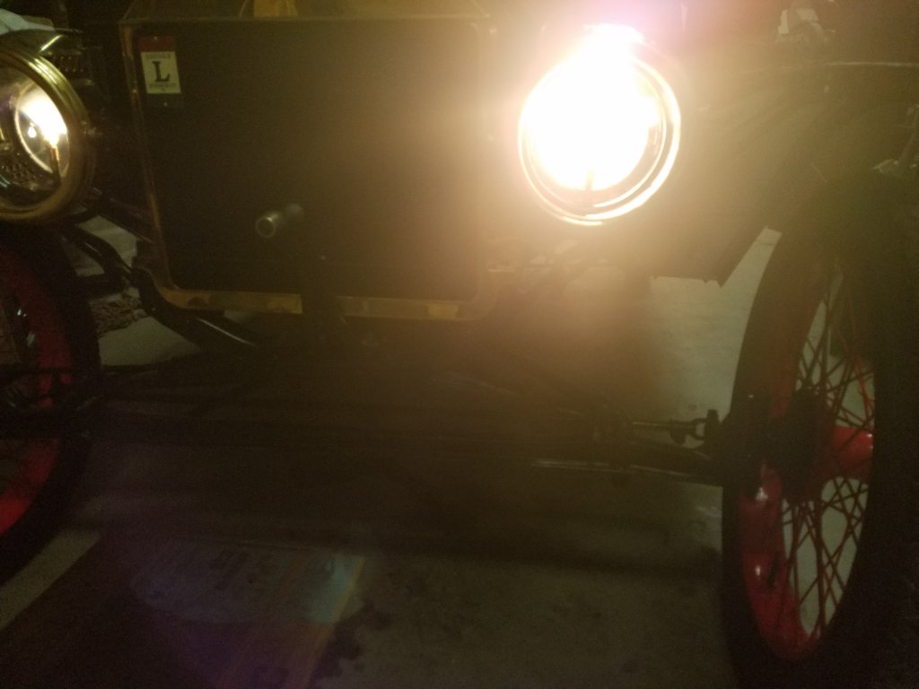

I think "too dim" is an arguable statement. I have some of Tim's LED lights just like in the picture in my 1914's lights, -and they are great for in-town traffic coming home from a show or dinner where street lights also help illuminate the way. In a rural area without any street lights, most would agree they are probably not enough light HOWEVER I'm sure we all agree they are a vast improvement over the lumens created by just a carbide flame.Catbird wrote: ↑Sun Feb 05, 2023 10:29 pmLED Light lamp to replace carbide headlight? I would like to install LED lamp in a carbide headlight. Where can I find bright ones?
Have you considered temporarily adding an auxiliary LED driving light under each fender, or possibly temporarily mounting a small LED light bar onto the front axle? The size wiring required for this is very small and could be discreetly placed when not connected to the light(s). Harbor Freight and other places make some very strong magnets that would be perfect for temporarily mounting auxiliary driving lights to these locations on your T to supplement the Brass lamp LED lights.

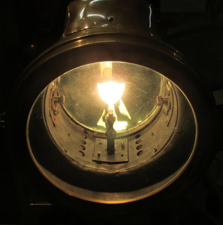

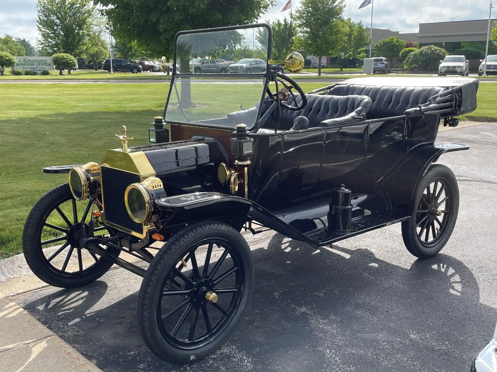

I tried using those LED lights in my 1914 Touring car and they were not very good. It did not help that my headlight mirrors were also scratched up. If I was on a country road with no traffic going slow they were OK, but as soon as there was a lot of traffic the only thing I could see was the light from other cars.
I replaced those LED lights with the Headlight Quartz Conversion Kit and they are very bright.

Bryan, I really like the quartz bulbs. Will get some. I see these are 55watts. I am updating wiring in our several Model Ts and I want to see and be seen! "Seen" is in the case of people see me and don't run into me!wrote: Make sure you run wires and fuses that are heavy enough to handle the load of these bulbs. After they are properly set up and adjusted they work well and very few people can even tell you have bulbs in your headlights. Last October I drove my Model T to work and had to go out to a client location after work and was there until well after dark. I had to drive almost 30 miles in the dark to get home and the first 15 miles had a lot of traffic. I was grateful to have bright headlights, bright tail/brake lights and bright turn signals. Bright turn signals are really nice at night when you are changing lanes. No one would have even been able to see my arm out the window.
So where did you get the sidelights and tail light bulbs/sockets? Your link about the quartz lights is wonderful.
Will have turn signals in sidelights and tail lights.
I am looking at these ceramic sockets for quartz or LED
https://www.amazon.com/dp/B07CXL6MLD/re ... RydWU&th=1
Here are some bulbs - LED warm 50 watt halogen output
https://www.amazon.com/gp/product/B07S1 ... C4VN3&th=1
Quite a few halogen bulbs if you like these and fit the above sockets, ordering and will get back to you.
https://www.amazon.com/Halogen-Replacem ... 59&sr=8-10

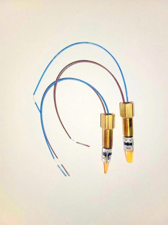

I am the one making the LED kits . new brighter bulbs have been found Langs should have them in stock now. If you would like the new bulbs please get a hold of me . Old bulbs were 2w equal to 20watt halogen bulb. The new bulbs are 5w equal to 50w halogen . Plus the LED bulbs draw a lot less amps, also the LED bulbs are replaceable if they burn out. Some people like the warm glow of the 2w as it looks original and some people want the super bright for driving. The reflectors play a big part in any type of bulb used .
