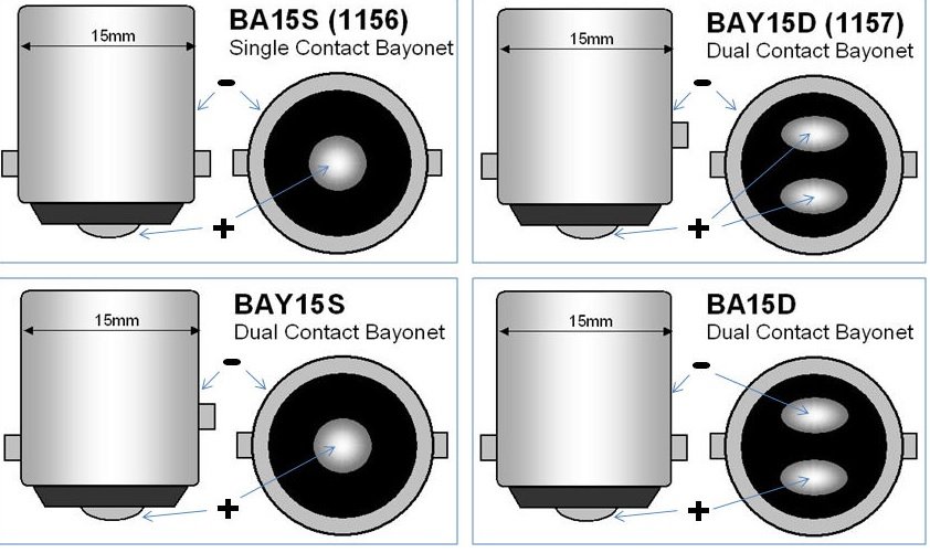

LEDs are polarity specific, as they have a positive and a negative contact. Most modern light bulbs have a diode bridge included in the bulb so the connected polarity will not affect the LED operation. Meaning, the "bulb" is NOT polarity specific even though the LED IS.
Having explained that, it would appear one of the bulbs is having a polarity problem. Either the bulb does not have the diode bridge or one/some of the diodes may have failed or are installed incorrectly. I recommend starting with one bulb, test it to ensure it works. Then, swap bulbs to see if the other one works. If so, it would appear there may be a wiring problem but, if the diode bridges are working properly, it shouldn't matter. IF the second bulb doesn't work, then you know where the problem is. Second, when two are installed and one is not working, just swap the bulb places and see if they work then.
Still having problems; contact the seller for replacement or refund and try a different bulb or bulbs and/or a different brand.

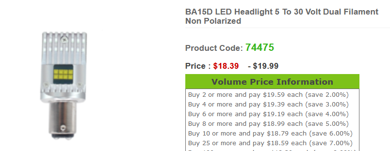

I'm guessing this is the bulb in reference https://www.ledlight.com/led-headlight- ... rized.aspx For positive ground or negative ground. 5 to 30 Volt wide voltage. Long life up to 30,000 hours. Made with 2525 LED's for long life. Dual filament up to 1200 Lumen low beam. Works both in a socket that is wired for a single filament and works in a ba15d socket that is wired for dual filament. Up to 1800 Lumen high beam. The base is BA15D the diameter is 15mm with two contacts on the bottom and parallel bayonets.Matt in California wrote: ↑Fri Feb 03, 2023 11:41 pmI decided that I wanted to give LED lights a try. I purchased 5-30 volts non-polarized bulbs. When they arrived I installed the first bulb and it light up nicely, but when I installed both neither worked. I tried again with one LED and one incandescent and it worked. One incandescent alone also works...

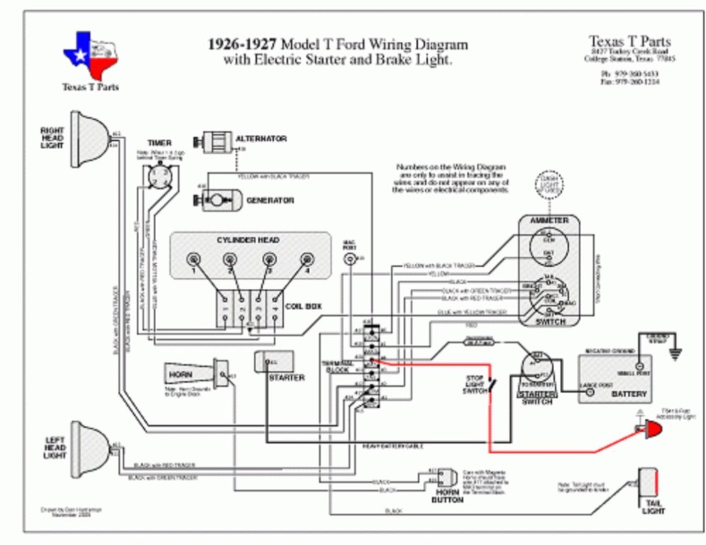

What isn't at all clear is how you are hooking these up. The wiring diagram shows that they are hooked up in parallel so each bulb is independent of the other. If both bulbs are good and work on one side and not the other then there is an issue on the bad side (ground, socket and/or wire connection). Something else too, even though they are non-polarized, you might try reversing they way you inserted the bulb that doesn't light in its socket. The reason for this is that even tough they are nob-polarized (for voltage) they are dual filament so both need to be oriented properly in their respective sockets for your High/Low beam to work equally

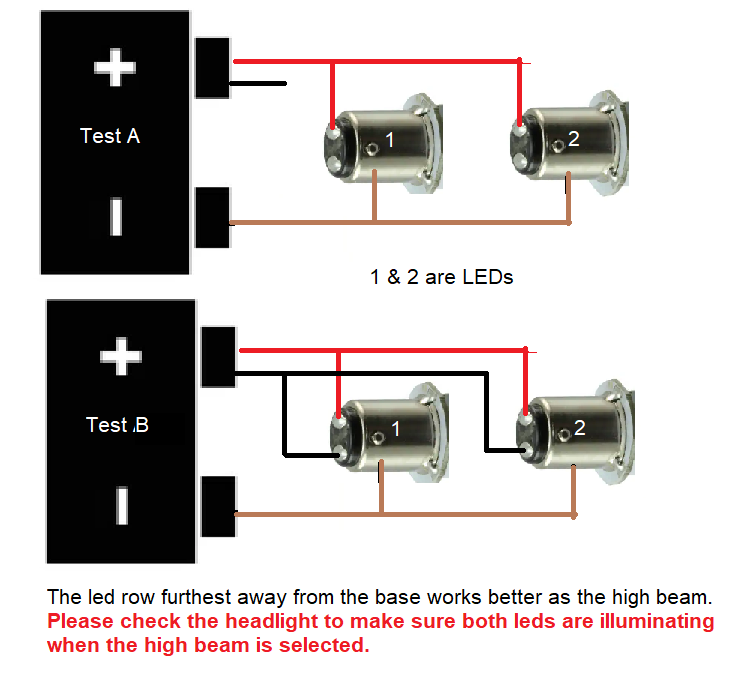

I appreciate all the responses! I will try to be clear as possible to clarify what I am experiencing.
Set-up:
-Yes, These are the headlight bulbs from LEDLight.com
-The headlight bulbs are connected in parallel on 12vdc battery.
-I tested and get 12vdc at bulb.
Test 1: Remove one incandescent bulb and replace with LED bulb. Single LED lamp works fine.
Test 2: Two LED lamps. Neither light up.
Test 3: Remove one LED lamp. Other LED lamp does not turn on.
Test 4: Replace one bulb with incandescent that has one filament burned out. LED lamp does not turn on.
Test 5: Connect one LED directly to battery with wire. LED lamp does not light up.
I hope this clarifies things.
Matt

if you connected one of the LED bulbs directly to the battery and it doesn’t lit up. i’d say it’s burnt outMatt in California wrote: ↑Sat Feb 04, 2023 5:54 pmI appreciate all the responses! I will try to be clear as possible to clarify what I am experiencing.

It would be better to address the leds by number to better understand which is which. Note that the directions for LEDs state "The led row furthest away from the base works better as the high beam. Please check the headlight to make sure both leds are illuminating when the high beam is selected. Just one row of leds on both sides light when low beam is selected" so this may or may not have something to do with the problem.
I diagrammed some tests. If one bulb does not light , reverse it in its socket. Your testing with an incandescent bulb is pointing to this as the possible problem. Since things are connected in parallel each bulb should be working independently of the other. If they were connected in series then as Susanne stated one would affect the other

Okay, I figured out my problem! And I don't feel like the sharpest pencil in the pack! I ordered the wrong bulb and didn't read clearly or understand what I purchased. Here is what I ordered:
https://www.ledlight.com/ba15d-led-head ... rized.aspx
When I saw Frank's post, I didn't notice the small, but important difference:
The price and image is the same... I assumed dual connectors on the bottom would mean dual filament. To get these working I figured out on my own as clearly stated in the instructions: "1142 Configuration meaning ground on one contact and 5 to 30V on the other contact." BTW if you are trying to figure out why it worked with the other headlight installed, the second filament of the incandescent headlight give a path back to ground.
When I went to make the order I was dizzy reading all the descriptions and restarted my cart more than once.
I appreciate everyone's' patience and insight! In the end the issue seems to be the nut behind the wheel.
Matt

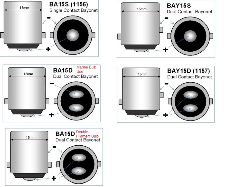

Matt, what your order, BA15D - 1142 Bulbs are referred to as Marine bulbs. Easy mistake to make.
BAyonet base: 15 millimeter diameter: Y offset pins (no Y = parallel pins) : Single Contact:Double contacts
Model T bases are either BA15S or BA15D. Currently many filament & LED bulbs for BA15s/d sockets are described as taillight, brake light bulbs and 1156 bulb. (1157 bulbs take the BAY15D socket). So that's one of the reasons why those bulbs aren't bright enough for use in Model T headlights.
6v 1158 filament bulbs are dual filament, consume about 3amps and not very bright.
Note the diagram below from a manufacturer is a bit confusing so I am added another further down in this posting

Frank and others: Thanks for the information.
Frank, is the figure in your post from a bulb manufacturer? It shows pin arrangement, but the BA 15D base contact polarity must be a typo, I would expect base and pin contacts to be same polarity as the for the BAY 15D?
It's small things like this in what I assume are Chinese to English translated specifications that sometimes steer the buyer to the wrong conclusion/wrong purchase. Just a rant, YMMV, jb
- Posts: 6541
Re: LED light issues
Yes the picture of the bulb bases above is from "a" manufacturer. It is unlikely case has a connection to one of the contacts on the bottom of the socket. Likely they artist was referencing the type bulb connections vs the socket. New BA15D sockets have just 2 contacts & its up to the type of bulb to decide its ground position (as you have found out). "Marine bulbs" or bulbs wired in series like Model-T's with a dimmer.jab35 wrote: ↑Mon Feb 06, 2023 9:35 amFrank and others: Thanks for the information.
Let me know if this revision makes sense

Thanks, Frank:
Your edits/corrections make it all good. When I see an obvious error like this in a technical spec, I immediately wonder what other 'lies', intentional or not, are being told, and how many of them I've accepted as fact. The 'fact-checkers' on the forum have filled in gaps and corrected false information in many similar situations and I appreciate that. Best, jb
