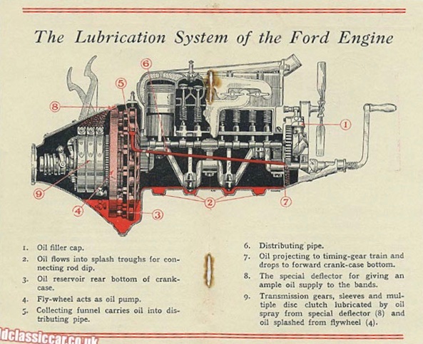

So, only the crankshaft thrust bearing would see increased wear with the car standing still and idling in neutral.
- Posts: 5129
Re: Idling in neutral for extended times, is it an issue?
The thrust bearing surface is not seeing any pressure from the clutch spring. There is near neutral pressure.
The only force to the thrust is that created by the magnets pulling the flywheel into the field coil.
So idling in neutral is way easier on the thrust surfaces without the added clutch pressure.
T motors use a splash oiling system. There is plenty of oil being moved around internally as designed.
The only issue I am aware of is transmission bushings tightening/seizing if run in neutral after a recent rebuild with to tight in the clearances.
But seizing was inevitable anyway.

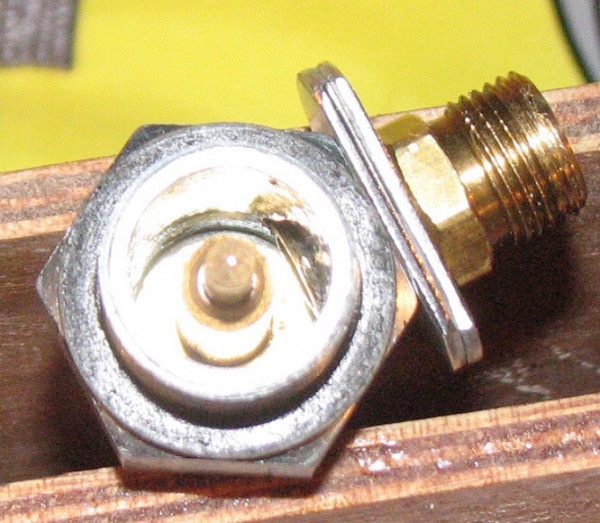

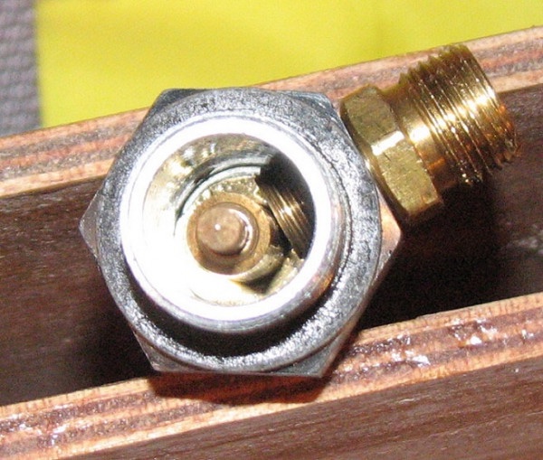

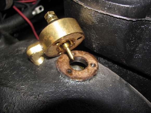

Below is a comparison of other's testing, and the outside magneto contact type oilers do perform well in my experience.
Birdhaven-Texas T Parts makes the High Capacity Outside oiler that mounts on the hogshead, they tested it to a std. magneto plug style outside oiler.(data on their website) and of course the High Capacity hogshead oiler out shines all others to deliver a massive amount of oil to the front of the engine.
The std.type (pictured below) Magneto Contact Oiler, tested at idle speed, puts out 32oz.(1 qt.) in 3 1/2 minutes. (Birdhaven test, Est. 500 RPM)
The later style large funnel Ford internal oil line puts out 16oz.(1/2 qt.) in 2 1/2 minutes. (Ford testing @ 500 RPM)

The Texas T style oiler moves a LOT of oil, even at hot idle. I found it necessary to restrict the flow on mine by about 50% to avoid over-oiling the engine.
