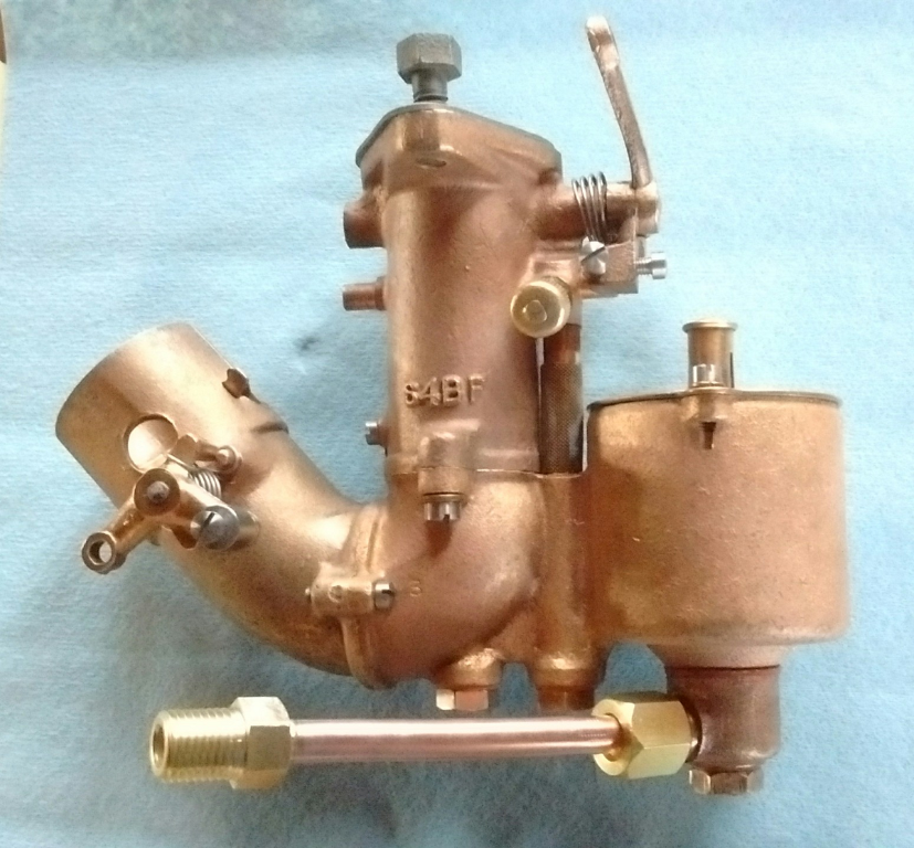

I was wondering if anyone has any kind of instructions or directions to dismantle, clean and test
the S4BF. I have cleaned the outside and inside the float but was wondering what I would run into
if I started to take it apart and clean the inside. Also, is there a way to test it after to see if fuel is
getting through it.

Assuming the pot metal venturi is intact (which is a bit of a longshot), then separating the top casting from the lower casting may well lead to damage to it. I would not suggest separating them for that reason (plus there is little to be gained in cleaning even if you do). The only reason there would be a benefit to that is if there was no intake screen for the idle circuit. If it's there, then you're good.
If you hook up fuel to it, it WILL fill. I say that because there is every reason to believe that right now the float valve tip has a ring worn in it and the seat is similarly worn. If it runs, it runs. If it sits, it will likely overfill and drip.
They were made to specifically be a FORD accessory carb and as such, SHOULD be jetted for a "T". Unfortunately, Model T's now exist in a myriad of configurations be it cams, high compression heads, etc., and you may find that it is not jetted correctly.
As for adjusting, the jets determine the high speed richness and the little downward pointing knob is the idle adjustment: unscrew it and it leans out, screw it in and it enriches it.

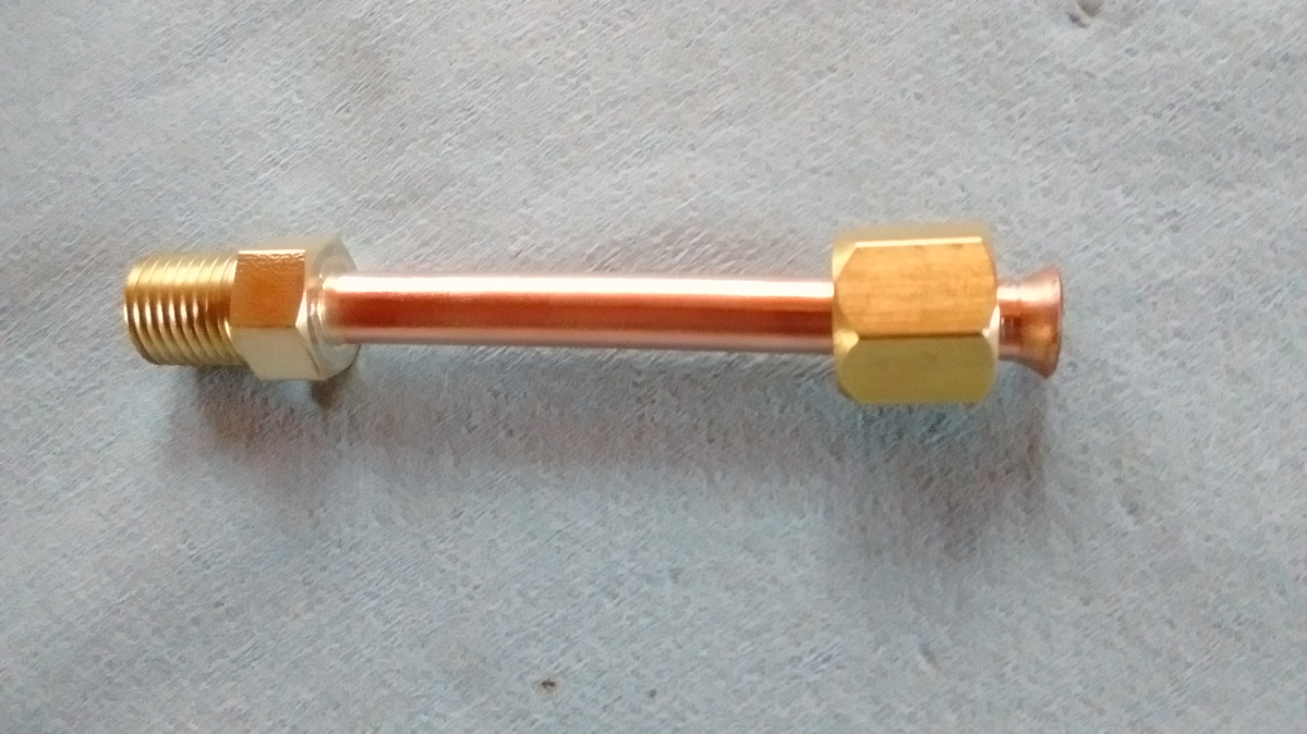

BTW, nearly every S4BF that comes along lacks the correct fuel hook-up. That fitting on the carb takes a 5/16 flare (5/16 copper pipe about 5" long with a Model T specific fuel fitting on the end).

Hi Scott,
are you still making the fuel line?
thank you , John

Re: Zenith S4BF Carburetor
John
I haven't made any for about a year and I think I'm out of stock...I'll check
I'm out of stock but may make some this summer
