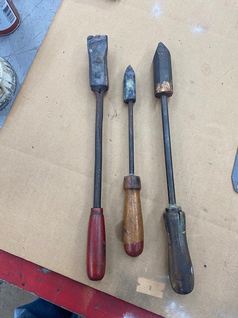

If it is an electric iron, or one heated on a fire which is away from the tank, you should be OK, but a torch or arc welder, is a no no.

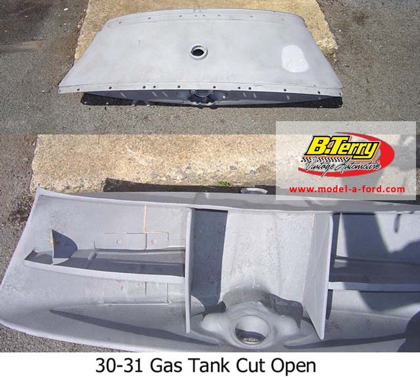

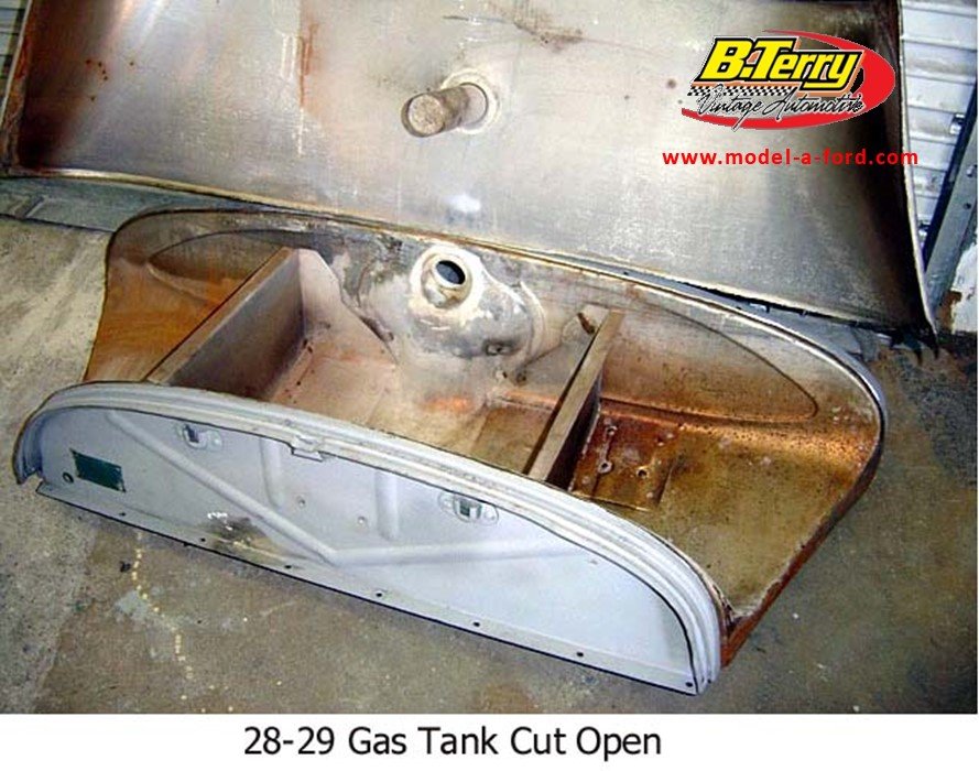

We use a flame to weld on gas tanks all the time when making repairs. While I am not implying this based on above comments, I have found in listening to folks' concerns, it is that generally people who give advice about not welding on fuel tanks have never done it themselves and typically are working off of hearsay. They have read about it on social media site, or saw a picture somewhere depicting a gas tank was welded on and blew-up the whole building. The percentage of gas tank that "blow-up" compared to ones that are successfully welded on is very, very low. So below is how we successfully do it.
To begin with, drain the tank of all fuel. Next, thoroughly wash the interior and exterior of the tank using water and Dawn dish soap. On areas you cannot reach with a brush, fill the tank with soap & water, then use compressed air on a piece of brake line tubing to agitate the soapy water. Repeat this process until you can flush and only clean water exits. Remember, it is the fumes that ignite. The water has flushed away 95% of any residual fuel that can make fumes. The water has also banqueted what remaining fumes might be lingering. Place the compressed air back inside the tank thru the outlet port and have the fill-port open for the air to escape. Use a soft torch flame on the outside of the tank and move rapidly starting near the outlet port and moving over the entire exterior. This flame will warm the tank enough that the water will begin to evaporate and any remaining fumes are evaporated and displaced in the compressed air. Once the interior of the tank has been purged of the water, the gas fumes are gone too. This entire process from beginning to end will take about 15-20 minutes. The reason for needing the tank to be totally clean and purged of moisture is so the flux will not be diluted as you are prepping for the solder. You cannot 'over-flux' in this since this is the key to having a successful repair.
And, ...I know some are going to say that I am hiding behind a computer screen making up advice. Below are a few pix of tanks we have done in my shop. We are the largest restorer of Model-A gas tanks, and as of a couple of years ago we surpassed the 300 count of restored tanks. This number does not include the stray off-brand auto and tractor tanks we have done. So using an open flame from my experience is the prefered and much superior method to make repairs on a tank.

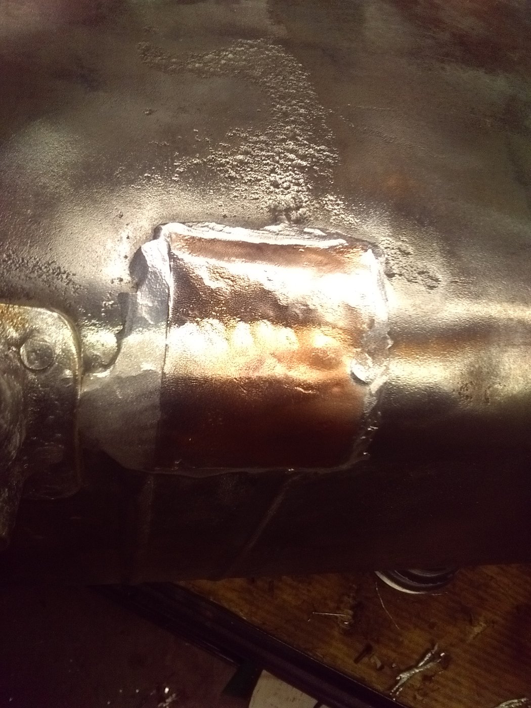

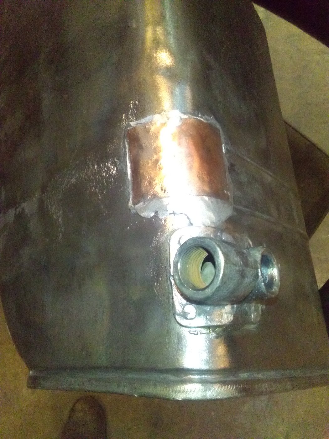

The tank on my '10 leaked around the outlet. On the advice of a friend I drained the tank, let it air out and then hooked it up to the exhaust pipe of my modern car and filled it with the fumes for about 15 minutes. I was then able to solder it with my torch without issue. Don't know if I was just lucky or that method is safe. Unfortunately it started leaking again after about a month and my second attempt was equally short lived. I finally gave up and bought a new tank as they were still available at the time from the vendors.

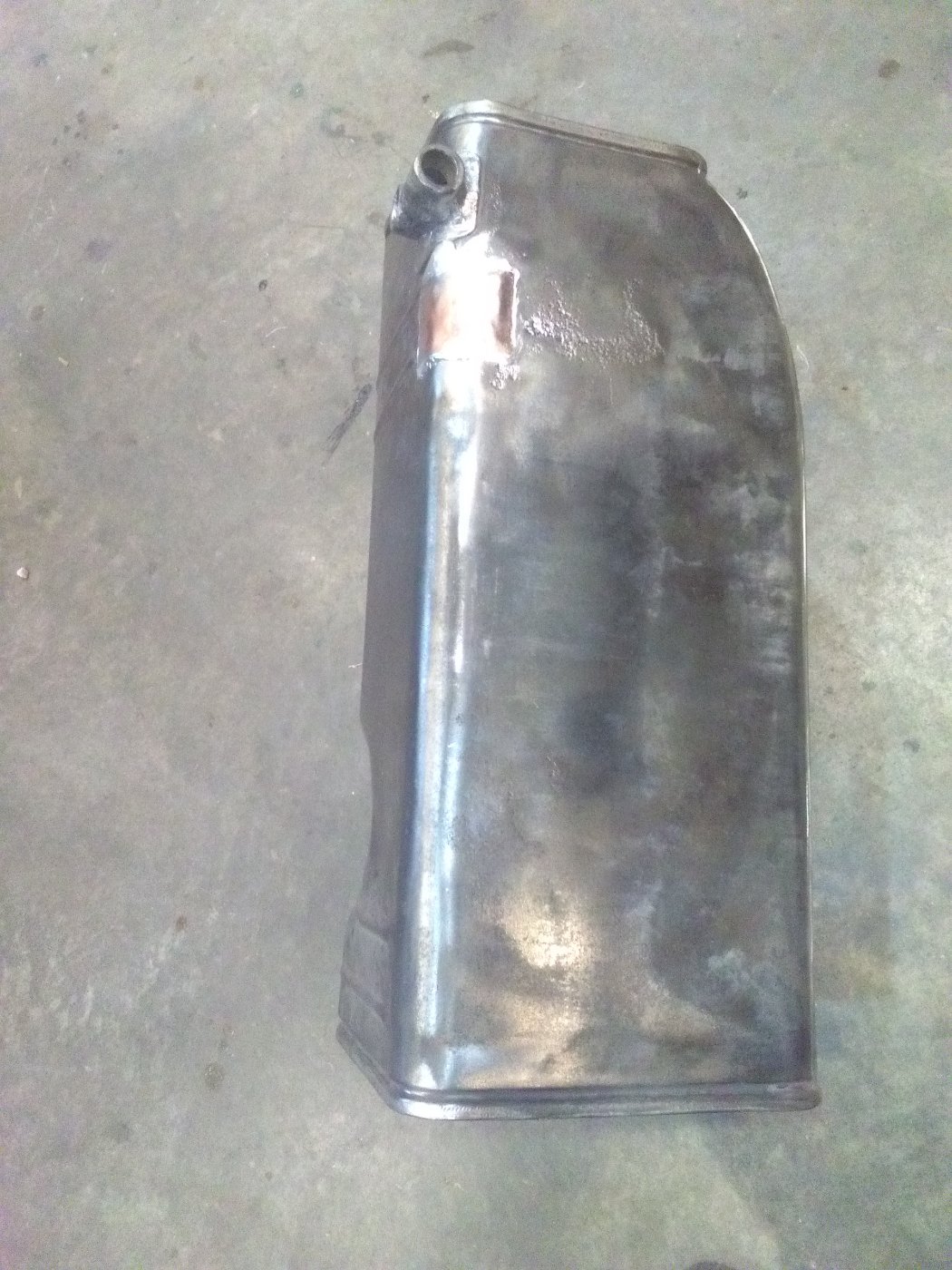

This 26 tank had been in a barn loft for no telling how long. I soaked it in a electrolysis tank for 2 weeks. I had no issues using a propane torch to solder this copper repair patch to it.

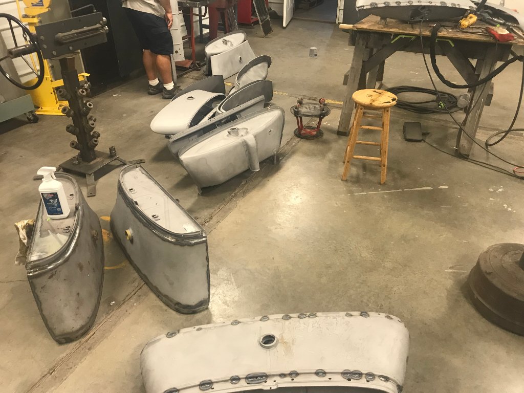

I’ve done both procedures to gas tanks in the last few years. Brent has outlined a perfectly safe procedure, but using the epoxy was sure easy. I stopped gas weeping from pinholes in my round tank with a light smear of J.B. Weld and a little sanding. Is it advertised as gas proof, can be painted and the one time repair has been working for nearly four years now.
Solder repairs to a cowl tank outlet were difficult to get clean enough since the crack was from the inside out through a thick section of the old solder. Varnish kept oozing from the crack and flooding the area with liquid flux kept cooling it off. I also felt like the tank needed to air out for a week after repeated washing and ran an air line while soldering with the torch. So after a week and a whole day that repair re-opened during assembly and had to be redone, where the epoxy just had to dry overnight after a good scrub and drying with compressed air.
I don’t mind doing things the long way and If I had two tanks and extra time I’d go for the torch repair, but if I was trying to drive the car sooner than later I’d at least try the epoxy fix as it is easy to remove if it doesn’t work. -Chris, in Boulder

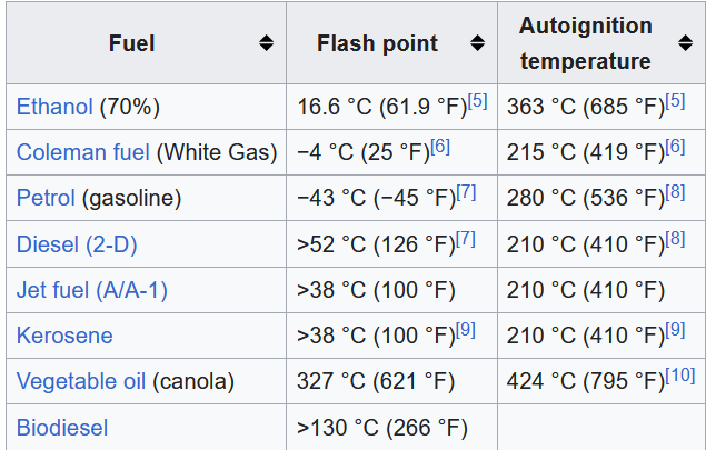

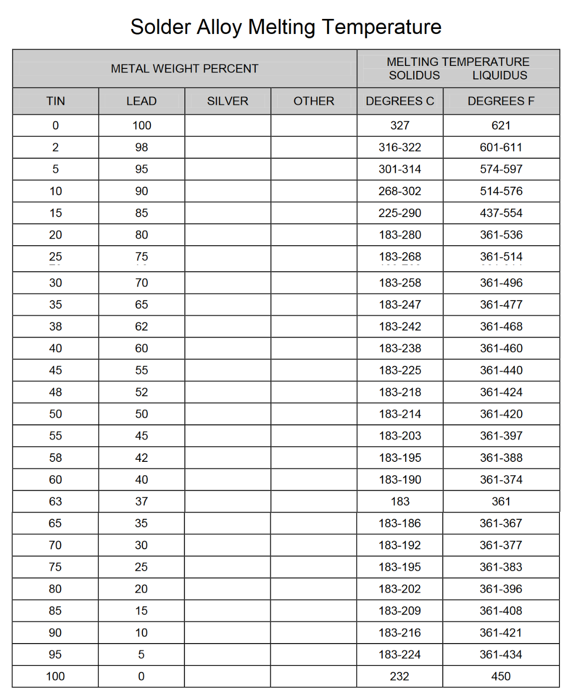

Think we need to put the arguments on repairing a gas tank in the proper perspective.
As stated, several times, the danger of an explosion is the presence of fumes in the tank not in the method of repair.
So the amount of heat applied better not be equal to the flashpoint of the vapor present.
From https://hypertextbook.com/facts/2003/Sh ... pher.shtml
"Gasoline has a flash point of about −45 °C. The flammable range of a liquid is the ratio of the flammable liquid to air that would create a volatile mixture. The flammability range of gasoline is between 1.4 and 7.6%. If the ratio of gasoline to air is less than 1.4%, then the mixture is to thin to burn. The mixture cannot burn when it contains more than 7.6% gasoline because it is too rich to burn.The vapor density is the weight of a vapor relative to the weight of air. The vapor density of gasoline is heavier than air and therefore will sink when in air."
And you know about a rich fuel mixture in a running engine
YES that's a minus sign −43 °C = -45 °F --
The tank that was stored in the barn for years was without fumes. Cleaning the tank with a volatile fluid may add another combustible vapor. Putting the tank in the sun for a few days, with the filler cap opening towards the ground for the fumes to escape (potato removed too) may be the best way for fumes to escape.
Not sure what ratio solder is being used but likely Ford used 50/50
Bottom line no fumes - no problem. Case where there was an explosion - underestimated fumes

Hi John, ...you are definitely welcome to disagree with me however I think I could make a very compelling argument that your student did NOT do ALL of the things as I instructed in my post above. For there to have been enough residual vapors to cause an explosion, then most true experts will testify that your student likely did not purge the tank as I instructed to do above.John Codman wrote: ↑Tue Mar 26, 2024 10:35 amI could not possibly disagree with Brent more strongly. I was a public school teacher, and one of my students was killed when repairing a gas tank with an open flame. He had done ALL of the things that have been mentioned to insure that there were no gasoline vapors in the tank. I would strongly recommend that an open flame not be used for the repair. I will agree that there's a good chance that you will get away with an open-flame repair, but if you are one of the unlucky ones, the consequences could be dire.
As far as proving/disproving this myth about tanks blowing up, several years ago I took the liberty to drain both Model-T and a Model-A gas tank however I intentionally did not flush them. I only allowed the remaining fuel residue to dry. Suited in my babbitt-pouring attire (face shield, apron, gloves, etc.), on separate occasions I intentionally stuck a candle lighter into both of the tank and pulled the trigger to know firsthand what to expect if one of my employees were to do something incorrectly. Both tanks did have the fuel vapors ignite with a scary 'wooff' however neither tank deformed nor did either tank even jump off of the floor. Because of what I experienced both in these two tanks, -and what we have learned restoring quite a few other tanks, I feel fairly certain in making a public statement that your student either was not instructed on the proper protocol, -OR more likely that (s)he failed to follow their instructor's directions in 100% entirety. No one is discounting that an explosion can happen however someone must be educated on the proper and safe methods.
Secondly, this open flame advice is not correct either. Not all gas tanks can be repaired without using some sort of an open flame, -whether that open flame is generated from a torch or from an electric welder. Look closely in the pictures I showed above and you will see those tanks were cut open. This is a prerequisite on many tanks that need to be media-blasted and cleaned on the inside. Therefore, Soldering with an electric iron is definitely not going to work in this application, ...and being brutally honest here, an improper executed solder job (i.e.: too cold of a joint to have proper bonding and flow) on a Model-T tank has the possibility of allowing an end or seam of the tank to rupture and then potentially spill fuel onto a hot exhaust pipe.

Having been around fuel tanks for the majority of my life, I will relate the ways I have seen tanks that are filled with combustibles and/or HAD combustibles in them at some time in the past, be repaired.
The safest way to repair an empty combustible tank it to fill it with inert gas. Purge the tank with Argon or CO2. CO2 is the easiest to obtain. Find a dry ice seller. Purchase some dry ice (in small pieces if possible), get the dry ice into the tank and roll the area to be repaired as low as possible. CO2 is HEAVIER than air and will displace air and fumes up and out of the tank. Wait a few minutes to ensure the vapors have been displaced (I recommend putting a hose over the filler and directing it to a safe distance) and complete your repair. No oxygen and/or fuel vapors means you will be safe using an open flame.
The next safest is using the exhaust method as mentioned above. I recommend using diesel exhaust if possible.
A simpler CO2 method is to buy seltzer water or any carbonated drink WITHOUT SUGAR in it. Pour a few bottles into the tank and wait for the vapors to dissipate. Repair the problem, drain the fluid and dry out the tank.
A controversial method used by welders is to perform the repair on a FULL TANK. I have witnessed this method several times on a hydraulic thank. A welder, welded a crack in the side without anything more than ensuring the oil level was ABOVE the repair point. No oxygen = no flame or explosion hazard. This welder told of times he did the same on leaking fuel tanks though he did not address the fuel that had/was leaking during the repair.
Finally, if these methods are beyond your comfort zone: Take it to a professional!
When I was getting fire fighting training in the Navy, they had 5 gallon Jerry cans lined up along the fence, all with out lids. The instructor stated the cans had all been there for at least 6 months, open to the air and weather. He chose a man, sent him to pick out any can, and make sure to dump out any accumulated water that might be in the can. The man chose one, dumped out the accumulated rain/snow melt water and gave it to the instructor. The can was placed in a "blast cage" and a fuse was laid then lit. When the fuse burned down to the can, the can blew up. Thus, indicating, fuel vapors can exist for much longer than you think they can.
The KEY to safe repairs is to ensure the fuel to air ratio is BELOW the combustible limit.

Here's what I did:
I first rinsed the tank out with water, letting it dry in the sun for several days. I then filled it with water and about 1 1/2 liters of Simple Green before rolling the round tank back and forth along a wooden deck for a couple times, turning it into a washing machine. It was then rinsed with water until it ran clear, letting it dry in the sun for several more days. All the vapors are gone, and a match test (tied to the end of a long pole) showed no response.

I had the same issue with my T tank. Leaking where the sediment bowl screwed in. I took it to a radiator shop and they fixed it no problem. They steamed it first to remove any combustible gasoline.

when you are at an antique shop or a swap meet, keep an eye out for one of these copper soldering irons.
I use the oxygen acetylene torch to warm the copper head up to a dull red. They will hold the heat for a fair amount of time, and are totally safe to use, since there is NO open flame.
And, they are just the ticket for repairing radiators also. A torch is too hot and will carbon up the brass, and is not near as controllable as an old time copper soldering iron. The old iron puts the heat exactly where you need it, and nowhere else.
