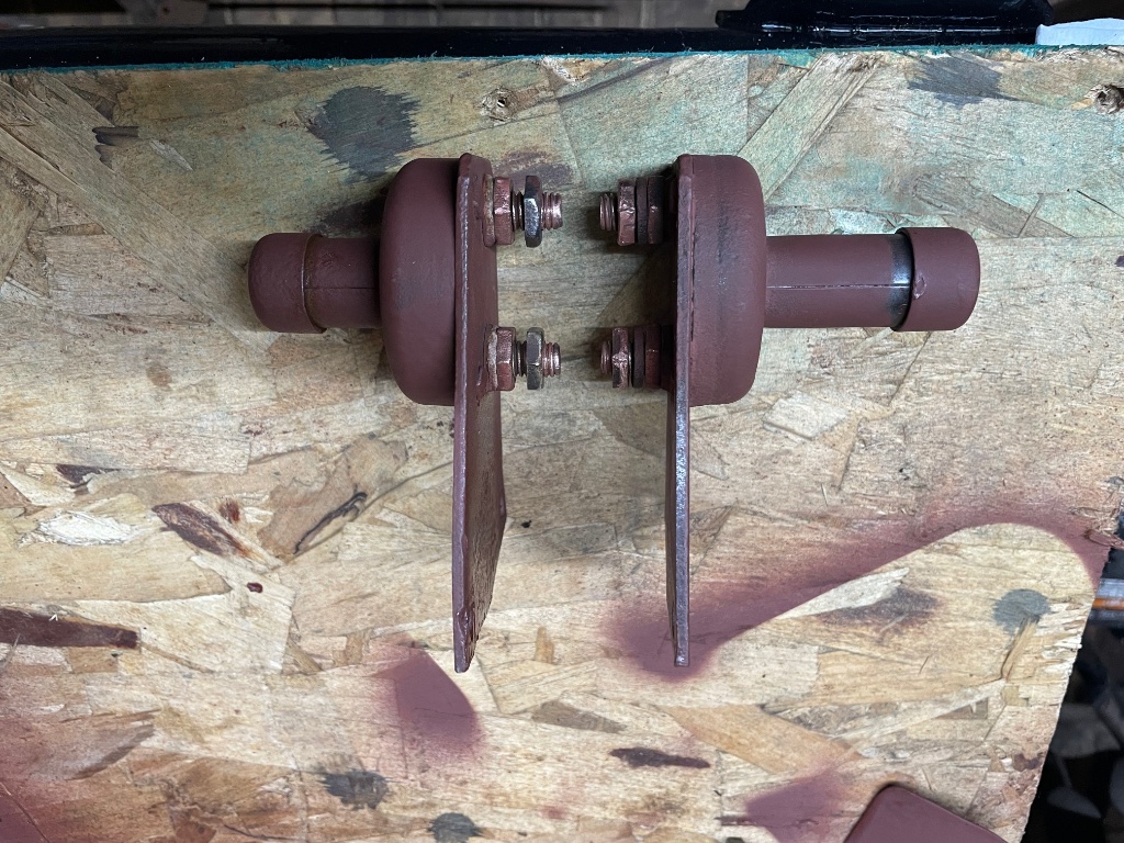

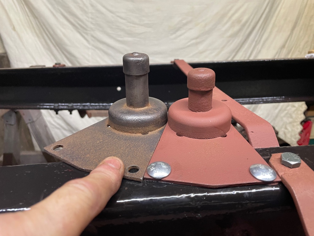

Which height switch would be correct for the TT?

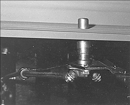

Either one would work with a starter button extension. I have never seen such a short starter button like the one on the right. It looks like it may have been shortened by a previous owner for a reason only known to him. The only type I have ever seen is the longer version on the left, which is like the length of the ones sold by the Model T suppliers which still requires the below pictured extension to allow it to protrude through the floor. Jim Patrick

The correct height is measured by you pressing down on the switch and making contact with a minimal amount of the switch post above the floor board. There is less than a 1/2inch of travel for it to make contact. Two things damage these things, to large a hole for the switch tube and/or to tall a switch tube above the floor board. What these things cause is for the switch tube to be pushed forward loosening the connection to the base. Or making contact with the forward contact and not both inside the housing. The switch is designed to pushed straight down so keep it straight up & down. So using the extension that Jim shows, pick the switch with the least height above the floor.

It is possible that the previous owner shortened the button in order to move the contacts closer together making it more sensitive so that the button didn’t need to travel so far before making contact. Jim Patrick

What I have noticed in issues with starter switches is that usually they are mounted to high above the floor. Once the internal contacts are made there needs to be a way to stop the extension from sliding down further on the switch tube - that's the floor. Close the splits with a worm gear hose clamp

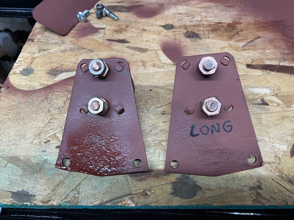

Good info on the starter switch protrusion thru the floor. Ill make a note for assembly. In looking at both switches, it doesn't appear that the short switch has ever been modified. The tabs are untouched. The tabs on the long switch do in fact look like they have been pried up and closed again. Both switches have the same travel of about 3/16”.
TRDx82, I see your contact terminals are open and not enclosed like mine. Is that “normal”?

The picture I posted is just one I have on file, not mine. I gave up on the all the new repro switches. Glad you recognize the protrusion issue, to high and your bending the bracket or something else. Then there is the tendency to stomp even harder on it when the engine doesn't start. Don't mess with the tabs that hold the cover to the plate, they'll brake off.
