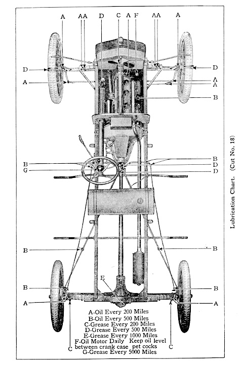

A stock 24 will have cups for grease and flip top oilers for oil. A lot of folks use chainsaw bar oil in the oilers because it will last longer than motor oil. I know one veteran T guy who packs his Ford roller timer with Mobil red grease, and apparently it works for him. I have no experience with that, as I use New Day timers.
Your 1924 owner's manual has this lube chart.

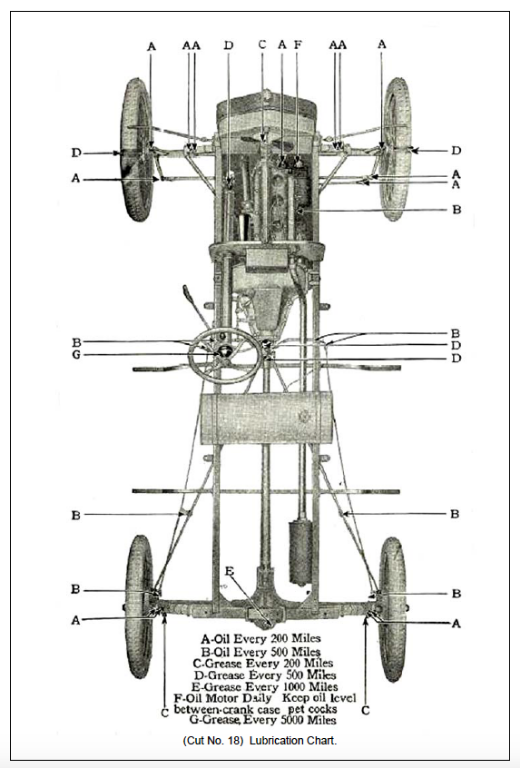

Read this Taking a Model T out of Moth Balls - do it all since you don't know what's been done https://dauntlessgeezer.com/DG93.html
Lube chart
