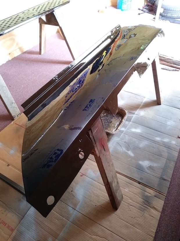

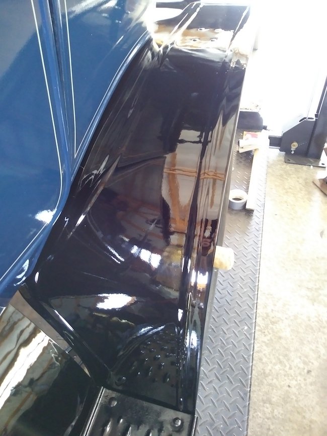

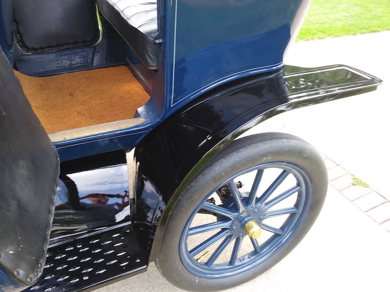

Believe it or not, at least when it comes to fenders, running boards and splash aprons, these little devils do a real
nice job once you get the hang of them. Dilution is the key, little trial and error will get you on the track. Here are pics of
some of the painting I did with this on my former '12 touring. Not sure how easy they would be for the body though, but even the doors would be easy as you can remove them and lay them down flat. I painted half of an F150 pickup box fenders with these! Turned out great. Just a wild thought!!
