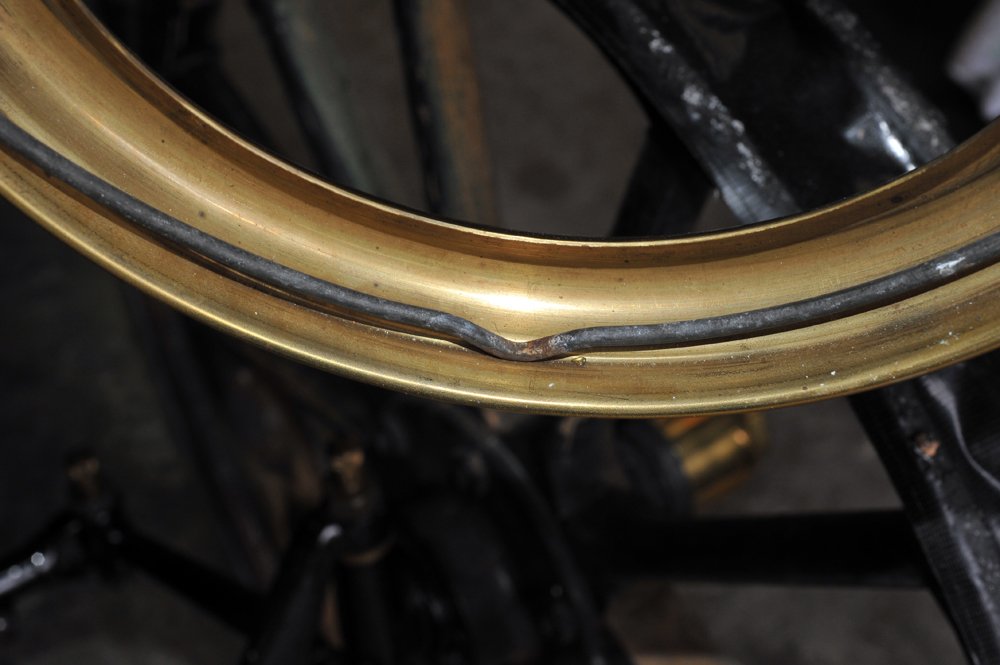

I am about to embark on finishing my 1912 John Brown Model 19 brass headlamps. Since they were apart when I got them I want to be sure I am assembling them correctly. A couple of questions:
1. Is the "wire" retainer as shown in the pictures correct for retaining the headlight lens? I have a few of different design so thought I would ask you folks who know the answer.

No. That wire ‘spring’ is used on the electric 15-27 lens retainer. I’ll try and get out to the barn after the Super Bowl and take a picture of the much heavier cold rolled lens retainer you need.

I respectfully disagree George - that one pictured IS NOT a '15 - '27 retainer.

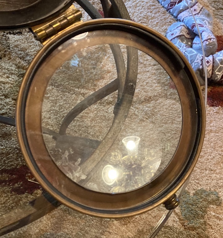

Here is a picture of the steel lens retainer you’ll need. Its about 1/4” diameter and maybe hard to discern on that glass top table. It fits in a groove of the brass rim keeping the glass immovable. Our Forum Friend John Tannehill is an expert on Ford carbide headlamps. Maybe he’ll jump in.

Courtesy of Lang's - the electric retainer spring is quite smaller in diameter than the gas lamps & hooks together - I have a '14 with JNO Brown lamps - most gas lamp lens retainers were exclusive to each brand of lamp.

Thanks for the pictures, George. I am familiar with the wire retainer as I have a 26 Coupe. The picture I included of the retainer in my original post is much heaver construction, more of along the lines of a rod that was bent and formed. That one came out of a Brown Model 19 headlight, although I have no idea if it was original. I also have the type as you show in your picture of the lamp on the glass table so will run with those.

That lens retainer ring you have is for an E&J lamp the JB does not have the indent like that around the circumference but they do at the ends but not the v shape but closer to an S. A narrow gasket (my word) was used as a cushion between the glass and ring. Now days finding the correct thickness of the glass lens is sometimes difficult so some have used a thicker gasket to make up the difference. Steve I know you meant JB model 16’s but accidentally put the brass E&J 666 number, ha do it all the time. Now the early lamps actually had solder floated around the lens & that my friends it an art. Best John
