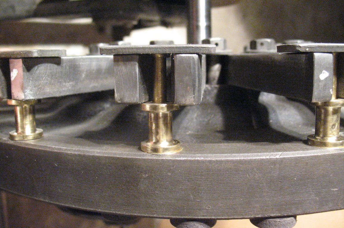

The first thing which affects the clearance of the magneto is the third crankshaft main bearing thrust surfaces. That is the flat area in front and in back of the 3rd main bearing of the crankshaft. You should have minor endplay. The manual says with new bearing endplay should be .006-.007. Servacable .016. Anything more than .016 should be repaired. This can be done by building up the flat surface of the bearing on the front side of the bearing or re-pouring the bearing. If you have excessive endplay, every time you push down the clutch to neutral or low, you will move the crankshaft farther away from the coils and decrease the output of the magneto. However as you drive the flywheel will move back, moving the magnets too close to the coils. So be sure this thrust surface is within clearances before proceeding with the magneto.
The next thing is to be sure all magnets at the outside end are equal or almost equal height. The book says hammering the end with a brass hammer. (not iron). If you are replacing the screws and they have not been staked, it would be better to grind off just a very small amount from the little brass or aluminum spools at the end of the magnet.
Then the final adjustment is the shims under the magneto ring which need to be placed to get the same clearance all the way around and be sure to rotate the crankshaft to be sure it is the same all the way around. Must be between .025 and .040. Ideally all should be at .025 or close to that. However if one or more is not quite exactly same distance from flywheel, you can leave alone as long as the closest is not less than .025 nor the farthest is not more than .040.

You can adjust magnet height by grinding some of the spools shorter as Norm described, or you can raise the short ones with shims. I use shims of .003" and/or .005". I call a gap of .025" to .028" close enough for gummint work.
